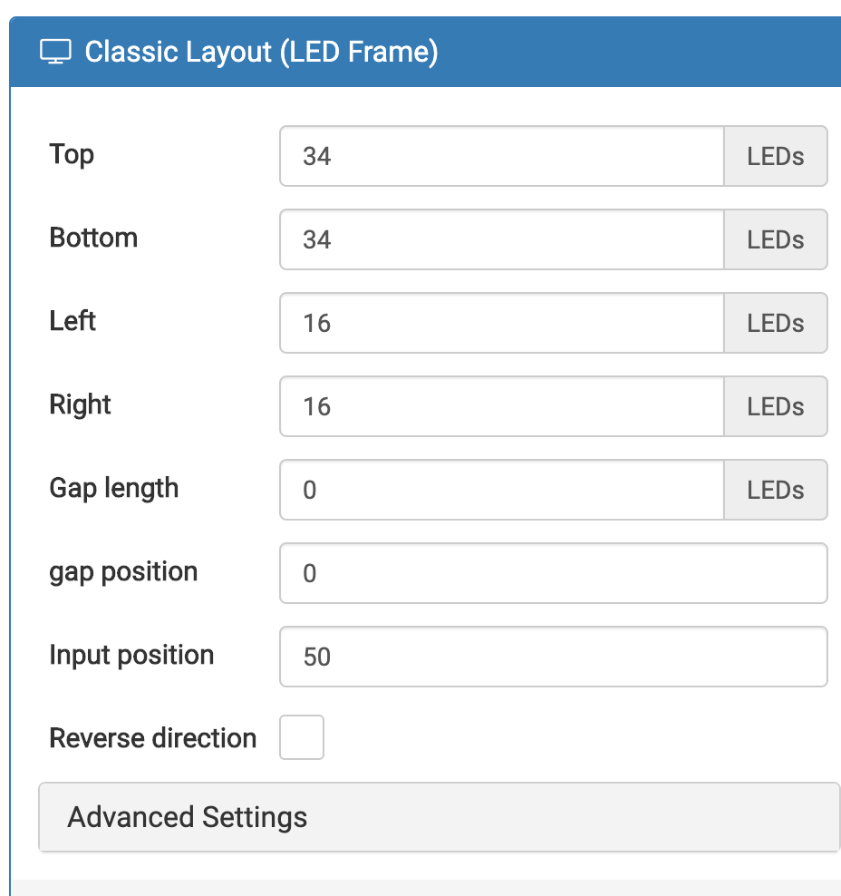

In the attachment I post the Hyperion settings.
