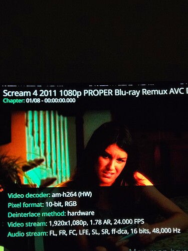

Also I get some white pixels at the top of my screen.
That would be the metadata that is embedded. By default that should be hidden (by a L5 crop) for files that actually have DV.
Is that photo while playing a file that has DV?
Yeah. It’s P7 fel. I’ll try it again tomorrow.
I activate DV by pasting the whole set commands at once from my phone.
I hadn’t yet tested with that. Must not be seeing the metadata. Don’t think it would be hard to make that work in the MEL/P8.1 conversion fashion.
I also tried some other samples and other movies and the white pixels only showed in this I think.
