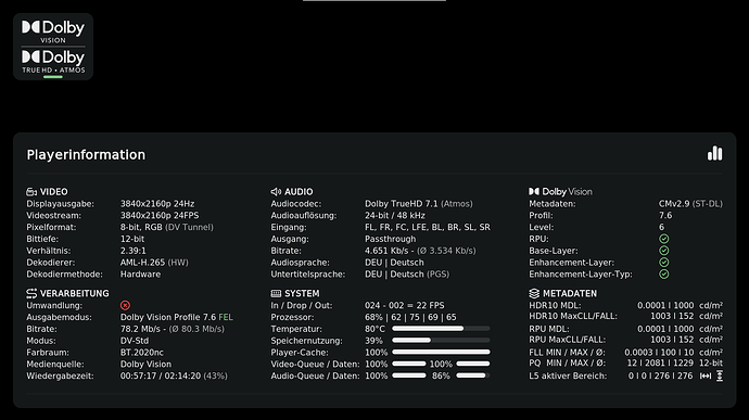

Actually, I have a working test build that covers the decoded half of what you describe. The Amlogic codec reads the RPU from the stream it is already handling, decodes it with libdovi, and publishes the values as Player.Process labels through a new CE label registry, so skins or add-ons like TinyPPI can use them as usual. HDR10+ per frame data could be added the same way later.

I tried out the test build, adapted my TinyPPI to it, and it works perfectly.

So, a new infolabel is added player.process(video.sidedata) which passes through the raw DV and HDR/HDR10+ metadata from the source packets as base64 encoded JSON. On it’s own, you can’t do much with this. So a new module has been added to the CE repo script.module.sidedata which parses the new infolabel and publishes all of the data as fields. Addons can use the module directly as a dependency, or skins can use the fields by using home window properties published by the module. All of the relevant details are included in the addon readme and fields documents.
