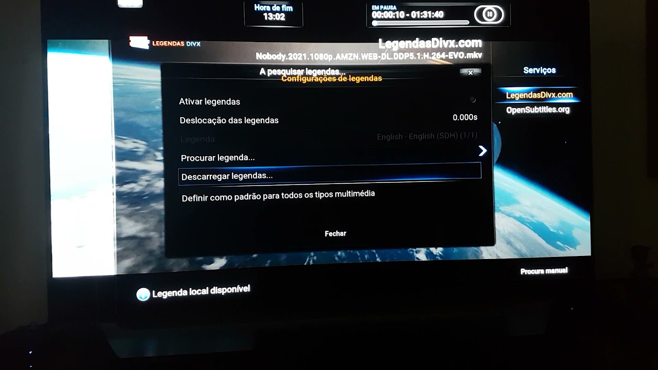

Do you have the option “Pause when searching for subtitles” enabled?
I made a video of what happens when i try to download a subtitle.
Note, before i changed to coreelec i used Libreelec, and this never happened.
Here the link to the video;
One more thing i noticed, when the movie starts you can see on the bottom right, saying processing, that never happened before either.
Thank you.
