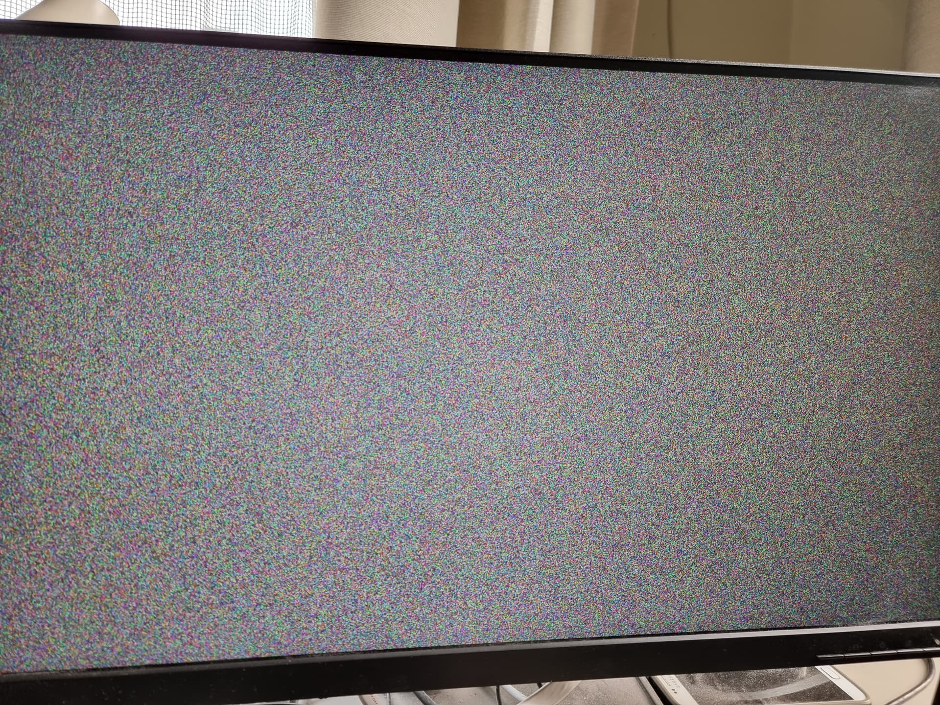

My Minix Neo U22-XJ boots into a white noise screen (static) with CoreELEC-Amlogic-no.aarch64-22.0-Piers_nightly_20250526-Generic.img.gz and using g12b_s922x_minix_u22xj.dtb.
I’ve tried two sd-cards.
I copied g12b_s922x_minix_u22xj.dtb from CoreELEC-Amlogic-no.aarch64-22.0-Piers_nightly_20241220\3rdparty\bootloader\device_trees into root of the original CoreELEC-Amlogic-no.aarch64-22.0-Piers_nightly_20250526-Generic.img.gz image sd-card - and it booted!
In detail, the Minix splash screen showed, then the familiar white noise screen briefly, then the Corelec ‘New Order’ logo with the partition resizing progress txt, then it rebooted again, and the setup process started.
A suggestion was to use the revA dtb but the only ‘rev_a’ I could see in devicetree of CoreELEC-Amlogic-no.aarch64-22.0-Piers_nightly_20250526-Generic.img was g12b_s922x_minix_u22xj_max_rev_a.dtb and mine is not the Max model.
My MINIX Neo U22-XJ downloaded the latest nightly (20250607), overwrote dtb.img with the its g12b_s922x_minix_u22xj.dtb and of course I got the static screen of death, so obvs it’s not yet fixed.
Is there anywhere else that I should be logging this, given this box is on the supported list at coreelec:minix [CoreELEC Wiki]? As before, if someone can advise how I can obtain useful debugging info, bearing in mind the SSOD appears before the CE logo, then I’ll do my best.

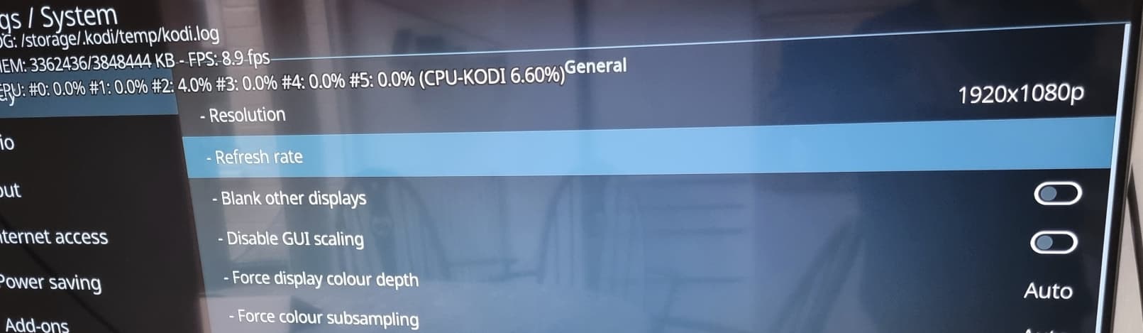

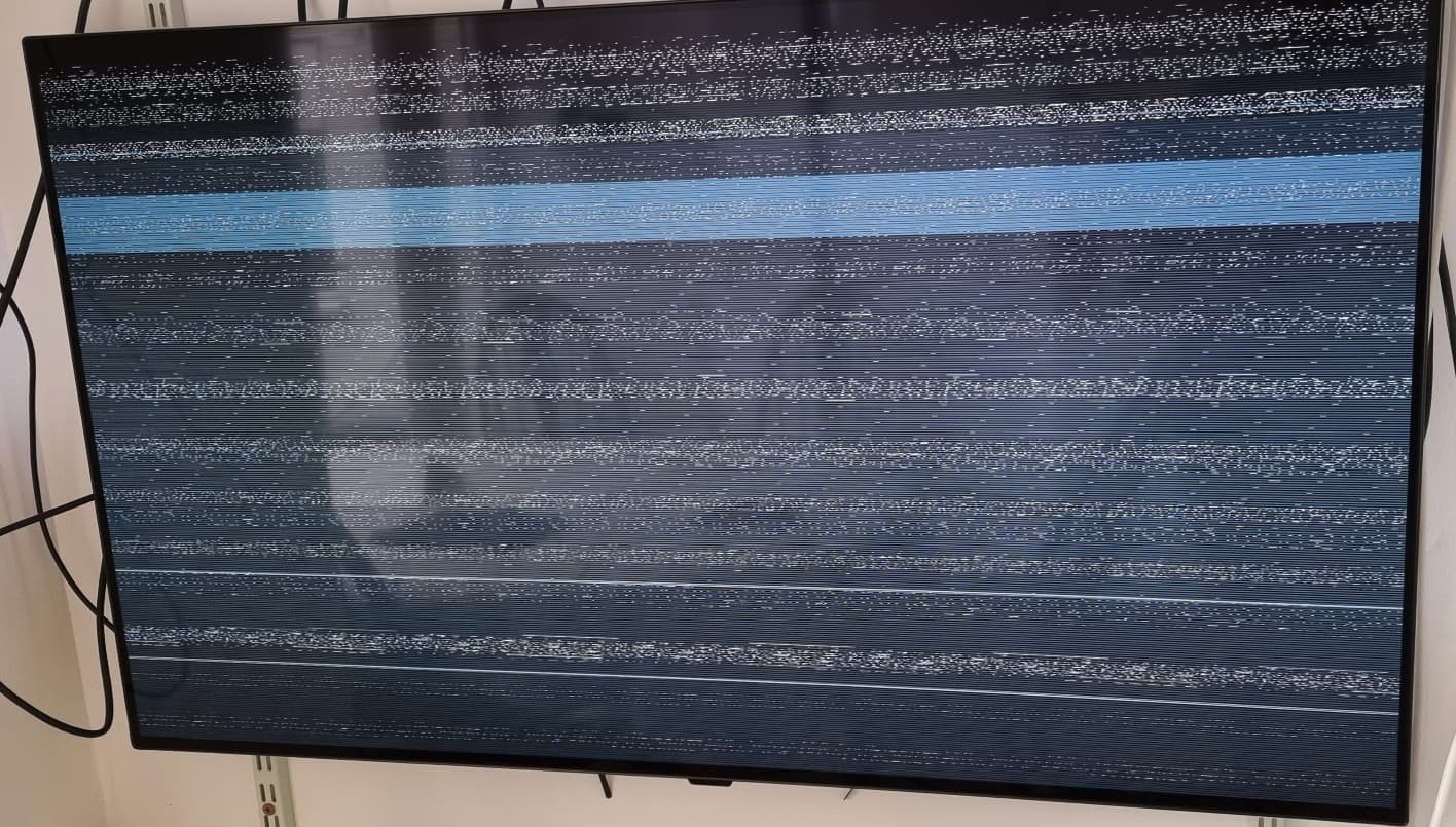

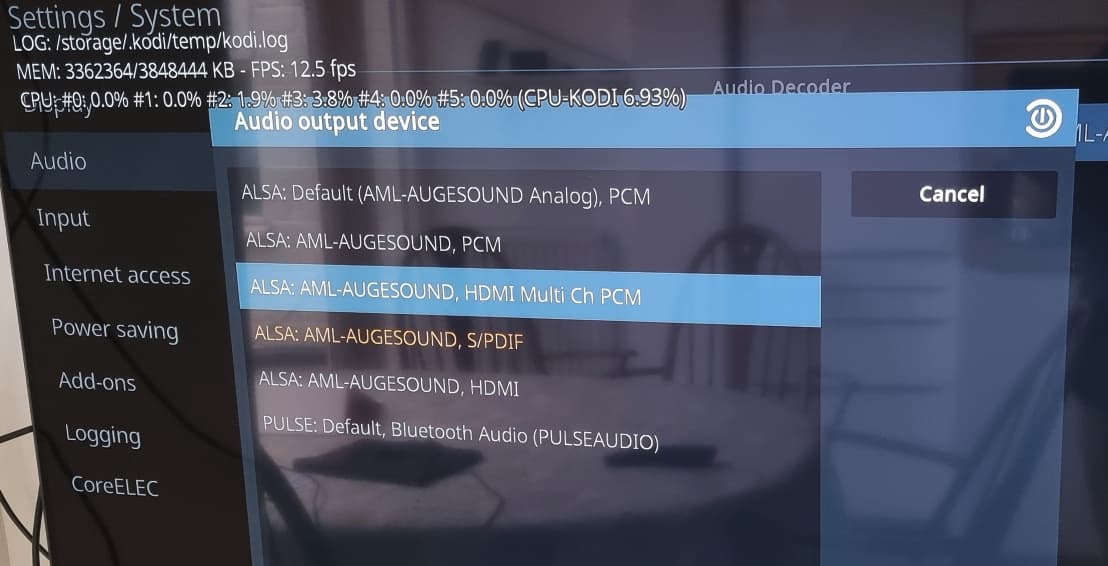

But it has these issues:
  • switching from 1080p to 4k results in messed up display
  • no audio output with SPDIF or either of the HDMI settings
  • the refresh rate value disappears in the UI
The above works fine with CE21.2.

Only as experiment try change this VOUT mode (with delete of “#”) in config.ini to and use newer dtb: In my case this test not helped me with short time noise.
vout=‘1080p60hz’
I tried this but no change was observed i.e. a still static noise screen on boot.
I also tried out a separate 4k monitor with the same results.
