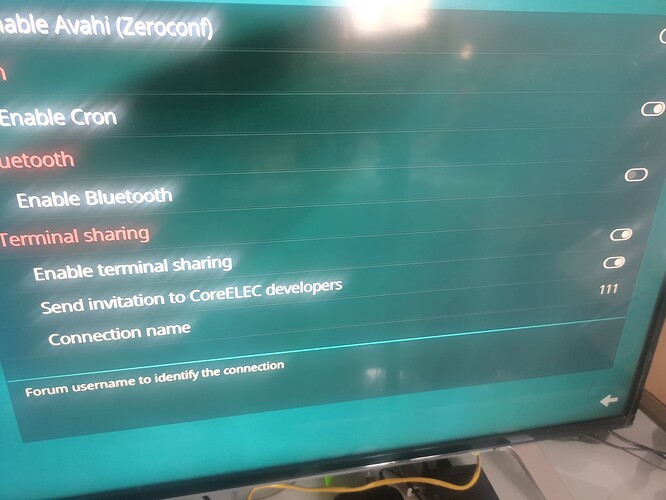

I’ve already turned on remote
I don’t see anything in my dashboard. Did you set Send invitation code to CoreELEC developers ?
I have enabled remote, just restarted, because I can not log in ssh, now you can try, thank you.

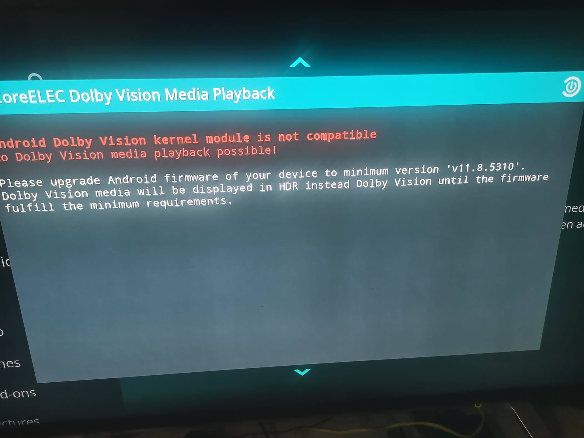

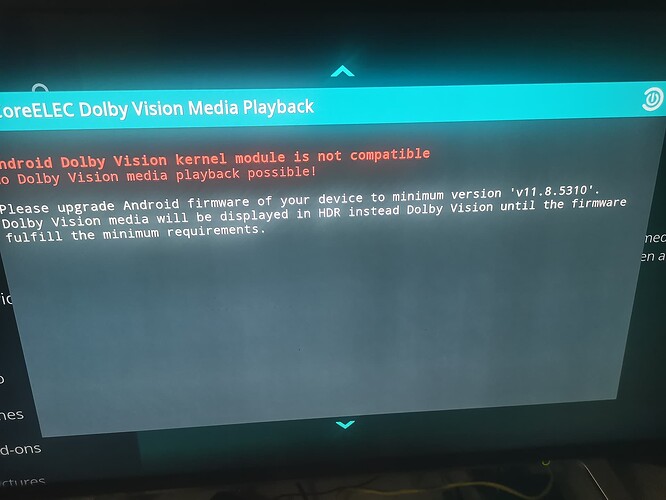

Media playback should be fine now because TEE stuff succeed.
But there is no DV because the kernel module from Android is not compatible with our linux kernel (kernel on Android is too old - 5.4.61 and we are using 5.4.210).

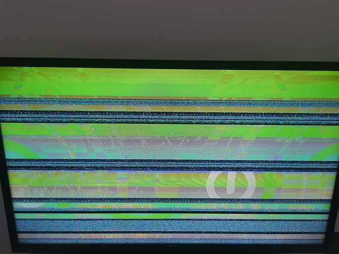

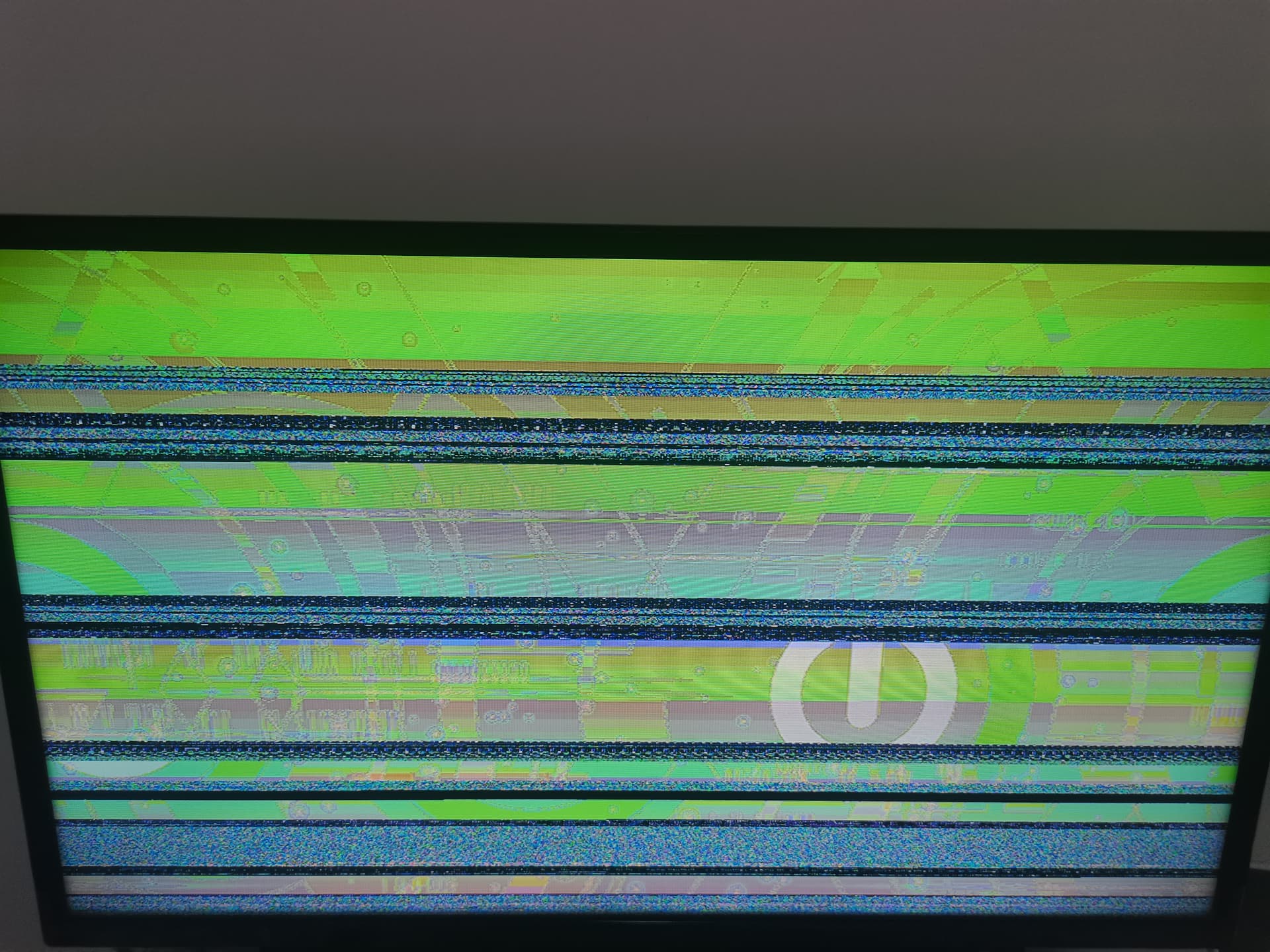

Hello, why I opened the device on 1080p to run coreelec flower screen phenomenon, may I ask whether this can be solved!
What is your TV? Can you try different one?
Toshiba’s small TV 1080p, the other is I tested earlier, Toshiba 4k TV, yes, 1080p TV flower screen is normal phenomenon, right? Thank you coreelec team. I hope 1080p does not spend the screen is the best, by the way, I plan to contact the other side to let them upgrade the kernel version, to achieve compatibility, thank you.
Hello, @vpeter ,I have contacted the after-sales customer service feedback, the customer service has feedbacks my needs to the technical department to deal with, so that they upgrade the kernel to 5.4.210, I update to the latest version, contact you, turn on the dv, thank you again coreelec team, happy test.
