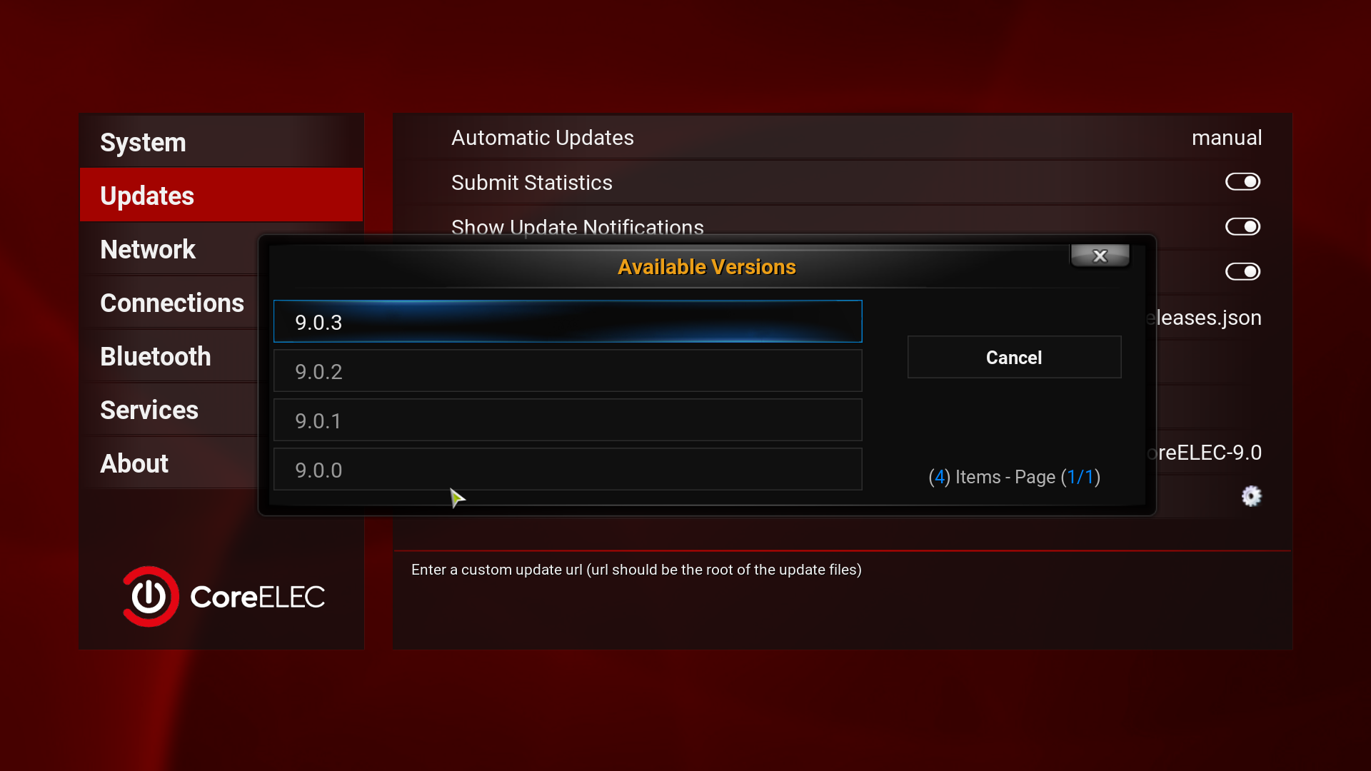

What automatic downloading? All automated downloads only offer 9.0.0 - 9.0.3 - or am I missing something?
You are in the nightly topic. ![]()
At a guess, I would say that HeresJohnny might not have the updates channel set for nightlies, or that when it is set and you choose to see the latest updates, you appear to get the stable builds listed.
Exactly! So those versions shown are not the versions downloaded automatically? I seem to remember that this happened to someone in this very thread… CE notifying that an update was available and then installing stable instead of nightly.
If I boot my box after there is a new update available, then I get the prompt to download it, which does download the latest nightly.
Same here.
If I set up my Box with a nightly it always notifies of a new nightly.
If I set one up with a release it notifies me of a release.

Think i have the same problem as @compent stated. Ive added the custom nightly channel shown but all i see when doing a manual update on my n2 is 9.0.3.
Ive just dowloaded and copied it over to the n2 and it upgraded successfully, but it would be fantastic if i could do it directly from the coreelec UI.
It’s a drop in update.
You might get away with it but if you have a lot of addons there is a high probability it will fail as an update. If it does a fresh install will be necessary with all the addons reinstalled manually.
