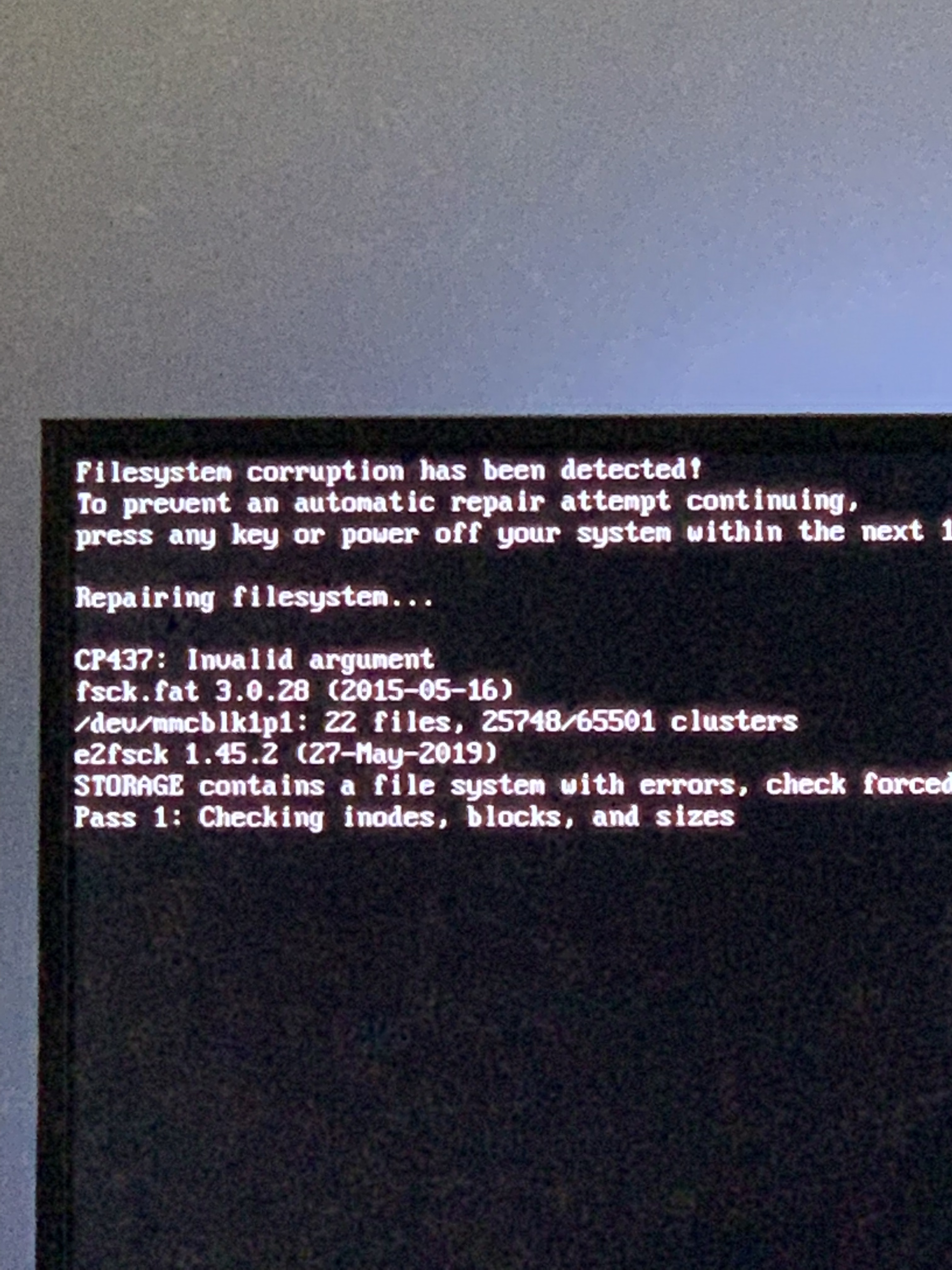

After it attempting to restore it rebooted to a black screen screen for awhile again and now itās stuck on this screen
Iām not sure whatās happened to it I had CE installed to emmc and itās worked perfectly for ages the only thing Iāve done different lately is I used the script as recommended to update from 09/11 to 09/12 and it was working untill todayās update. I thought it could be something to do with the sd cards Iāve been using even though they have worked fine in the past but when I used installtoemmc it now says itās only for N2?
