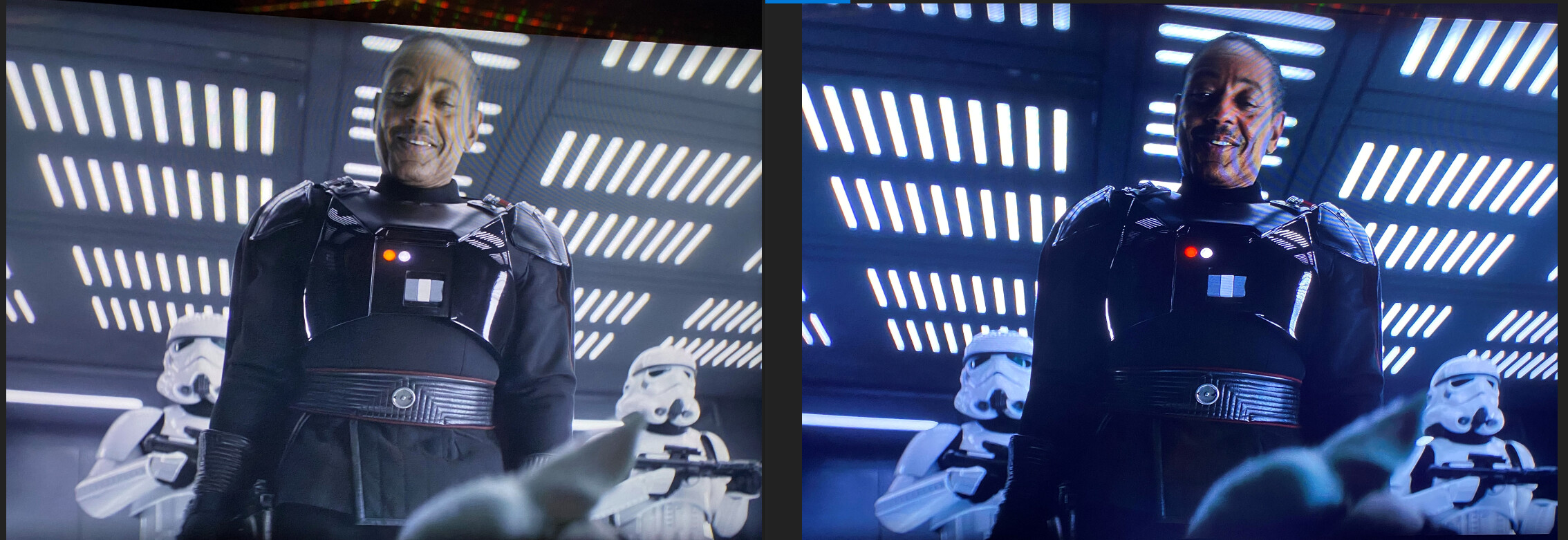

Below is how it looks with the best HDR settings (right) I was able to achieve on the TV and N2+.
And with Odroid C2 (no HDR support) left.
Maybe HDR has more contrast, but HUIGE amount of details are lost, you just can’t see them on HDR.
And this is the top class TV from samsung, I can’t imagine how it is with the lower end TVs that claim they have HDR.
Would be great if there is an option to just block the HDR information on the stream (pure disable HDR) so everyone can decide for himself.
I’ve also tried the HDR to SDR mapping (reboot required), not sure if it works or what it is supposed to do but the TV still recognizes the signal as HDR and comparing C2 and N2+ there are picture details lost.

Here for example,
if we pause at 3:34, and compare the 2 pictures, we can see how much details samsung is missing(because of HDR),
look at the actress clothes for example and find the differences, or look at the ceramics colors etc.etc.
The results are identical with what I get, with/without HDR.
So, something is very wrong with HDR, or kodi, or samsung or something else.
