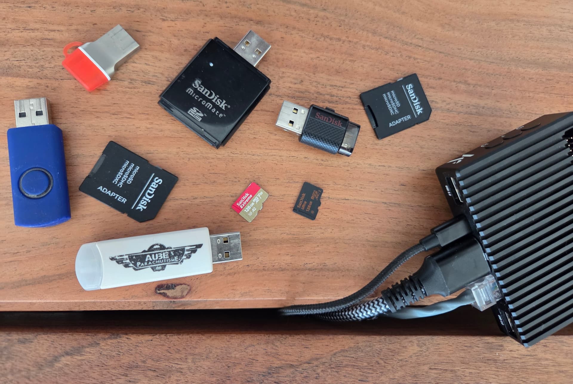

I tried booting “CoreELEC-Amlogic-no.aarch64-22.0-Piers_nightly_20250406-Khadas_VIM4.img” via USB, but the screen remains frozen on Khadas. However with NG/NE images it works fine via USB. Strange
However, is there a reason why CE-NO isn’t appearing on Oowow?
Looks like a error in VIM4/VIM1S bootloader.
May Sandisk 3.2 does not work, VIM4 reboot.
Sandisk 3.0 does work without issues.
Use uSD or eMMC or older USB memory and try again.

I’ve tried everything I have at hand, nothing works.

In the meantime, I’ll try other storage media… @Portisch Can you give me the exact reference of the micro SD that works for you, please?

Try with some cheap 16GB uSD card.

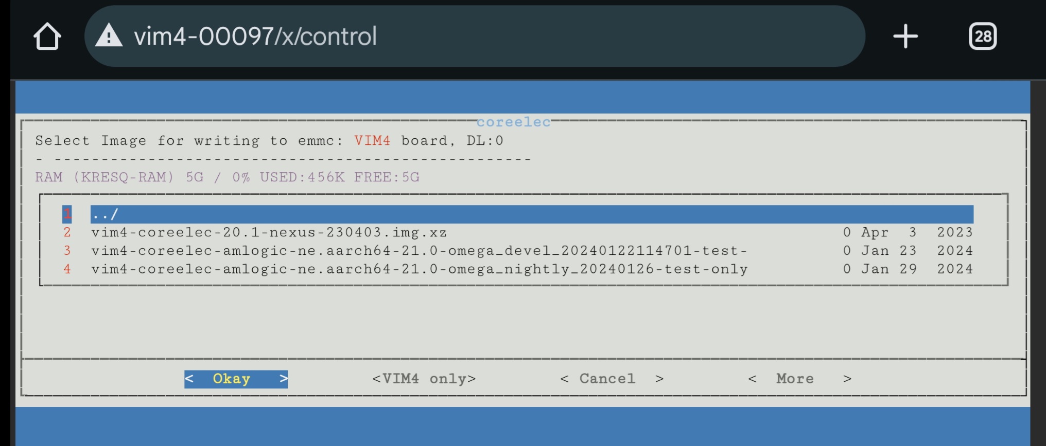

There is also option to write custom image over network to eMMC when oowow runs. I can find instructions tomorrow. But this erases everything you currently have on eMMC.
I’ll try this one. If it doesn’t work, then I’ll give up and patiently wait for the stable version of CE-22.
Thanks again for everything.
I confirm that unfortunately it doesn’t work with this card either. So I give up. Thanks anyway.
