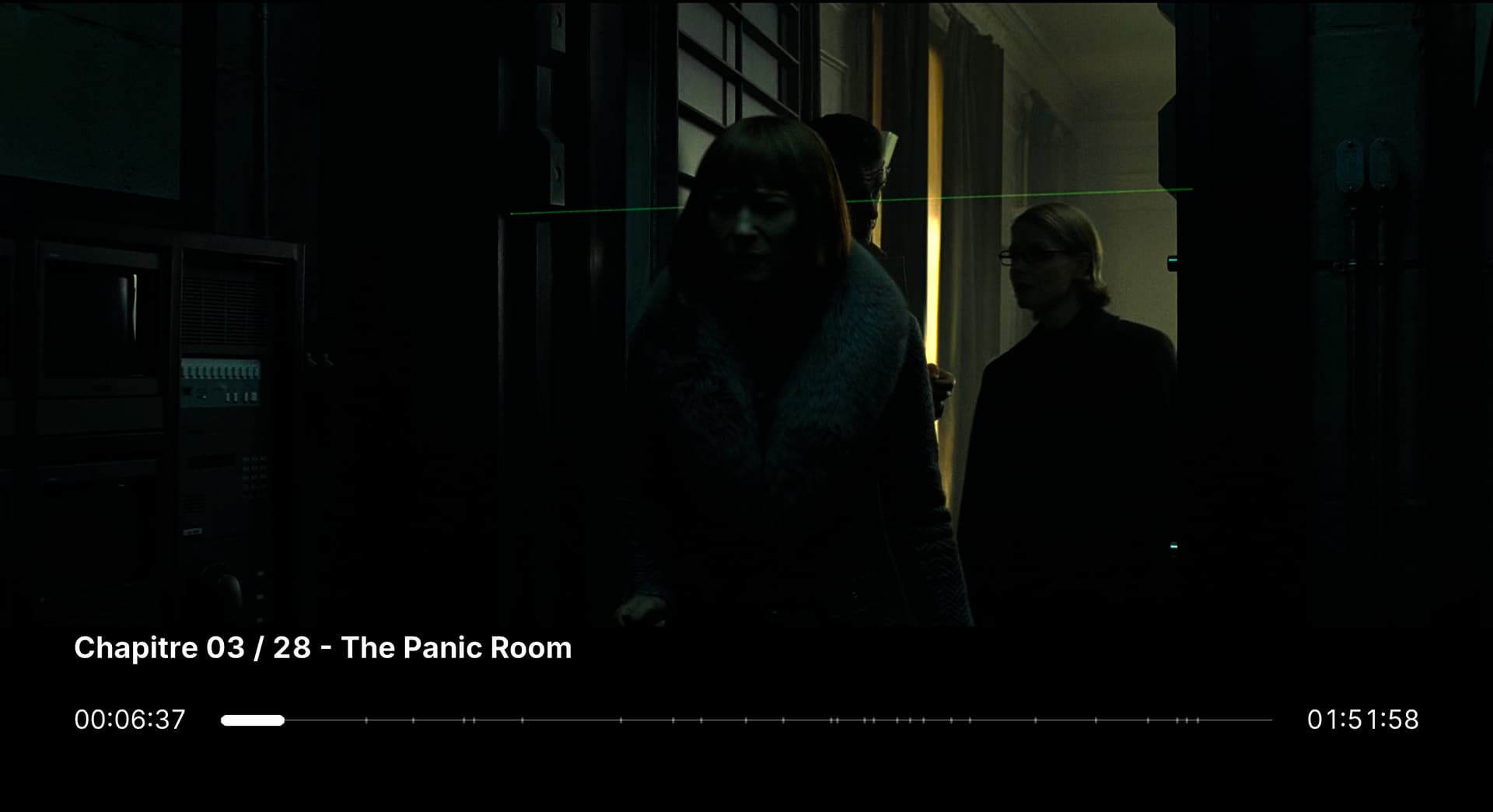

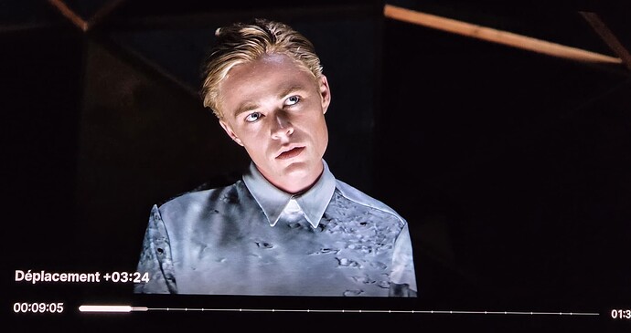

I have a problem with the video OSD that seems inherent to CoreElec. Indeed, when we use the Fuse 2 Skin on the PC or Android version of Kodi, the name of the chapters is displayed perfectly when we skip forward with the “Next Chapter or Big Step Forward” shortcut, as you can see here :

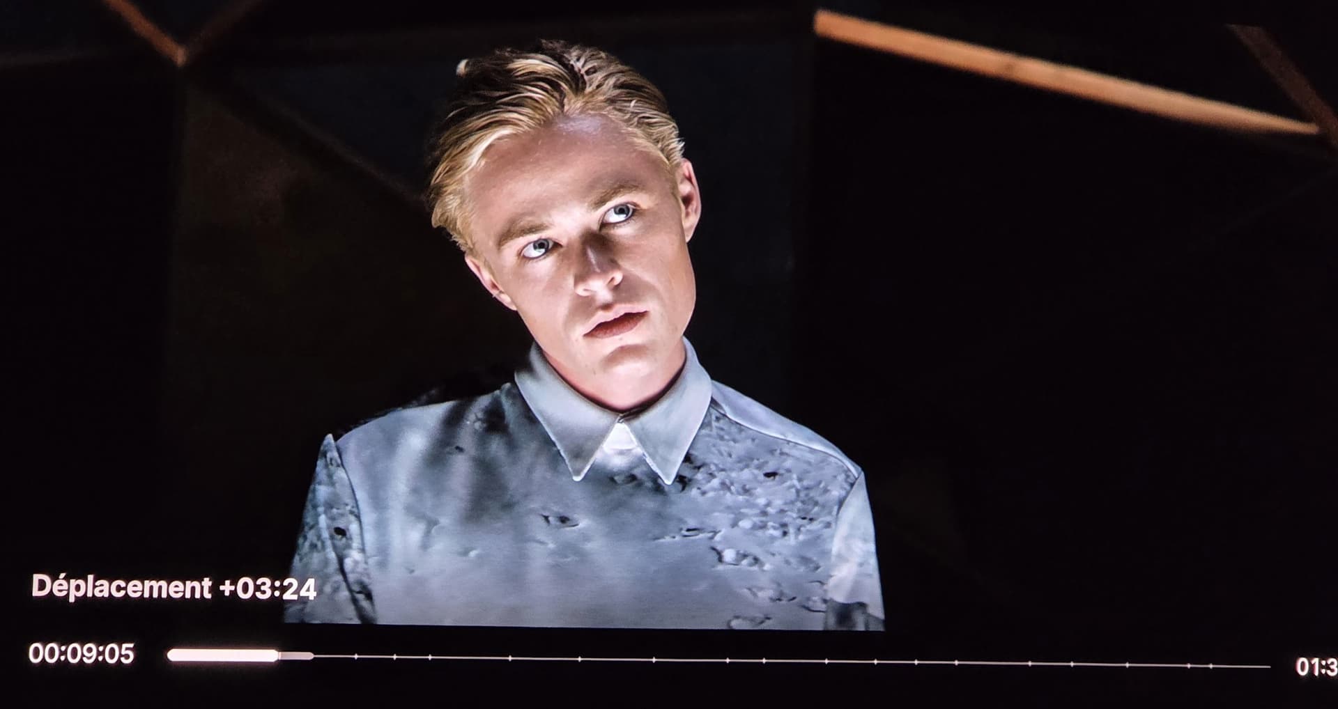

which is not the case with Kodi CE where only the fast forward time information “+06:17” is displayed.
According to Jurial, the creator of the Skin: “Not a skin issue. Player.SeekOffset value should be empty when skipping chapters as this is a skip function, not a seek function. There is nothing the skin can do about this if it is incorrectly set.” Problem displaying chapters on Kodi CE. · Issue #608 · jurialmunkey/skin.arctic.fuse.2 · GitHub

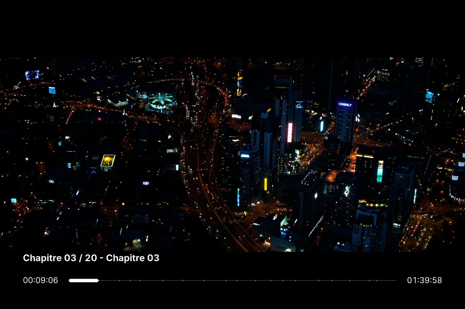

This is working:
What I don’t understand is that it works on all platforms, but not on CoreElec.
This is one strange skin at least for me. Presssing key i and then up button and nothing happen. How to even check it if even basic things doesn’t work as on regular skin.
When I press “i”, it displays the information correctly for me:

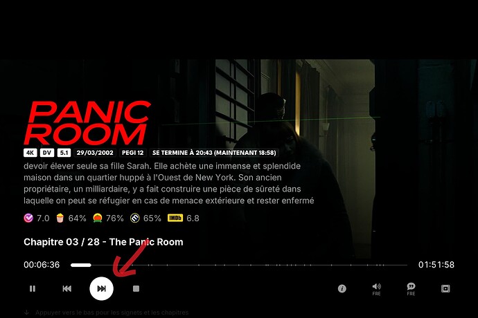

On PC, when you move forward with the “Next Chapter or Big Leap Forward” shortcut (in the OSD Video), the chapter names are displayed perfectly, as you can see here:
This is not the case on CoreElec. The skin developer, Jurial, says that Player.SeekOffset is empty.

(The shortcut to move from one chapter to another is by default the up arrow on PC. And when you press the up arrow, the chapter number and name should appear.)
PC
CE
“The problem is that on CoreELEC, the seekoffset is set when searching by chapter, while on Windows and Android it is not set, resulting in inconsistency between platforms.”

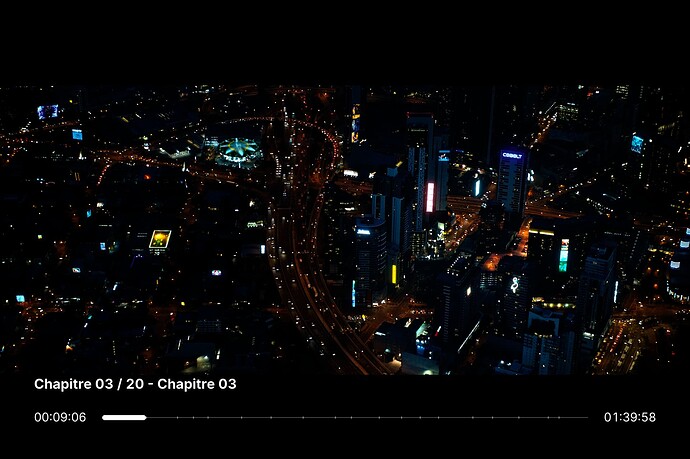

Sample with integrated chapters :
PC →
