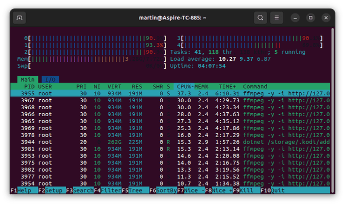

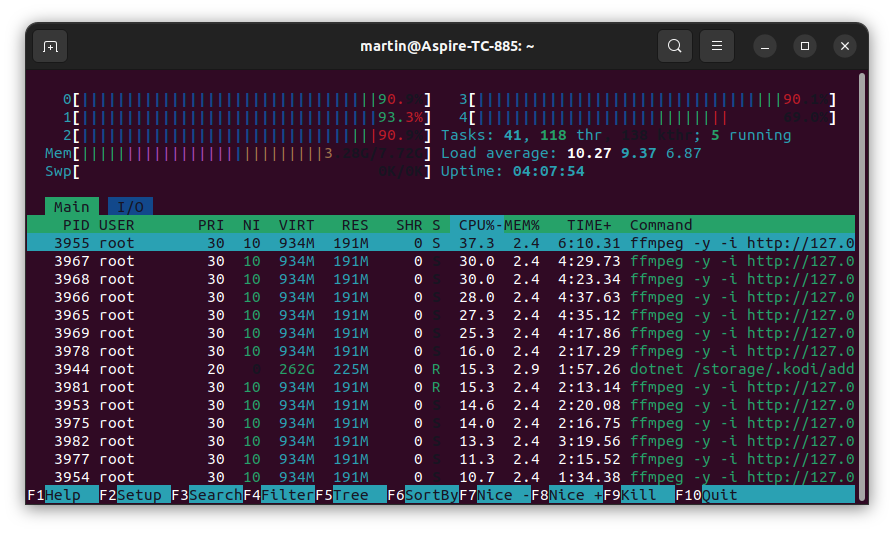

In any case using the newest ffmpeg transcode 1080i MPEG2 to h264 in real time for the browser is doable, with just enough CPU and not too bad 52C while streamin.
Just had a chance to try the S905X5M and it can transcode in 1x too. With ultrafast it is even lower CPU then what I showed for the S928.
