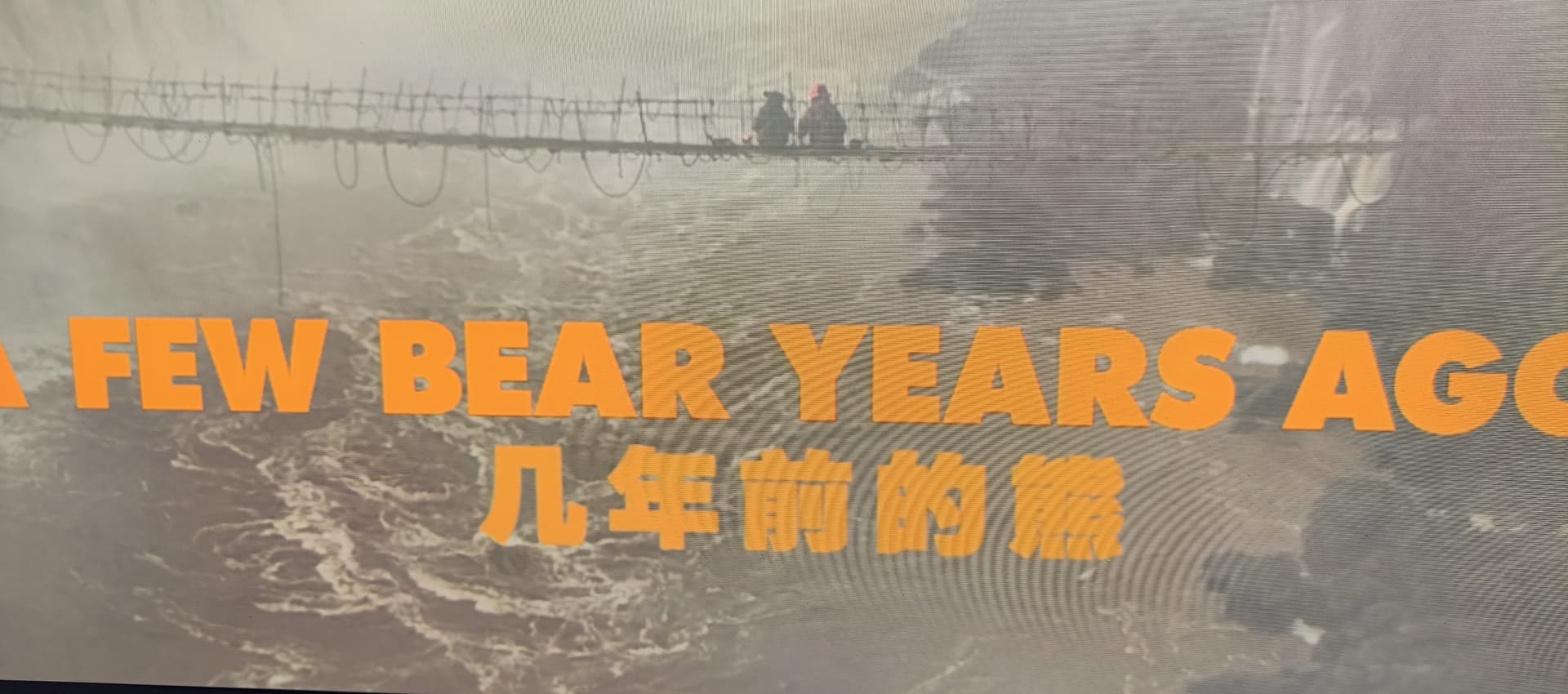

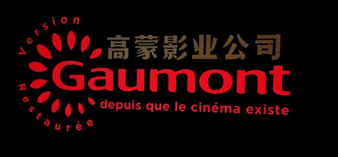

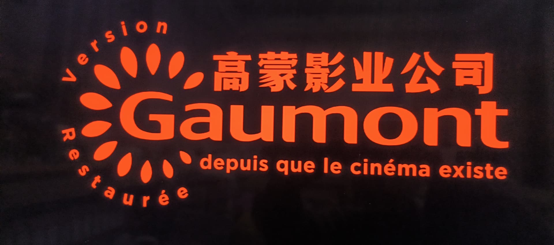

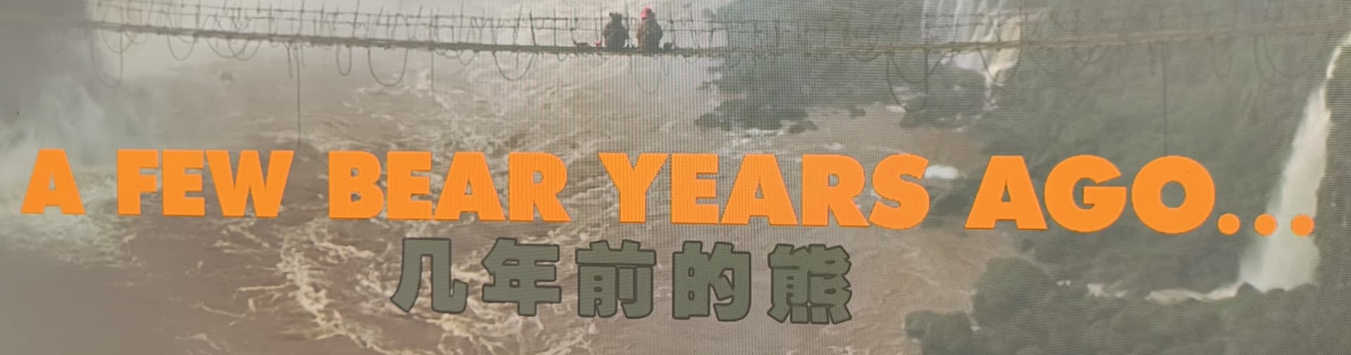

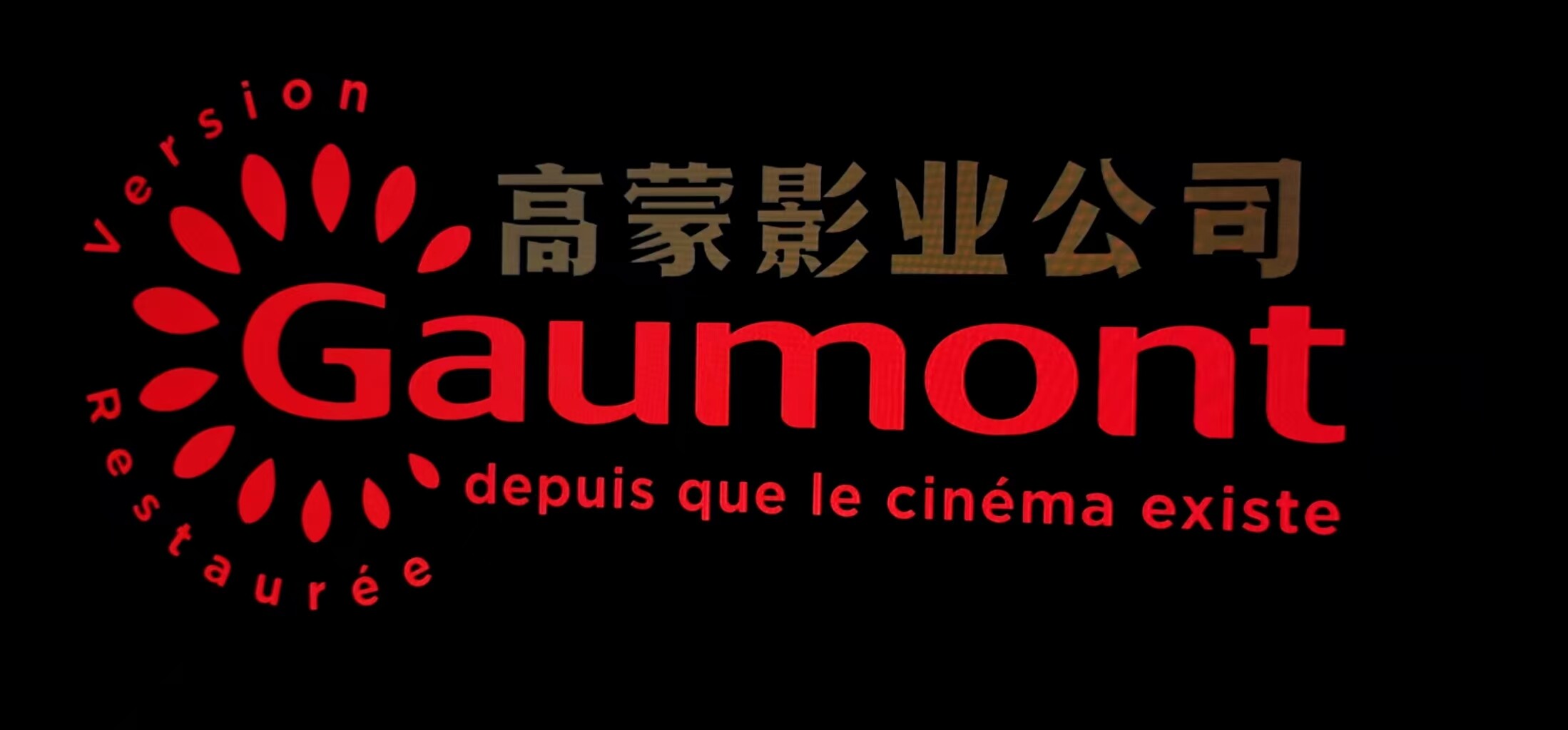

Please ignore the color deviation of the mobile phone photo, and carefully look at the color of the Chinese and English subtitles in the picture, you can know that the subtitle color is wrong
Android Kodi 21.2/22 /Coreelec-no 22/Coreelec-ng 21.2 subtitles are wrong colors
Windows Kodi 21.2/22 /MPV/Potplayer subtitles are correct
Test sample with subtitles
It may be related to whether the subtitles are displayed in the BT2020 color space

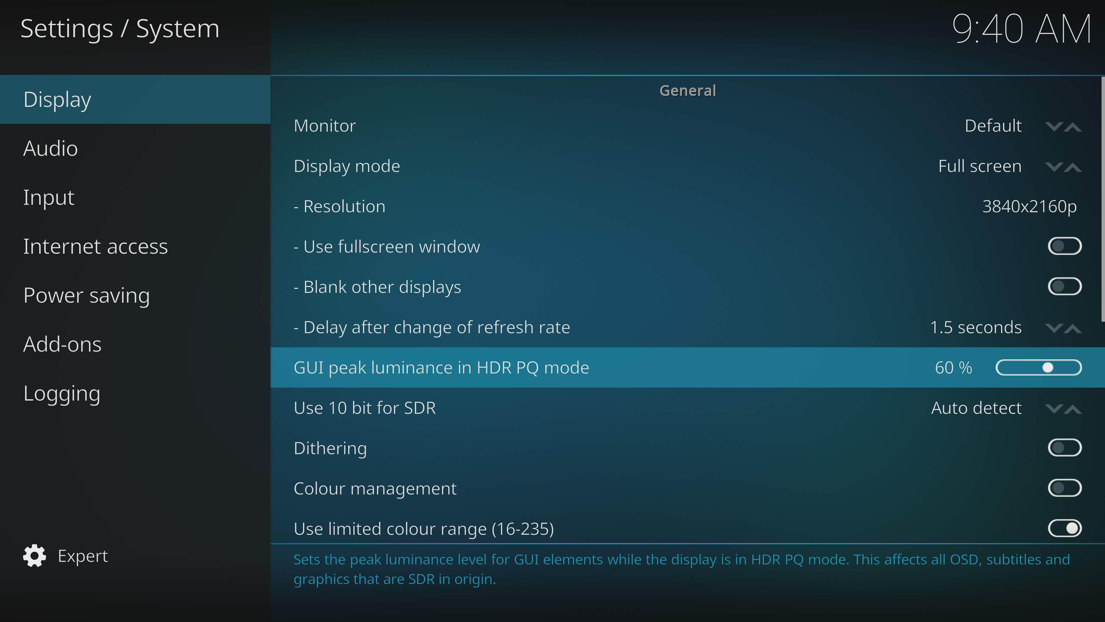

opened 08:18AM - 04 Oct 22 UTC
## Description
Adds new setting to set the GUI peak luminance when the display … is in HDR PQ mode
## Motivation and context
This is a follow-up of https://github.com/xbmc/xbmc/pull/18984
While a fixed value of 100 nits should be mathematically correct, there are several reasons to prefer adjust it: different user preferences, perception that the OSD is less bright in HDR than SDR (compared to video), HDR subtitles too bright, differences in the TVs settings, etc.
Default value of 60% it is slightly brighter than before and can be adjusted from slightly less bright than before (0%) to much brighter than before (100%).
Changes can be seen in real time by tapping on the setting while HDR playback is on.
