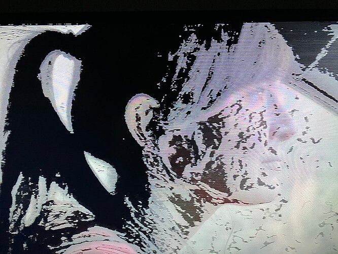

Hey guys, I just got a HK1 S905X4 today. Loaded CoreELEC on a SD card and it booted right up.
Everything is working fine except for live TV via HDHomerun. I have to turn off “Accelerate MPEG2” in settings for that to go away.
Please look at pics.
Interesting. Which PVR app are you using? I have never experienced that situation.
I tried both the HDHomerun Client from Zoltan and Zuki’s. It only happens on the ng Kernel. It runs fine on the ne Kernel.
