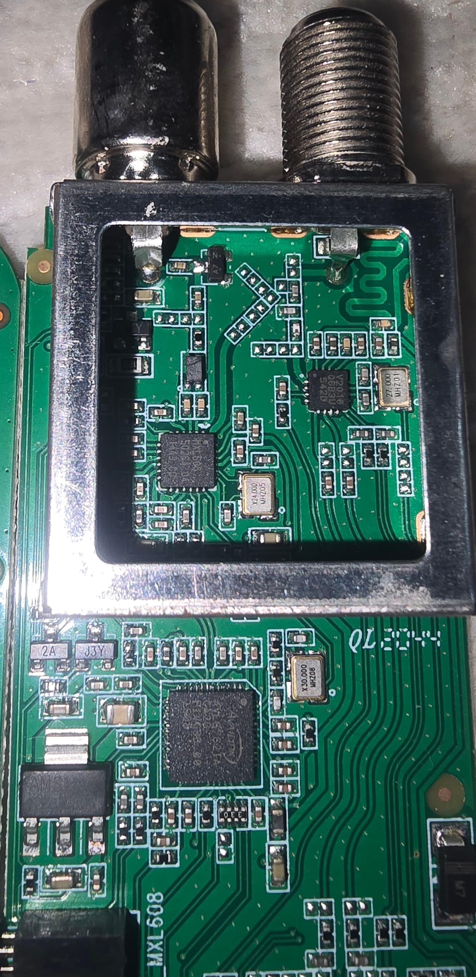

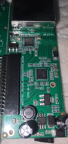

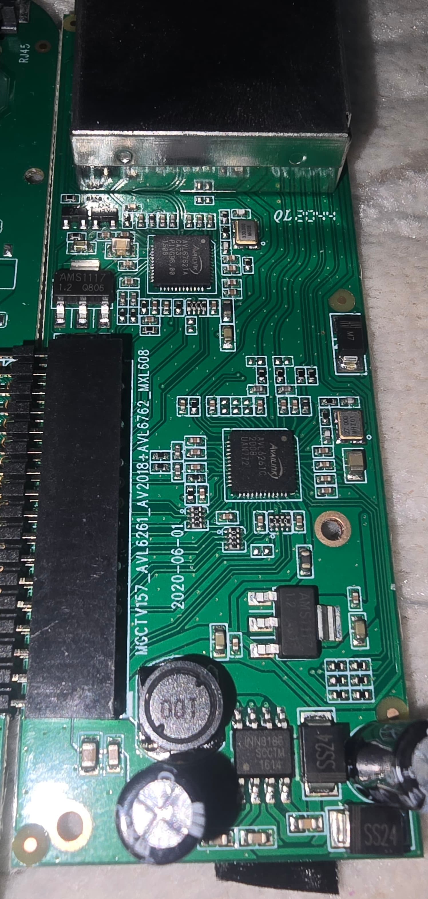

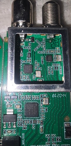

I don’t have a computer with Ubuntu installed. However, I converted the Android DTB to DTS on CoreELEC via Entware with uarth ssh android phone. The tuner and demodulator on my device are MxL608+AVL6762 (DVB-T/T2) and AV2018+AVL6261C (DVB-S2X/S2/S).
The driver for AVL6261 is:
https://github.com/availink/amlogic_meson_dvb4linux/blob/master/dvb-avl/aml_fe_avl62x1_av201x.c
https://github.com/availink/amlogic_meson_dvb4linux/blob/master/dvb-avl/aml_fe_avl62x1_av201x.h
Its firmware is here:
Also, there is a source for Broadcom processors:
Additionally, the MxL608+AVL6762 is used by the Mecool KT1, and as far as I understand, it is currently patched into the CoreELEC Amlogic DVB addon and loaded into the main driver.

Ts0 avl6262
Ts1 avl6261c
nice pictures :slight_smile:
How do You know avl6762 is on ts0 ?
There is also no information in dts which i2c bus is used for which demod. I assumed that i2c2 is for avl6762 and i2c3 is foavl6261c.
