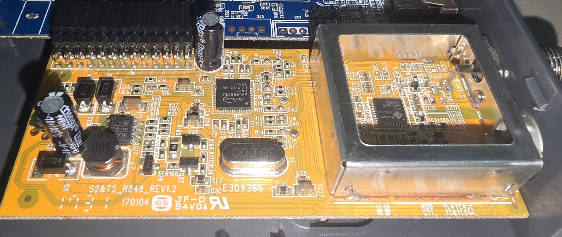

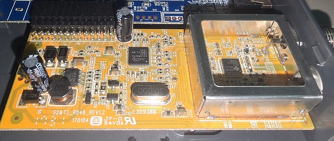

My old k1 pro tuner photo. Works well with Coreelec kernel 3.14
May be help

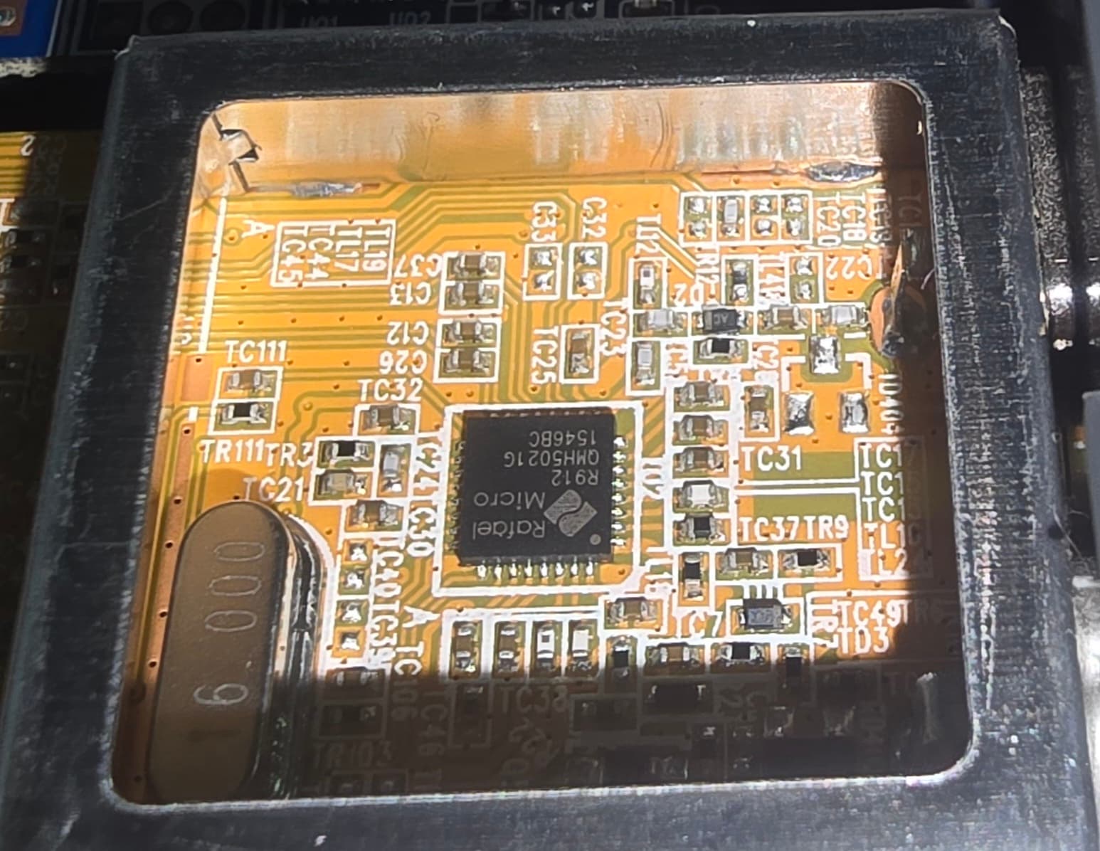

KI PRO has r912, which is supported in CE …
I found r848 driver here: GitHub - tbsdtv/linux_media: TBS linux open source drivers, I have no idea if it will work, but worth trying. I added it to AVL6862 addon, install it:

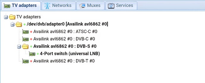

The mecool K5 Coreelec TVheadend found all DVB-C channels. It streamed VLC with TVheadend. There’s no problem with the DVB-C section. I’m receiving a DVB-C signal with the switchboard distributor. TVheadend returns a scan no data error for DVB-S/S2 transponders. The adapter appears correct in TVheadend, and I’m searching for active TPs, but the results remain the same. The satellite signal isn’t coming directly. Since it needs to be selected via the DISEQ signal, if the DISEQ signal isn’t being sent correctly in the software, the switchboard may be reporting no signal because Port AB isn’t opening. Or, the R848 tuner may be misreading the software DVB-S I2C connection. I’ll do more testing.

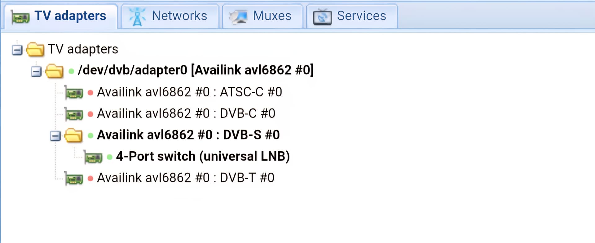

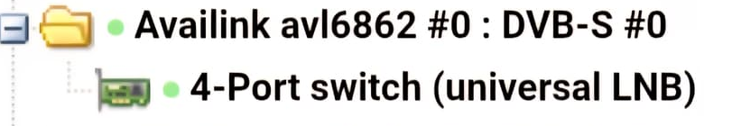

The DVB section of the Mecool K5 is now working. I manually added a DVB-S2 TP whose signal I knew, and it detected all TPs with a nit scan. TVheadend sent and broadcast the 4K TV channel via Ethernet to TVHClient without any problems. In short, DVB-S/S2 works. Of course, DVB-C also works perfectly.

[    2.133295] dvb power gpio invalid
[    2.133427] aml_dvb_extern_init: OK, version: V1.28
[   43.686584] probe amlogic dvb driver [V2.02]
[   43.686773] aml_dvb_get_adapter need register adapter first.
[   43.686777] DVB: registering new adapter (amlogic-dvb)
[   43.699840] DVB: Set DMX0 TS_RECORDER_ENABLE to 0
[   43.699847] DVB: Set DMX1 TS_RECORDER_ENABLE to 0
[   43.699850] DVB: Set DMX2 TS_RECORDER_ENABLE to 0
[   43.699852] DVB: reset ASYNC FIFOs
[   43.700035] DVB: Set DMX0 TS_RECORDER_ENABLE to 0
[   43.700039] DVB: Set DMX1 TS_RECORDER_ENABLE to 0
[   43.700042] DVB: Set DMX2 TS_RECORDER_ENABLE to 0
[   43.700044] DVB: reset ASYNC FIFOs
[   43.700049] DVB:dmx_reset_dmx_hw_ex_unlock into
[   43.700089] DVB: demux0 smallsec buf disable
[   43.700093] DVB: demux0 timeout disable
[   43.700096] DVB: demux0 timeout enable:timeout(9000),ch(0xfffffff8),match(1)
[   43.700141] DVB: demux0 smallsec buf disable
[   43.700144] DVB: demux0 timeout disable
[   43.700146] DVB: demux0 timeout enable:timeout(9000),ch(0xfffffff8),match(1)
[   44.161098] i2c i2c-3: dvb_meson: found AVL6862 family_id=0x68624955
[   44.161115] i2c i2c-3: Load avl6862 firmware patch for DVB-S/S2 size=44108
[   46.389546] i2c i2c-3: dvb_meson: Rafael R848 successfully attached
[   46.389567] Demod: adapter null, call aml_dvb_get_adapter
[   46.389577] amlogic-dvb-demux dvb-demux: DVB: registering adapter 0 frontend 0 (Availink avl6862)...
[   46.394228] aml_dvb_extern_attach_work demod 0 attach done
[   46.396283] aml_dvb_extern_attach_work demod 0 attach done
[   46.954332] amlogic-dvb-demux dvb-demux: DVB: adapter 0 frontend 0 frequency 0 out of range (175000000..2150000000)
[   46.993908] i2c i2c-3: Load avl6862 firmware patch for DVB-S/S2 size=44108
[   50.800121] i2c i2c-3: Load avl6862 firmware patch for DVB-C size=51180

The dts file in mecool k5 can be added to common_drivers. DVB, LAN, Wi-Fi, and others work. Only dmesg errors are present. I don’t know if this is important or not.
Thank you very much rozpruwacz for your great support, now we can focus on getting MxL608+AVL6762 (DVB-T/T2) and AV2018+AVL6261C (DVB-S2X/S2/S) working.
