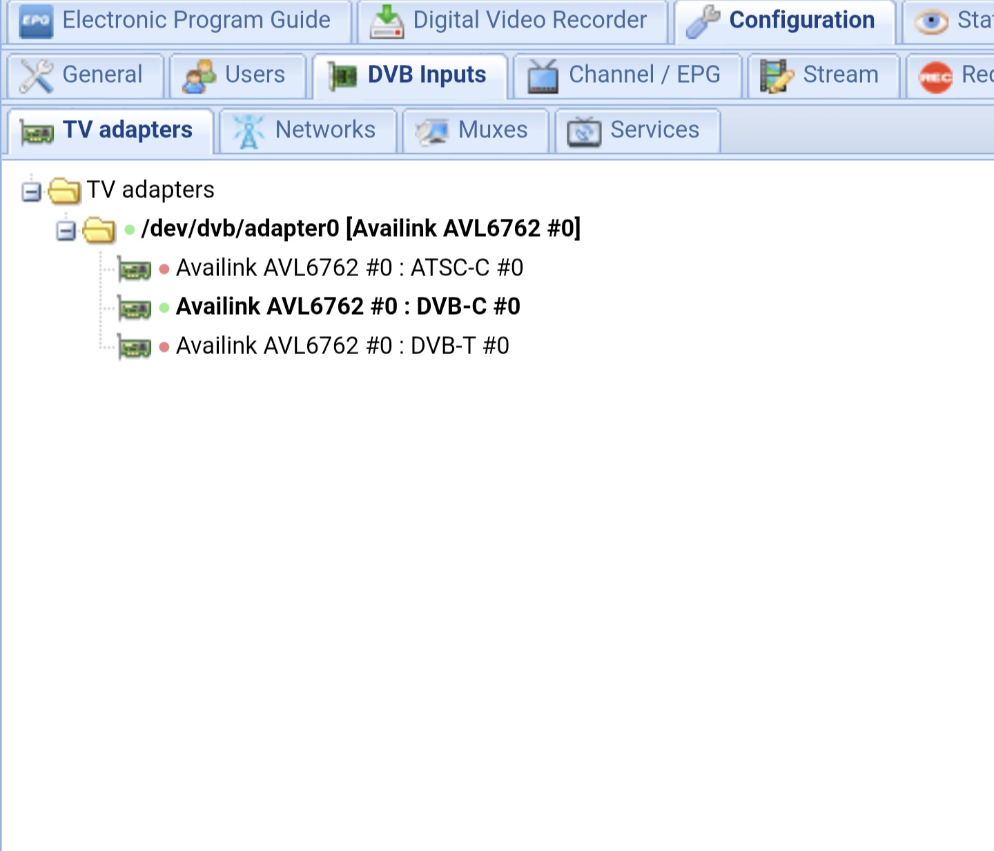

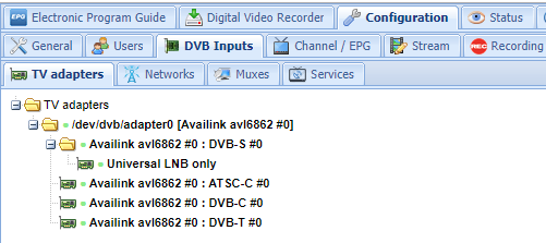

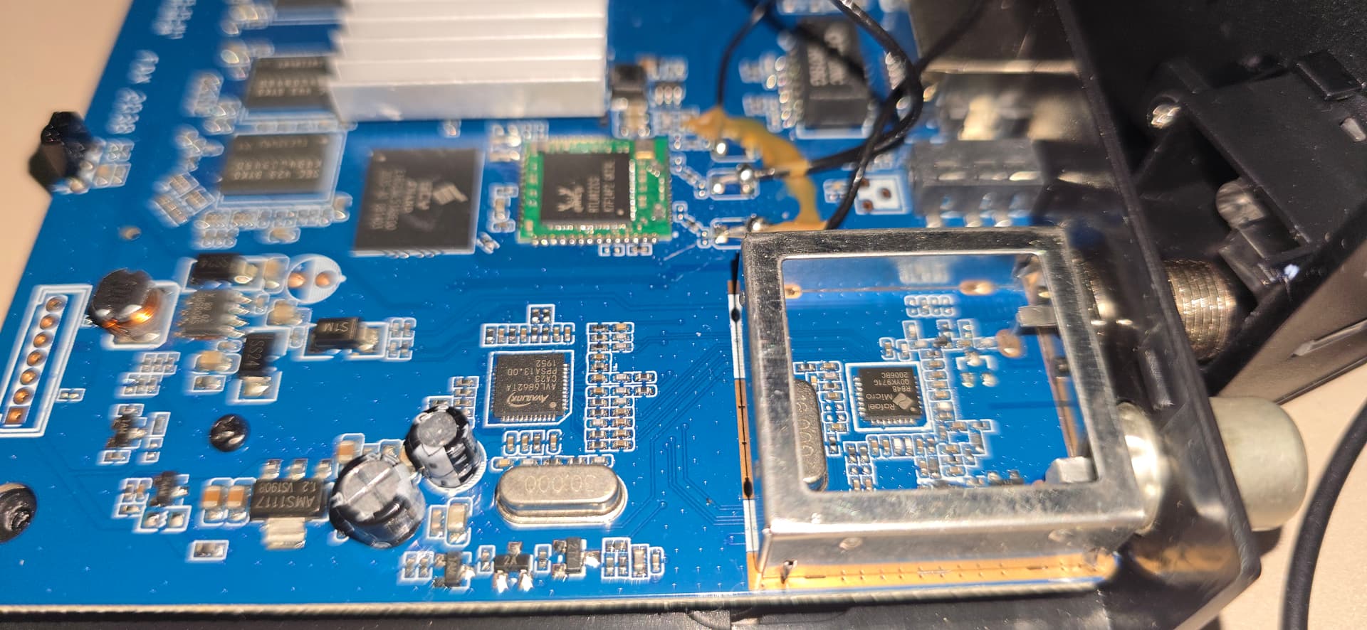

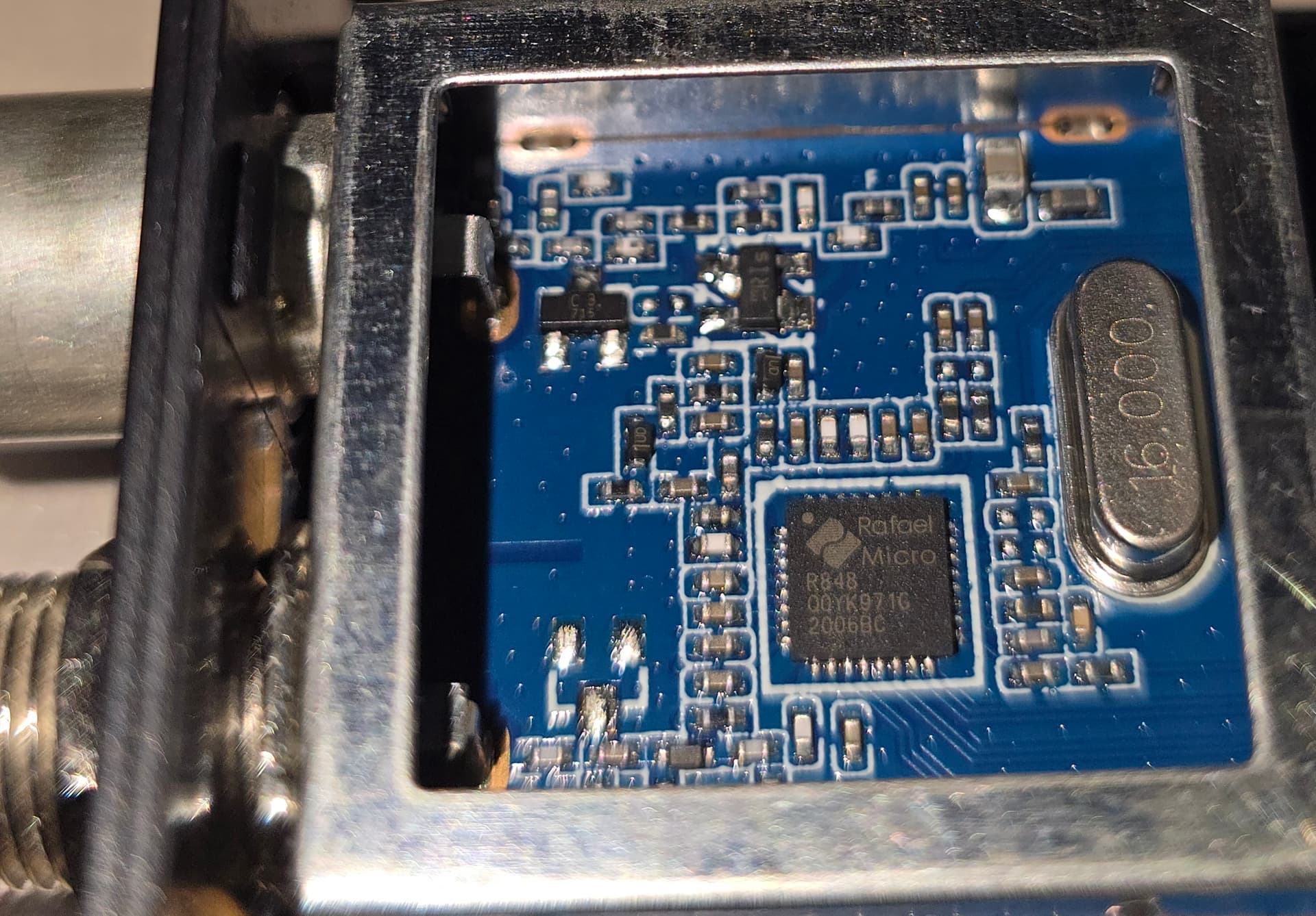

S905X4 built in DVB

stop tvheadend systemctl stop service.tvheadend43
prepare scan conf file containing one frequency that should be succesfully tuned to similar to this:
[CHANNEL]

DVB-S2 and DVB-C testing is now available.
dmesgi2c3_new.txt (74.7 KB)
DVB-2 was not found in the TVheadend adapter section, and a scan no data error was given when searching for DVB-C.

I missed that the tuner is R848. I do not see driver for that in current CE build. What tuner is in K1 Pro ?
Try this, it should detect DVB-S but probably will not tune to any channel correctly:
sm1_s905x3_mecool_k5.dtb (77.1 KB)
