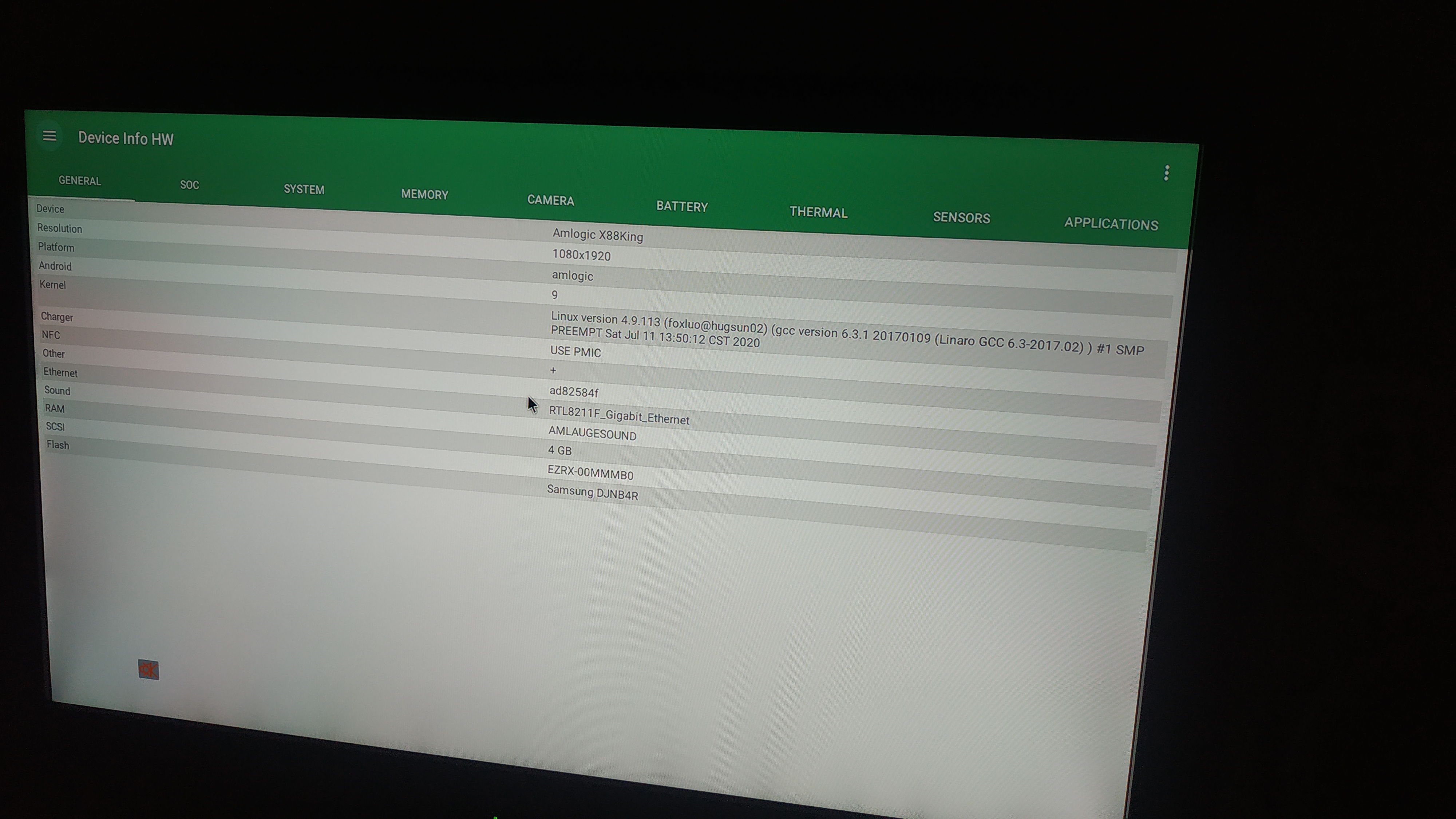

Have you black or colored box ? Please put here shot frpm application device info hw in android. If we have same eth chip according to this app in android.
Interesting is also presence of integrated sound amplifier ad82584f in android, which i dont see in logs of coreelec http://ix.io/2y4F . https://datasheetspdf.com/mobile-pdf/1345785/ESMT/AD82584F/1

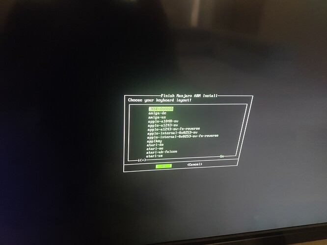

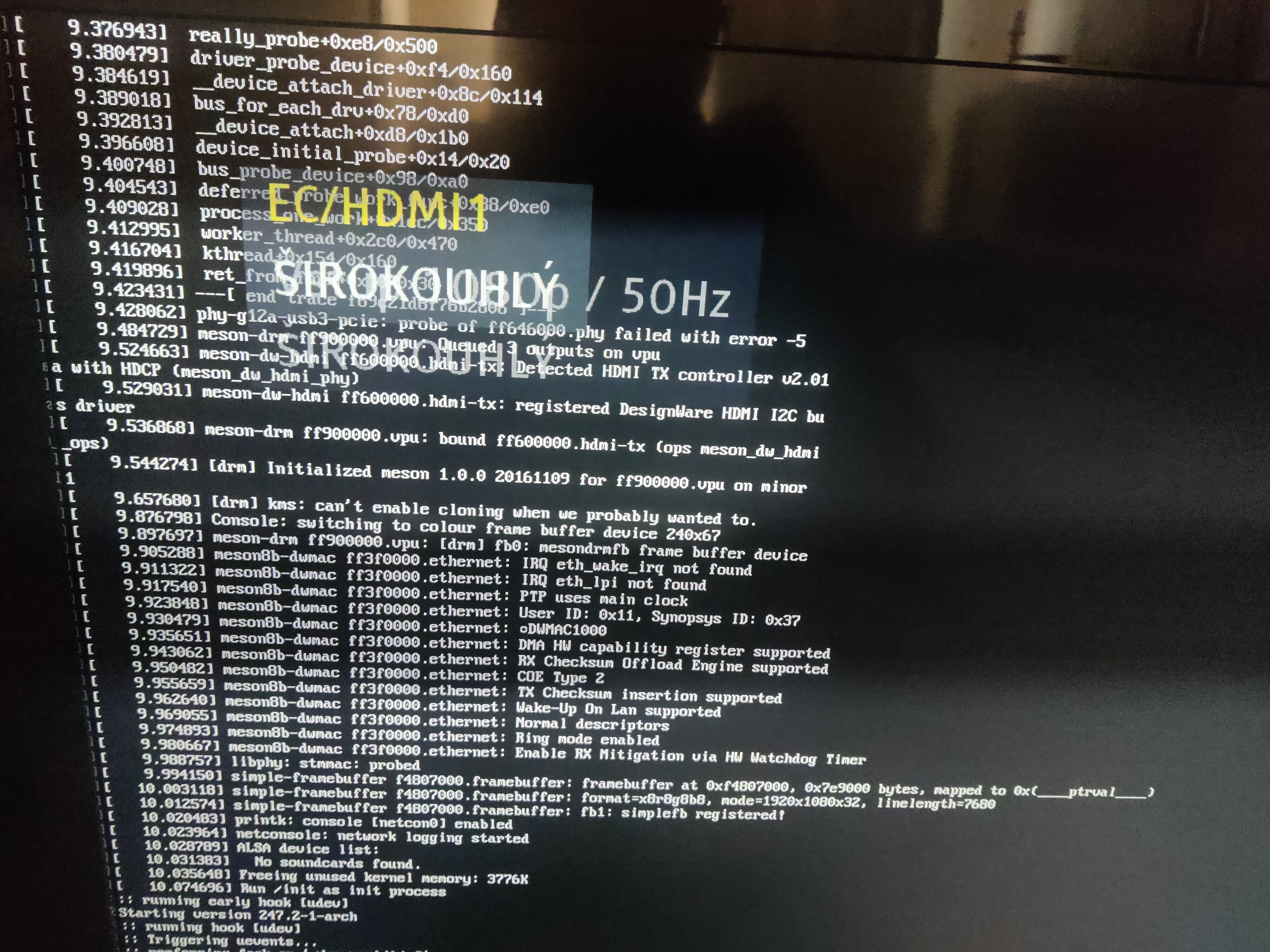

For better diagnostik i tried run Manjaro linux on x88king, but usb ports with dtb.img from am6 plus are not recognized. Dtb.img from coreelec not helped - kernel was not loaded.
