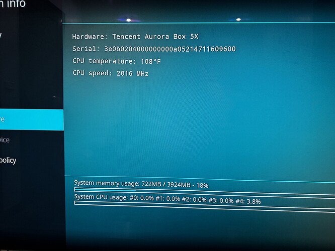

Thanks for the link I didn’t notice posts saying there are problems booting with the SD-CARD reader. Placing the SD card in a USB reader I can boot my x96x10 pro too
CoreELEC (official): 21.1-Omega_nightly_20240717 (Amlogic-ne.aarch64)
      Machine model: Tencent Aurora Box 5X
     CoreELEC dt-id: s5_s928x_tencent_aurora_5x
      Amlogic dt-id: s5_s928x_ax201-v2
      Linux version: 5.4.210 (docker@c6840f9c8a48) #1 Wed Jul 17 03:55:58 IDT 2024
      Kodi compiled: 2024-07-17 01:22:46 +0000
