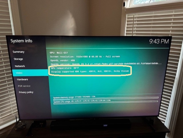

Dolby Vision

Whatās confusing is whether my 4GB/32GB X96 X10 has the āJā chip? If not, DV shouldnāt exist right under stock Android, nor CE? And, yet it does.
A DV module is loading in CE? lsmod | grep dovi
If so did you add it, or is it included in the Android firmware?

When I first got the box and went into the stock Android OS, DV was showing in the settings, and playing a DV clip triggered DV on my TV.
Then, after booting into CE, DV options showed up under Settings. And, even more remarkably, after I did installtointernal to eMMC, wiping out the Android OS, itās still thereā¦
My guess is that the x96 x10 and x10 Pro use the same Android firmware, so thereās a dovi.ko present, and thatās being automatically loaded from CE. CE looks for and loads the Android dovi.ko by default.
Have you opened up the box and checked the SOC to see if itās marked with a -J/K
