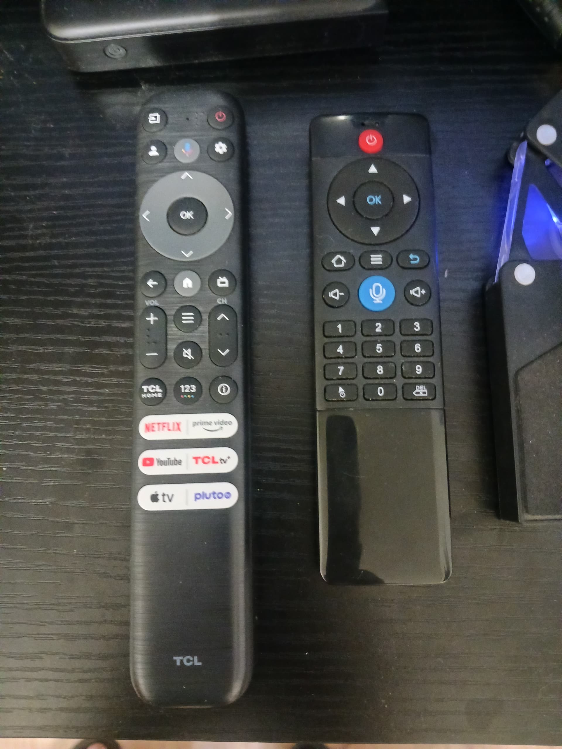

If you aren’t satisfied with the IR functionality of the X10, buy a BT USB dongle for $5-10 as was previously recommended. IR is directional, and the receiver is what it is. Other devices have multiple receivers, receivers with lens, receivers that are exposed, etc. There’s a lot of reasons why IR responsiveness might be better. It’s a hardware issue, not a software issue, not much can be done.

I have a BT G20s with a dongle that works and is better than the crappy X10 stock remote, but my preferred remote is a HP MCE Remote with a lot of extra keys, but to use that, I must use IR.
Did you try using the MCE remote with the X10 IR receiver? You’d need to delete the remote.conf file, then reboot. That will load the meson-ir driver, I think there’s an MCE profile.
Alternatively, plug in the HP MCE USB IR receiver and use that with the MCE remote.
I did try the MCE remote with the X10 receiver and it was very insensitive.
I haven’t tried the MCE receiver with the X10 yet.

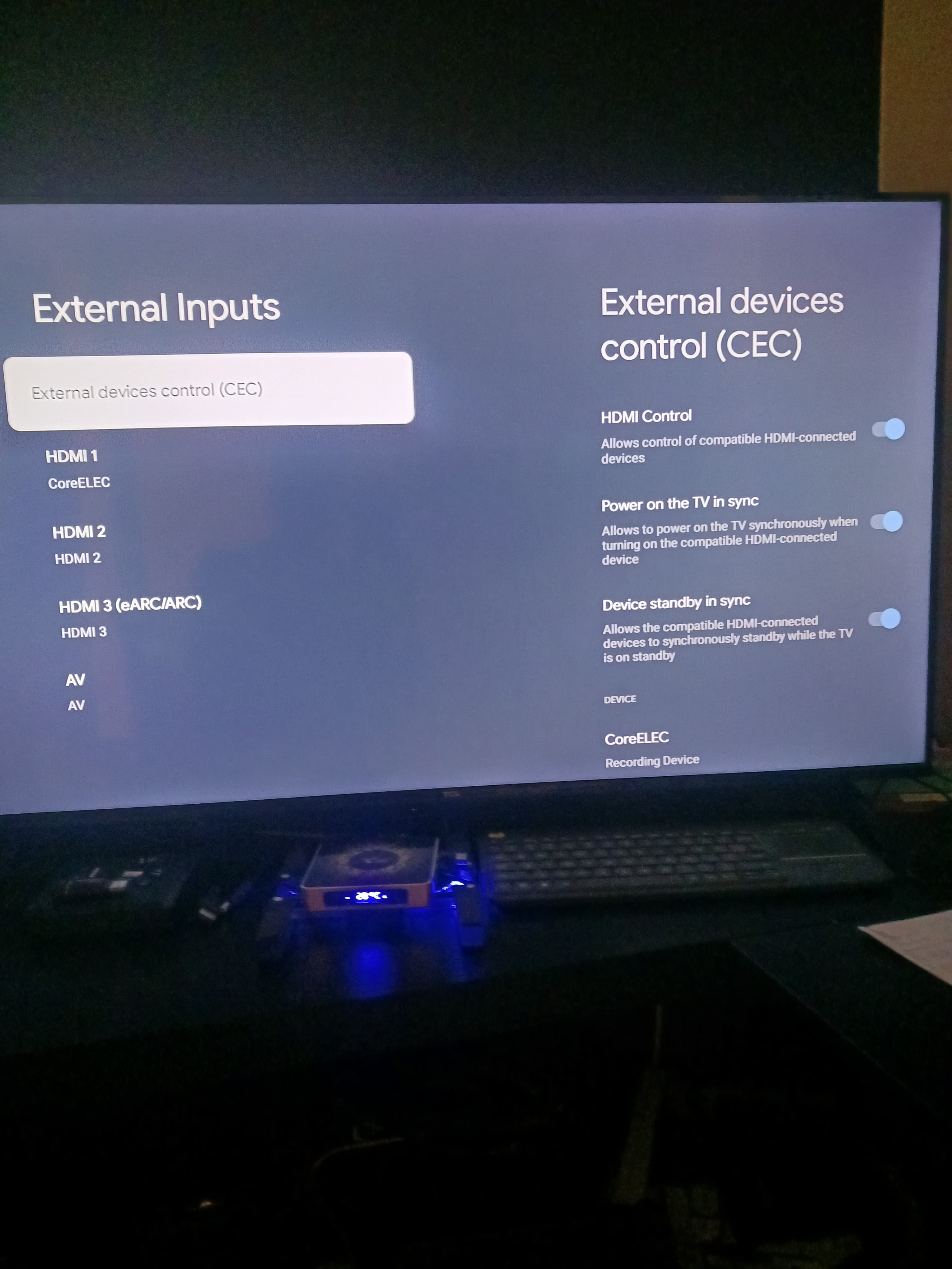

When I turn off the TV and the box gets suspended via CEC, when it resumes there is no HDMI output.
If I ssh into it and systemctl restart kodi
, then the output comes back.
I’d rather not shut down the box because then it won’t come back via CEC.
Is there any way to get it to resume properly from CEC and reenable/refresh HDMI output?
Edit: and today it worked properly… weird.
Actually, it is unreliable resuming.
Today there was no HDMI output, I had to reboot the box to get it to come back.
CeC seems to be hit n miss with some boxes,CoreELEC/also your TV CeC settings can be a factor.
I have no issues power on /power off with TV remote
Or using Generic ir remote (cheepoo,with 4 year old remoteconfig),and default settings in CoreELEC CeC
With TV remote power on/powers on the X96X10, on HDMI 1,sometimes have to use source/inputto select HDMI port,or i use Google Voice/Hey Google go to HDMI 1,X96X10 power’s up.
With generic cheepoo power off /turns TV off,and X96X10
Power on /turns X96X10 and TV on
My experience with standby on any device is that it is never reliable. However I dop have the same experience as @freddy and my x96 x10 can power up the bootoeader by IR using the power button code on many generic NEC Amlogic boxes over the last couple of years. You can test your remotes by ssh to see if you have a matching IR.
