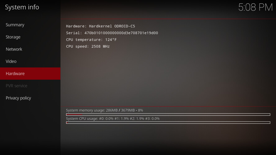

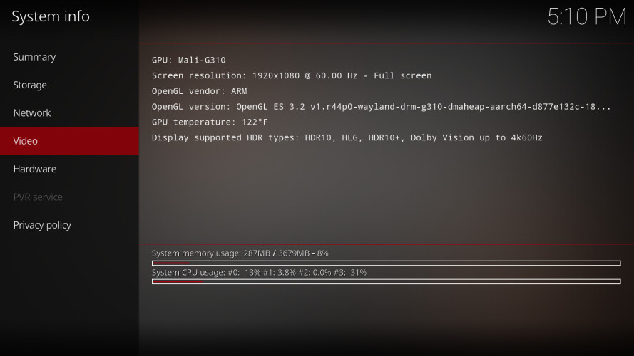

I received my Odroid C5 and was surprised how well the HK Android Kodi works with most of my media using amc codecs playing most formats using HW. NIce being able to touch the board and have it cool to the touch these days.

I just installed on my ODROID C5 and I am impressed with my first impressions. I did make a typo creating nfs mount which caused the system to get into a boot loop but it works so far. Thanks for the hard work, I had the emmc from Linux installed so I didn’t even notice the requirement.
