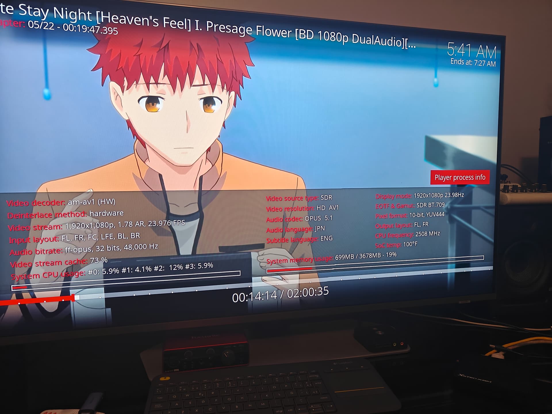

@freddy why do you think I only have 32GB? /data on Android is 54GB but it isn’t mounted by CE
/dev/block/dm-50 54G 2.4G 52G 5% /data
Any I like the C5 so far as noted above and and very limited testing seems to be the same This runs at 51C and 2 watts so pretty nice.
