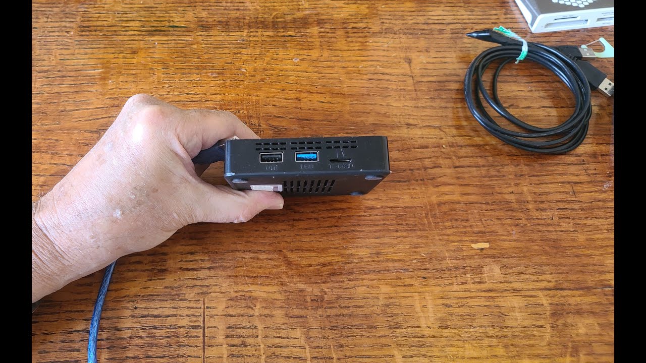

For those having issues installing different firmware’s onto this TOX3 box, I made a video that may help.
The key is to use the power supply and making sure the drivers are installed.
