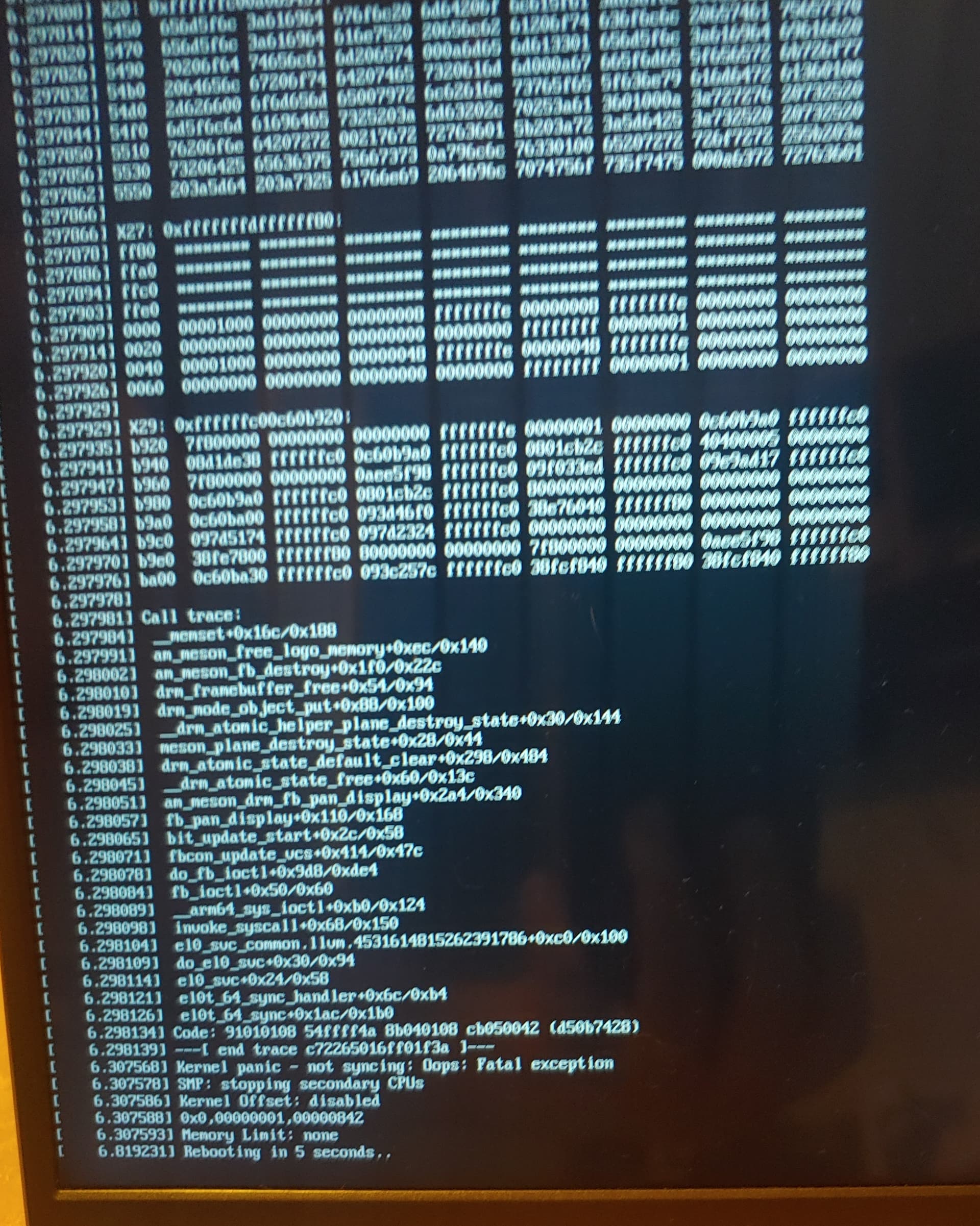

I tried it, and the start appeared, but there was an error and a cyclic reboot after 5 seconds.
I tried to take a photo of what it looks like.

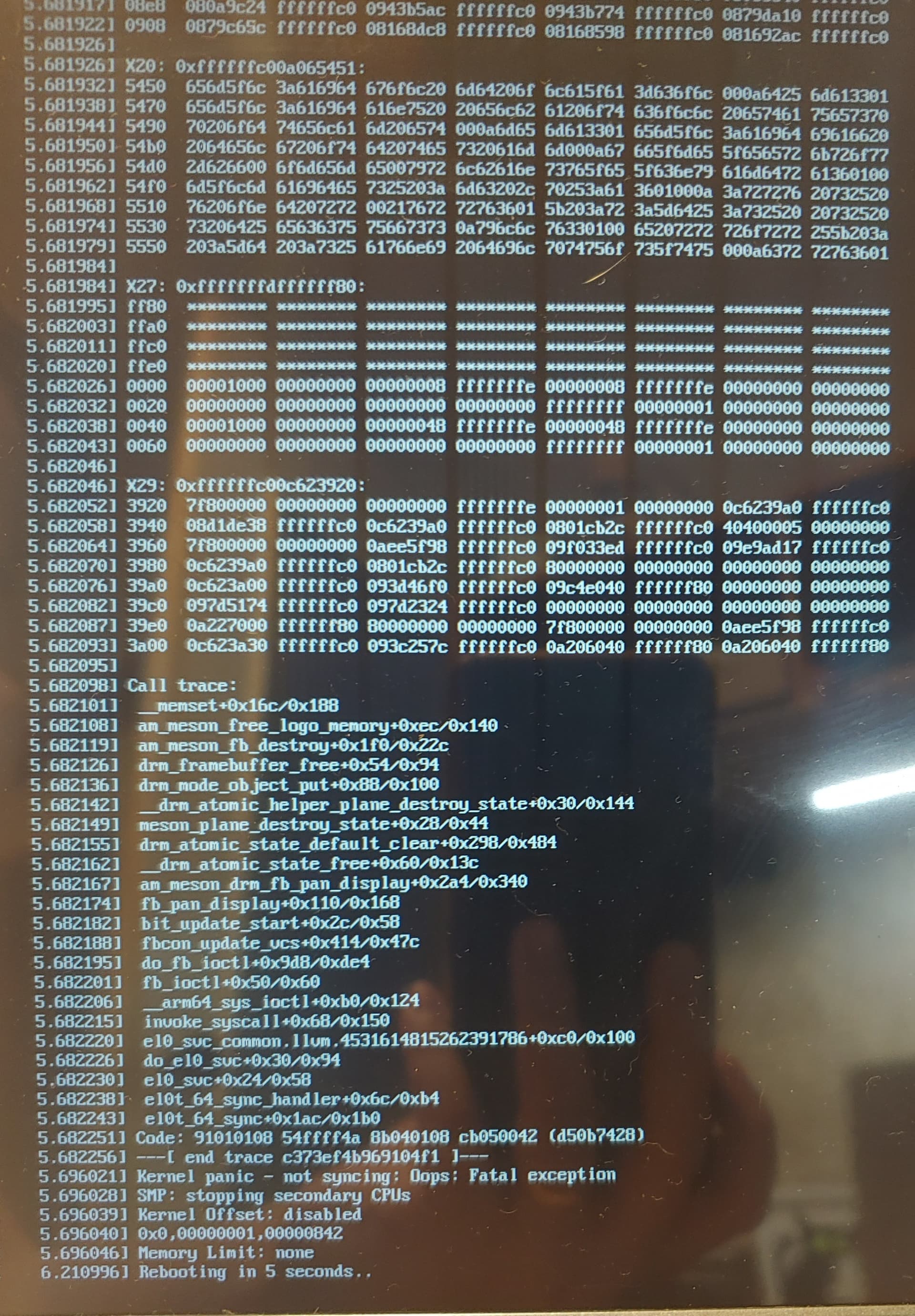

Try this one https://test.coreelec.org/vpeter/s4_s905y4_1g.dtb
It didn’t work, probably for the same reason as above, but I took a photo just in case.

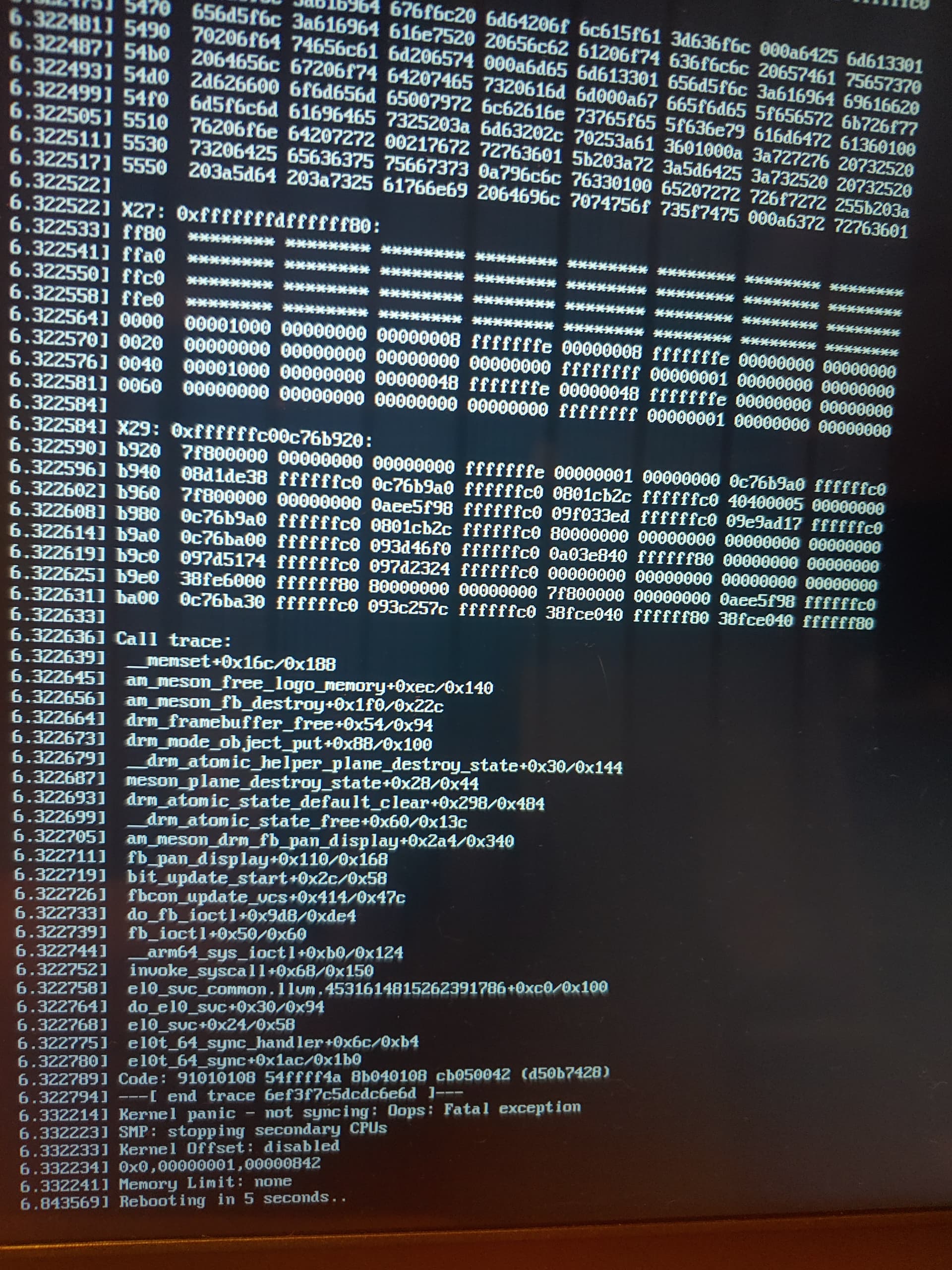

Next one: https://test.coreelec.org/vpeter/s4_s905y4_1g.dtb
He’s not making any progress yet…

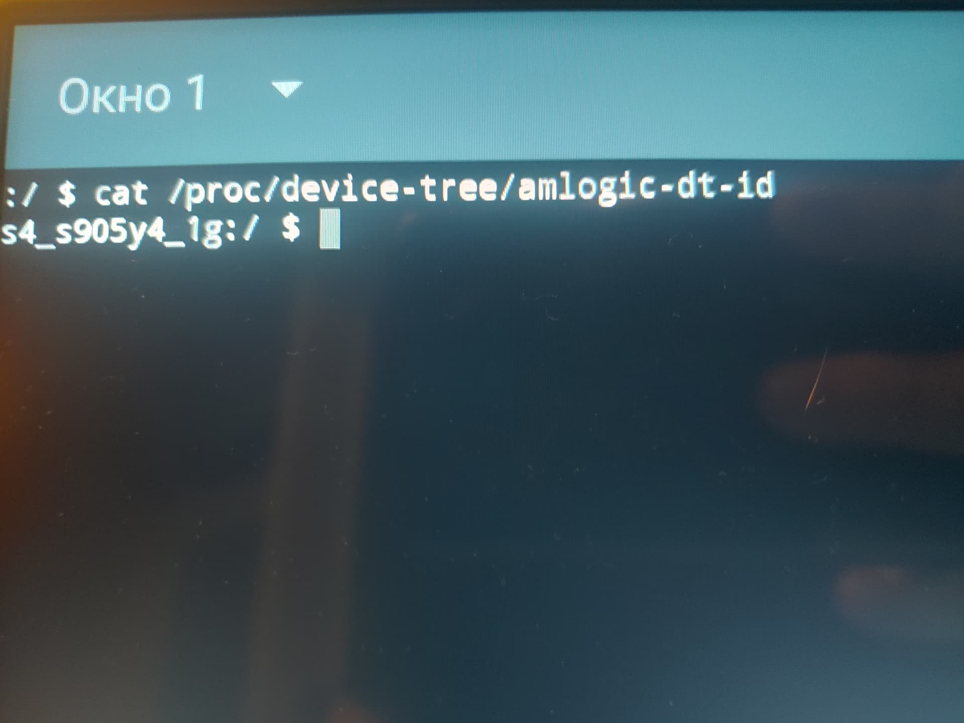

After finding and replacing this value in dtb using a hex editor, I decided to run it one last time. And it started, Coreelec 22. I’m attaching the file below, and you can add it in future versions.
last_s4_s905y4_1g.dtb (70.6 KB)
This is exactly what I did on my first attempt. I made a mistake or you made a mistake testing it.
To be honest, I didn’t change anything on the fat32 disk except for DTB, in Coreelec 22.
But it doesn’t change the essence of the matter. It worked. Thank you, vpeter. Without you, the problem wouldn’t have been solved.
P.S. It might be worth adding this dtb to future versions of CE.
P.S.2. I changed the name in DTB to s905y4_g1.

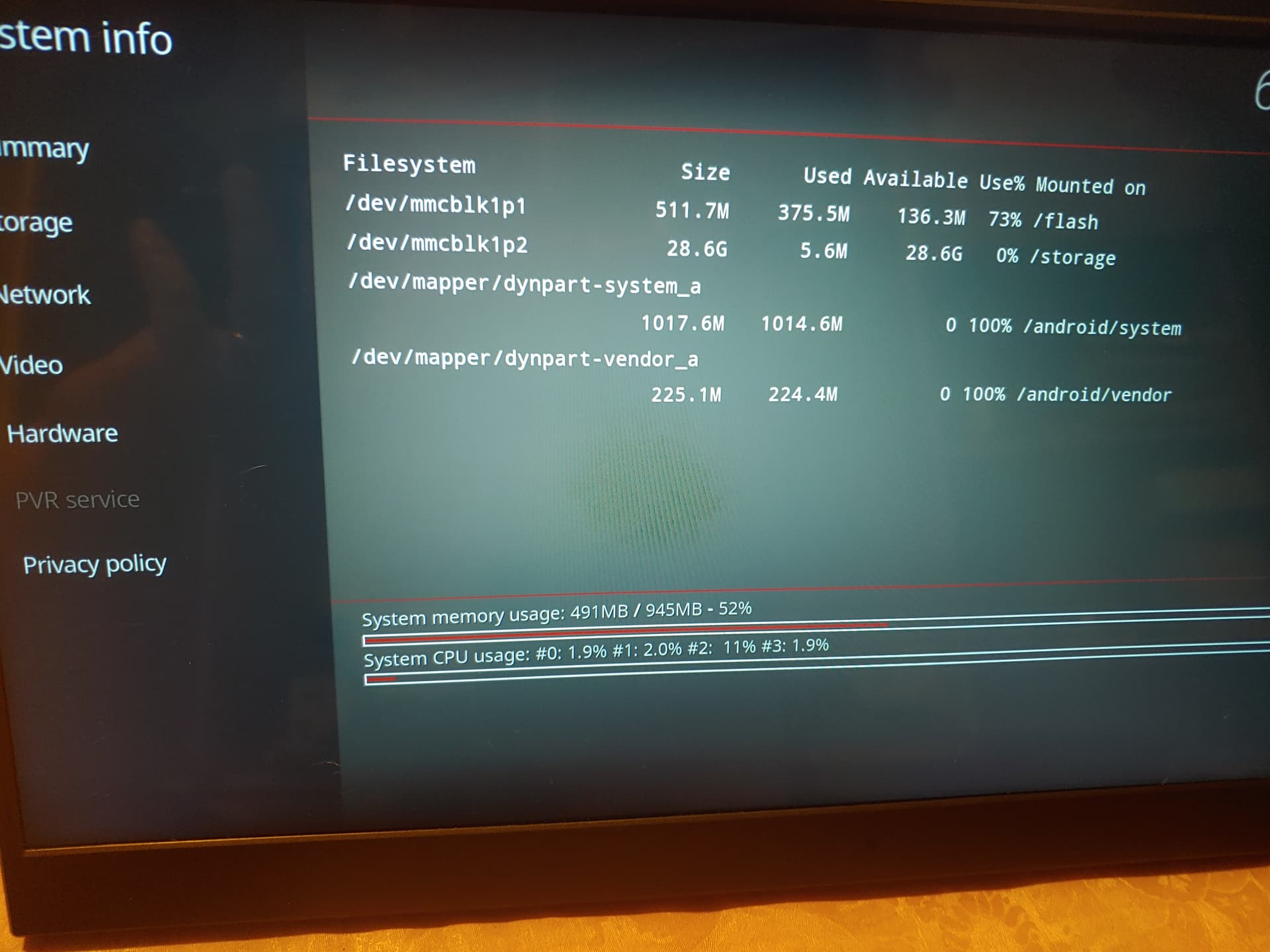

I’m sorry, but I think I was too happy. None of the videos, either online or TV channels, are running.
I have no idea what to think about yet. I think I need to shift something from 2GB to 1GB (video memory or something like that)…
