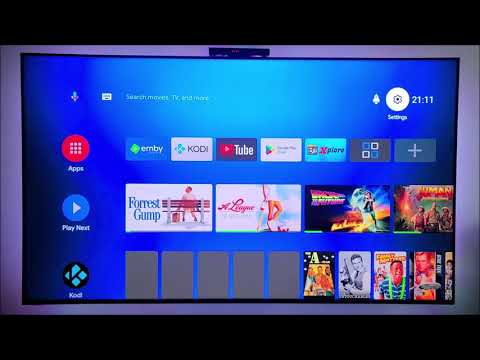

I still cannot get the VC-1 video codec to play correctly using CE, but in the process of finding a solution, I found something very interesting.
I tried 3 different ROMS for this TOX3 box, but finally found Slimbox’s ROM to exceed my expectations. It supports the HD audio codecs AND supports automatic frame rate and resolution switching.
At the end of the video, you can see what I am talking about CE playing that pesky VC-1 video codec…
Here is my video of this box running Slingbox’s ATV ROM.
