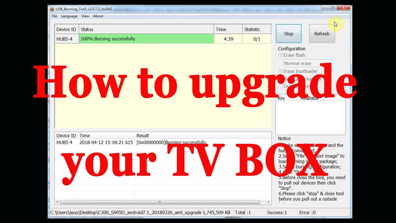

When using USB Burning Tool, the screen lists all partitions it will attempt to burn.
Just untick everything other that recover or boot and see what happens
