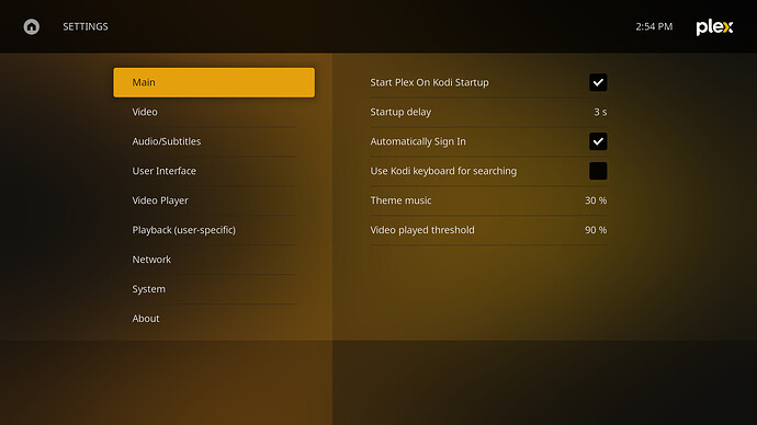

Startup delay in main page of PM4K settings
Can I please get a little more effort put into these posts. There is no startup delay in main page. https://i.imgur.com/qtMPk6U.jpeg
Additionally, my resolution is still randomly resetting on the ugoos, and I still need a solution to TV-led FEL having black artifacts even when directly plugged into the tv. 3
I got the startup working, by going to settings in PM4k → system → enable “slow connection” even though my connection is local network and not slow at all. This has everything loading with plex autostarting on kodi.

You should have told me the fix is manually downloading and uploading the newer beta pm4k lol. I am now on 0.8.0-beta5.1 . This has the delay startup setting which is better than the slow connection setting which was causing its own issues.
