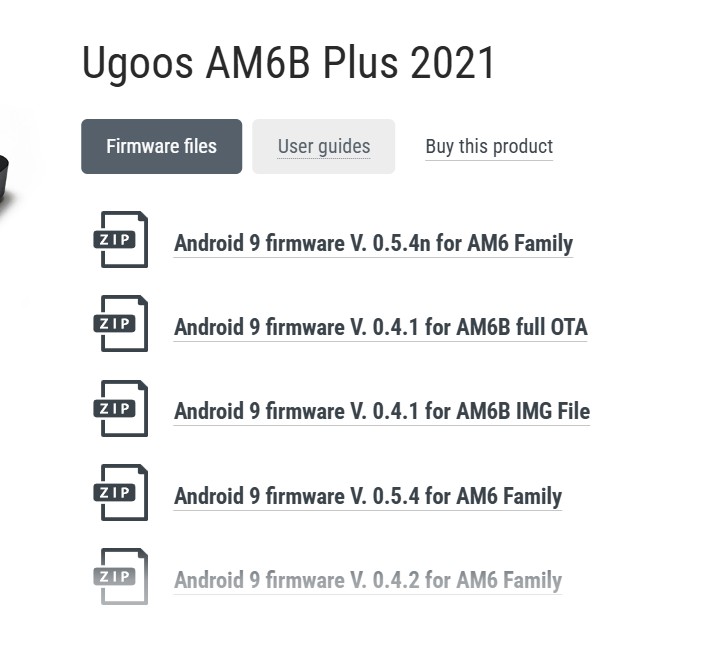

Thanks I will try that. I don’t suppose you know which firmware is the right option for the AM6B+? Would it be the full OTA version?
No, OTA update is to be done when you have working Android installation. You need “Android 9 firmware v.0.5.4(n) for AM6 Family”. This is an image file to be used with mentioned “USB Burning Tool”.
