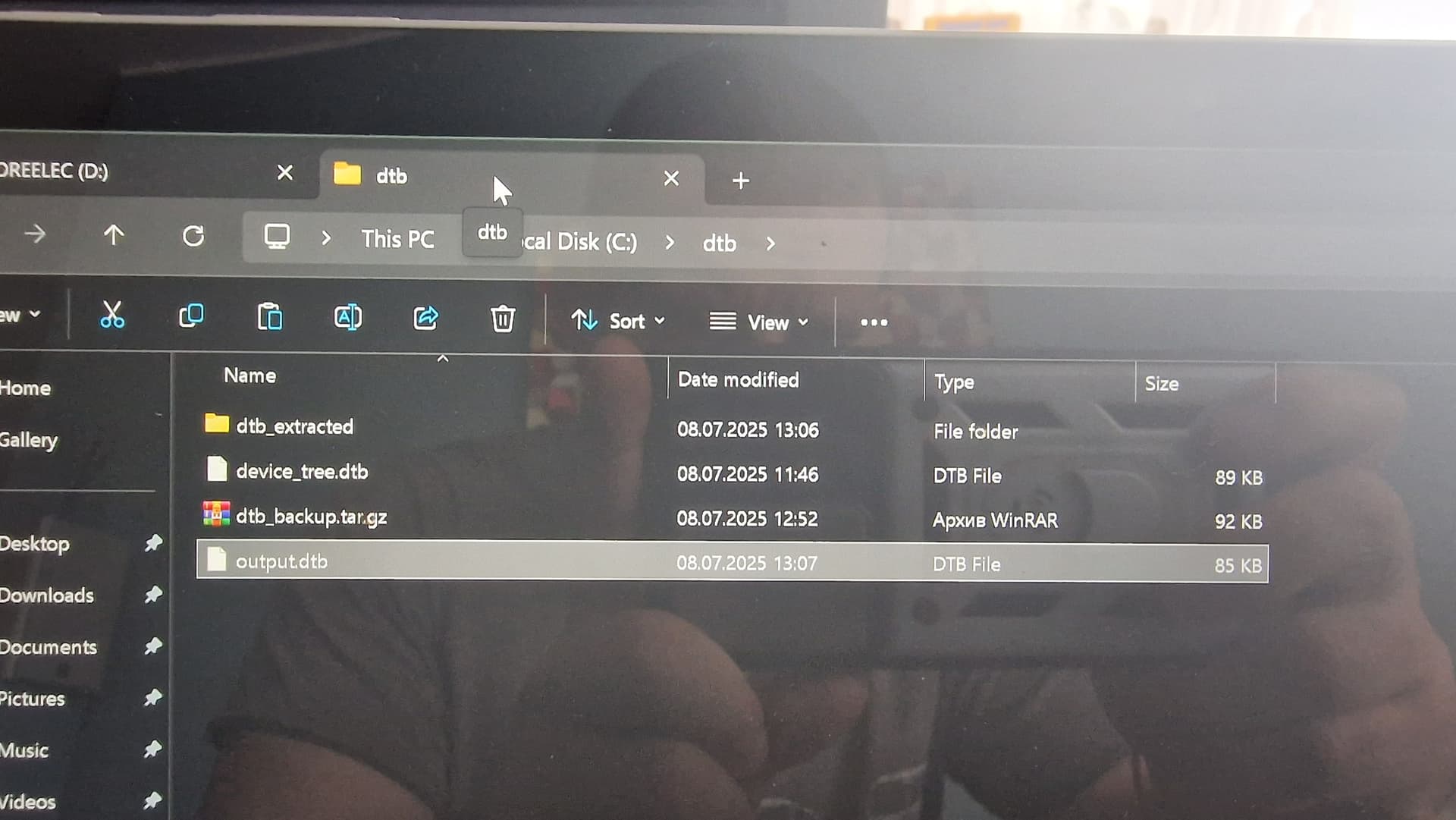

Hi,I’ve extracted device tree dtb files from AM9,can it help with development?I tried also renaming it to dtb.img,but AM9 booted to recovery any suggestions?
Link will be active for 3 days,but I can send it to email.
AM9 device tree
Any help to make coreelec work on AM9 appreciated :smiley:
Already extracted DTB from Android image itself.
Okay,so the main coreelec firmware needs to be modified now,I tried different ones,still doesn’t boot.
No, only DTS needs to be created for this device.
Attach serial port console to see what is going on with booting.
How to do that :grinning: Maybe you can upload working dtb file,because i got 2 dtb files with different size,so I can try to boot using your dtb.
There is no DTB file for this device. Someone needs to create it.

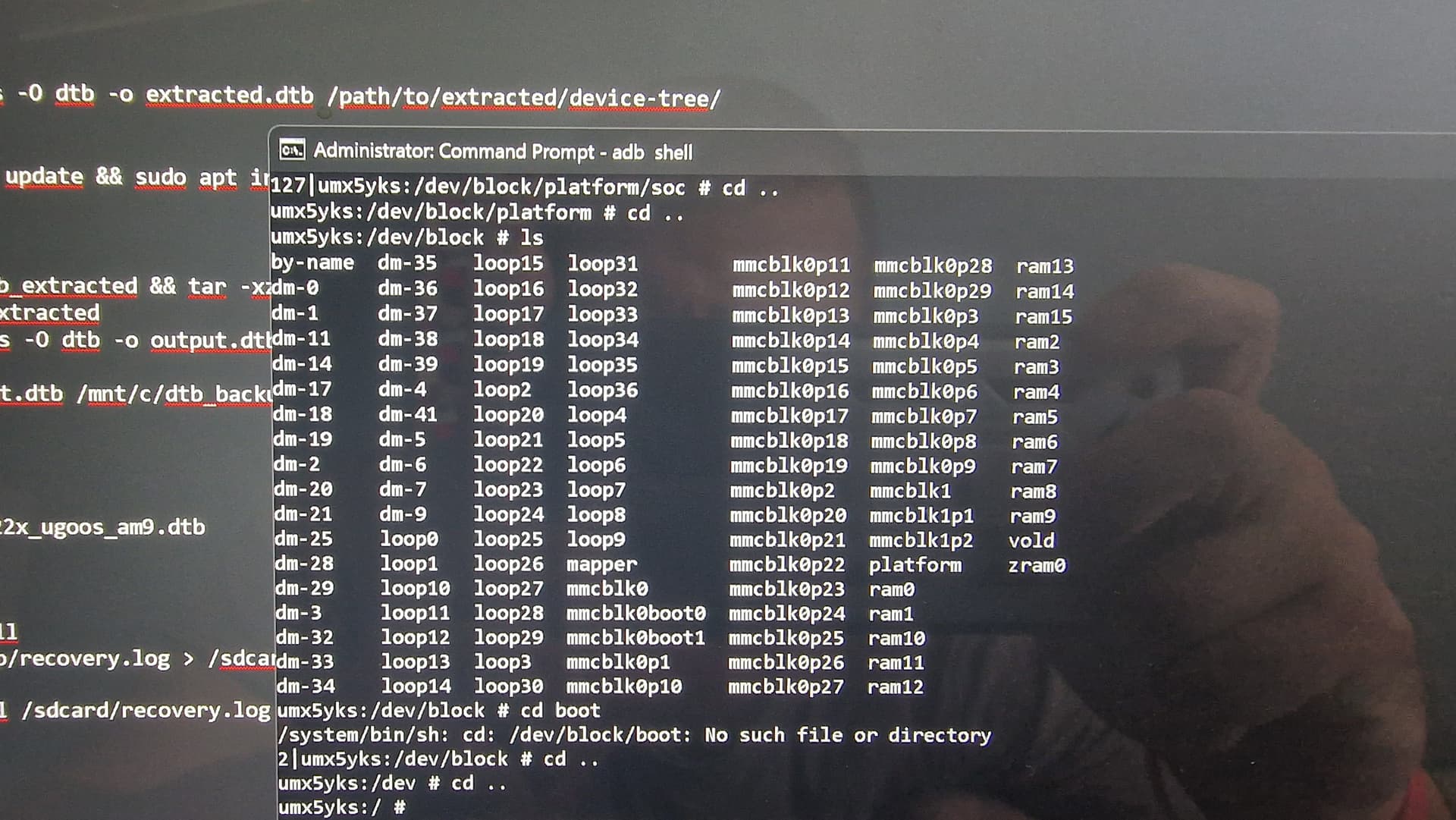

Those are partitions I get:
lrwxrwxrwx 1 root root 21 1970-01-01 02:00 boot_a -> /dev/block/mmcblk0p18
lrwxrwxrwx 1 root root 21 1970-01-01 02:00 boot_b -> /dev/block/mmcblk0p19
lrwxrwxrwx 1 root root 20 1970-01-01 02:00 bootloader_a -> /dev/block/mmcblk0p7
lrwxrwxrwx 1 root root 20 1970-01-01 02:00 bootloader_b -> /dev/block/mmcblk0p8
lrwxrwxrwx 1 root root 21 1970-01-01 02:00 cri_data -> /dev/block/mmcblk0p14
lrwxrwxrwx 1 root root 21 1970-01-01 02:00 dtbo_a -> /dev/block/mmcblk0p12
lrwxrwxrwx 1 root root 21 1970-01-01 02:00 dtbo_b -> /dev/block/mmcblk0p13
lrwxrwxrwx 1 root root 20 1970-01-01 02:00 env -> /dev/block/mmcblk0p2
lrwxrwxrwx 1 root root 20 1970-01-01 02:00 factory -> /dev/block/mmcblk0p4
lrwxrwxrwx 1 root root 20 1970-01-01 02:00 frp -> /dev/block/mmcblk0p3
lrwxrwxrwx 1 root root 21 1970-01-01 02:00 init_boot_a -> /dev/block/mmcblk0p20
lrwxrwxrwx 1 root root 21 1970-01-01 02:00 init_boot_b -> /dev/block/mmcblk0p21
lrwxrwxrwx 1 root root 21 1970-01-01 02:00 logo -> /dev/block/mmcblk0p10
lrwxrwxrwx 1 root root 21 1970-01-01 02:00 metadata -> /dev/block/mmcblk0p22
lrwxrwxrwx 1 root root 21 1970-01-01 02:00 misc -> /dev/block/mmcblk0p11
lrwxrwxrwx 1 root root 18 1970-01-01 02:00 mmcblk0 -> /dev/block/mmcblk0
lrwxrwxrwx 1 root root 23 1970-01-01 02:00 mmcblk0boot0 -> /dev/block/mmcblk0boot0
lrwxrwxrwx 1 root root 23 1970-01-01 02:00 mmcblk0boot1 -> /dev/block/mmcblk0boot1
lrwxrwxrwx 1 root root 21 1970-01-01 02:00 odm_ext_a -> /dev/block/mmcblk0p16
lrwxrwxrwx 1 root root 21 1970-01-01 02:00 odm_ext_b -> /dev/block/mmcblk0p17
lrwxrwxrwx 1 root root 21 1970-01-01 02:00 param -> /dev/block/mmcblk0p15
lrwxrwxrwx 1 root root 20 1970-01-01 02:00 reserved -> /dev/block/mmcblk0p1
lrwxrwxrwx 1 root root 21 1970-01-01 02:00 rsv -> /dev/block/mmcblk0p28
lrwxrwxrwx 1 root root 21 1970-01-01 02:00 super -> /dev/block/mmcblk0p27
lrwxrwxrwx 1 root root 20 1970-01-01 02:00 tee -> /dev/block/mmcblk0p9
lrwxrwxrwx 1 root root 21 1970-01-01 02:00 userdata -> /dev/block/mmcblk0p29
lrwxrwxrwx 1 root root 21 1970-01-01 02:00 vbmeta_a -> /dev/block/mmcblk0p23
lrwxrwxrwx 1 root root 21 1970-01-01 02:00 vbmeta_b -> /dev/block/mmcblk0p24
lrwxrwxrwx 1 root root 21 1970-01-01 02:00 vbmeta_system_a -> /dev/block/mmcblk0p25
lrwxrwxrwx 1 root root 21 1970-01-01 02:00 vbmeta_system_b -> /dev/block/mmcblk0p26
lrwxrwxrwx 1 root root 20 1970-01-01 02:00 vendor_boot_a -> /dev/block/mmcblk0p5
lrwxrwxrwx 1 root root 20 1970-01-01 02:00 vendor_boot_b -> /dev/block/mmcblk0p6

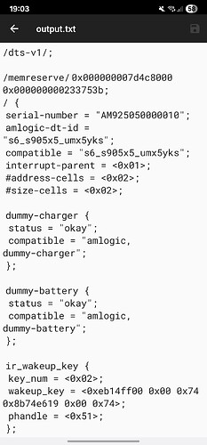

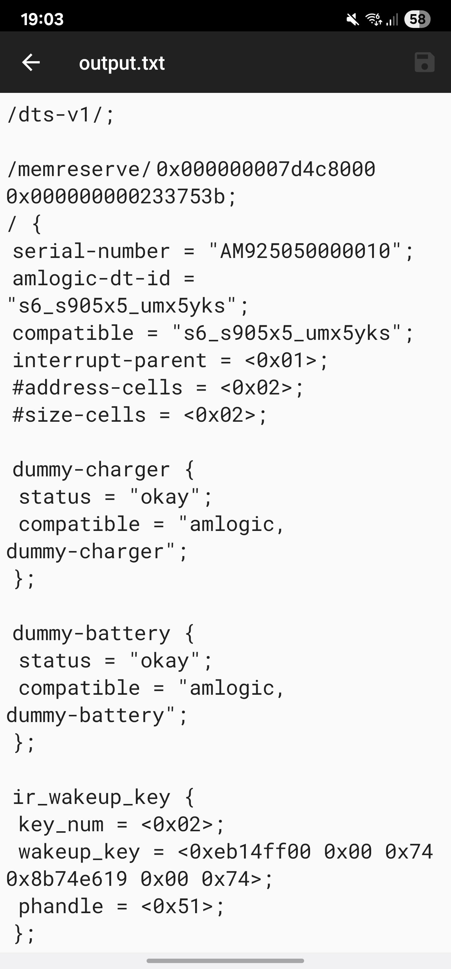

Example DT for S905X5M:
Okay so I got right DTS file,now what should I look for ?
You think someone will tell you exactly what to do? If this would be so easy it would be already done. Look for USB and SD changes where booting starts.
And once more: serial console is needed to easily see where it fails booting. That’s why having local device at hand is preferred method by devs.
Here is DTS,if anyone willing to help me,you’re welcome.

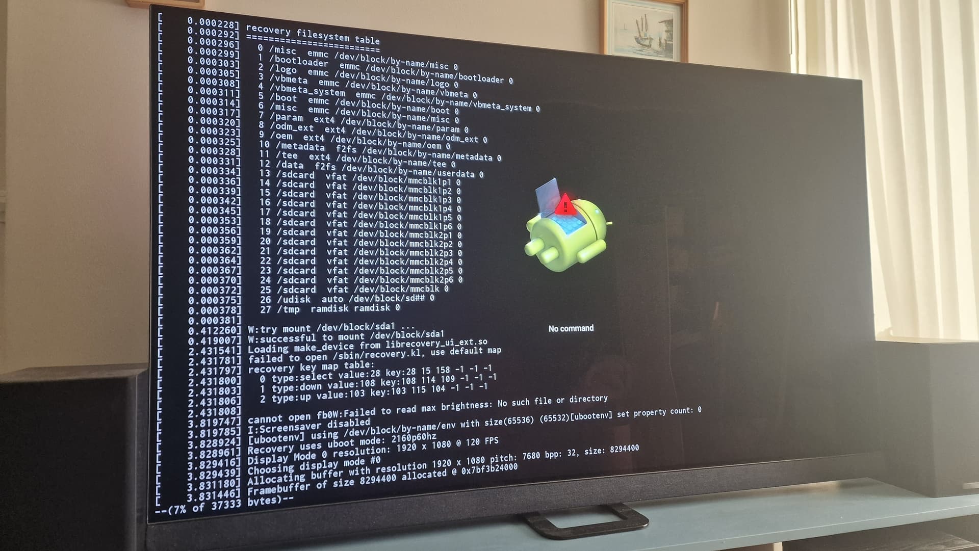

Log file from recovery after failed coreelec boot attempt from micro sd card
0.001055] recovery filesystem table

3.703214] ro.product.product.device=umx5yks
3.703216] ro.product.product.manufacturer=UGOOS
3.703219] ro.product.system_ext.name=umx5yks_arm64
3.703221] ro.product.system_ext.brand=UGOOS
3.703224] ro.product.system_ext.model=AM9
3.703226] ro.product.system_ext.device=umx5yks
3.703229] ro.product.system_ext.manufacturer=UGOOS
3.703232] ro.product.manufacturer=UGOOS
3.703234] ro.system_ext.build.id=UD2A. 240505.001.W1
3.703237] ro.system_ext.build.date=Fri Jun 6 19:46:03 MSK 2025
3.703239] ro.system_ext.build.date.utc=1749228363
3.703242] ro.system_ext.build.tags=test-keys 3.703244] ro.system_ext.build.type=userdebug 3.703247] ro.system_ext.build.version.sdk=34
3.703250]
ro.system_ext.build.version.release=14
Γ
3.703252] ro.system_ext.build.version.incremental-eng. ugoos.20250606.194642
3.703263] ro.system_ext.build.version.release_or_codename=14
3.703268] ro.system_ext.build. fingerprint-UGOOS/umx5yks_arm64/umx5yks: 14/UD2A. 240505.001.W1/ugoos06061946: userdebug/test-keys 3.703271] ro.actionable_compatible_property.enabled=true No command
3.703274] ro.vendor.build.id=UD2A.240505.001.W1
3.703276] ro.vendor.build.date=Fri Jun 6 19:46:03 MSK 2025
3.703279] ro.vendor.build.date.utc=1749228363
3.703281] ro.vendor.build.tags=test-keys
3.703284] ro.vendor.build.type=userdebug
3.703287] ro.vendor.build.version.sdk=34
3.703289] ro.vendor.build.version.release=14
3.703292] ro.vendor.build.version.incremental-eng.ugoos.20250606.194642
3.703294] ro.vendor.build.version.release_or_codename=14
3.703297] ro.vendor.build. fingerprint-UGOOS/umx5yks_arm64/umx5yks: 14/UD2A.240505.001.W1/ugoos06061946: userdebug/test-keys 3.703300] ro.vendor.product.cpu.abilist=arm64-v8a, armeabi-v7a, armeabi
3.703302] ro.vendor.product.cpu.abilist 32=armeabi-v7a, armeabi
3.703305] ro.vendor.product.cpu.abilist64 arm64-v8a
3.703308] ro.vendor.api_level=34
3.703310] ro.product.board=umx5yks
--(36% of 36980 bytes) --
பபபபபட
Ε
3.703313] ro.product.vendor.name=umx5yks_arm64 3.703315] ro.product.vendor.brand=UGOOS 3.703318] ro.product.vendor.model=AM9
3.703321] ro.product.vendor.device=umx5yks
3.703323] ro.product.vendor.manufacturer=UGOOS
3.703326] ro.product.first_api_level=34
3.703387] camera.disable_zsl_mode=1
3.703739] ro. cold_boot_done=true
3.703942] ro.bionic.arch=arm64
3.703948] ro.bionic. 2nd_arch=arm
3.703951] ro.bionic.cpu_variant=cortex-a55
3.704985] ro.dalvik.vm.native.bridge=0
3.703956] ro.bionic. 2nd_cpu_variant=cortex-a55
Ε
3.705011] ro.dalvik.vm.enable_uffd_gc=false 3.705014] ro. zygote=zygote64_32
3.705017] dalvik.vm.isa.arm.variant=cortex-a55
3.705020] dalvik.vm.isa.arm.features=default 3.705023] dalvik.vm.isa.arm64.variant=cortex-a55
3.705025] dalvik.vm.isa.arm64.features=default 3.705028] dalvik.vm.dexopt.secondary=true 3.705030] dalvik.vm.dexopt. thermal-cutoff=2 3.705033] dalvik.vm.usejit=true
Γ
3.705036] dalvik.vm.madvise.artfile.size=4294967295 3.705038] dalvik.vm.madvise.odexfile.size=104857600 3.705041] dalvik.vm.madvise.vdexfile.size=104857600 3.705043] dalvik.vm.heapsize=384m
3.705046] dalvik.vm.lockprof. threshold=500
3.705048] dalvik.vm.dex2oat-Xms=64m 3.705051] dalvik.vm.dex2oat-Xmx=512m 3.705053] dalvik.vm.heapmaxfree=8m 3.705056] dalvik.vm.heapminfree=512k 3.705058] dalvik.vm.heapstartsize=8m 3.705061] dalvik.vm.minidebuginfo=true 3.705063] dalvik.vm.useartservice=true 3.705066] dalvik.vm.appimage format=1z4 3.705068] dalvik.vm.heapgrowthlimit=256m 3.705071] dalvik.vm.image-dex2oat-Xms=64m 3.705073] dalvik.vm.image-dex2oat-Xmx=64m 3.705858] dalvik.vm.usap_pool_enabled=false 3.705888] dalvik.vm.usap_pool_size_max=3 3.705891] dalvik.vm.usap_pool_size_min=1 3.705894] dalvik.vm.dex2oat-minidebuginfo=true 3.705897] dalvik.vm.heaptarget utilization=0.75 3.705899] dalvik.vm.usap_refill_threshold=1
3.705902] dalvik.vm.usap_pool_refill_delay_ms=3000 3.705904] dalvik.vm.dex2oat-max-image-block-size=524288 3.705907] dalvik.vm.dex2oat-resolve-startup-strings=true 3.706036] persist.sys.dalvik.vm.lib.2=1ibart.so
--(42% of 36980 bytes) --
No command
பபபபபட
3.706138] debug.c2.use_dmabufheaps=1 3.706145] debug.sf.latch_unsignaled=1 3.706150] debug.sf.disable_backpressure=1 3.706153] debug.sf.enable_gl_backpressure=0
3.706156] debug.sf.early_gl_phase_offset_ns=1000000 3.706158] debug.sf.early_gl_app_phase_offset_ns=1000000 3.706161] debug.sf.vsync_reactor_ignore_present_fences=1 3.706165] debug.wm.disable_deprecated_abi_dialog=true 3.706168] debug.atrace.tags.enableflags=0
3.706171] debug.vendor.media.c2.vdec.support_10bit=false 3.706203] debug.stage fright.c2-poolmask=458752
3.706207] debug.stage fright.c2inputsurface=-1
C
3.706325] ro.1mk.lowmem_min_oom_score=1001
3.706321] ro.com.google.clientidbase-android-droid-tv
3.706285] ro.product.debugfs_restrictions.enabled=true
3.706329] ro.scm.sw.version=9241480e80d
С
3.706332] ro.wifi.channels=
Γ
3.706402] ro.system.product.cpu.abilist=arm64-v8a, armeabi-v7a, armeabi
3.706407] ro.system.product.cpu.abilist64 arm64-v8a
[ 3.706334] ro.allow.mock.location=0
3.706390] ro.build.version.known_codenames-Base, Base11, Cupcake, Donut Eclair, EP01, EclairMr1, Froyo, Gingerbread, GingerbreadMr1, Honeycomb, Honeyc ycombMr 2, IceCreamSandwich, IceCreamSandwichMr1, JellyBean, JellyBeanMr1, JellyBe-nMr2 Kit KitkatWatch, Lollipop, LollipopMr1,M,N,NMr1,0, OMr1, P, Q, R, S, Svz psideDownCake
3.706396] ro.build.version.release_or_preview_display=14
3.706399] ro.kernel.version=5.15
3.706404] ro.system.product.cpu.abilist 32-armeabi-v7a, armeabi
3.706409] ro.dynamic.zygote_secondary-enable
3.706412] ro.product.ota.host=http://ota.ugoos.com
3.706417] ro.product.version=1.0.0
3.706414] ro.product.locale=en-US
3.706420] ro.ethernet.leds_control=sys/devices/platform/soc/fe368000. ethernet/ethernet_leds
3.706422] ro. postinstall. fstab.prefix=/system
3.707996] drm.service.enabled=1
No command
3.708211] ro. frp.pst=/dev/block/by-name/frp
3.708215] ro.oem.key1=ATV00100021
3.708220] ro.apex.updatable=true
3.708223] ro.boot.slot_suffix=_a
3.708226] ro.boot.dynamic_partitions=true
3.708228] ro.hwui.use_vulkan=
3.708231] ro.board.platform-s6
3.708234] ro.build.expect.bootloader-01.01.250114.204432
3.708237] ro.build.ab_update=true
3.708240] ro. hardware.egl=mali
3.708242] ro. hardware.vulkan-amlogic
3.708321] pm.dexopt.ab-ota-speed-profile
3.708325] pm.dexopt.shared-speed
3.7083291 pm.dexopt.cmdline-verify
3.708332] pm.dexopt.install-speed-profile
--(49% of 36980 bytes)--
