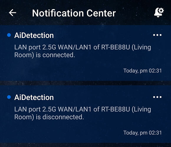

I can see that receiving on my phone notification from the router:
and then new kodi.log is created.
