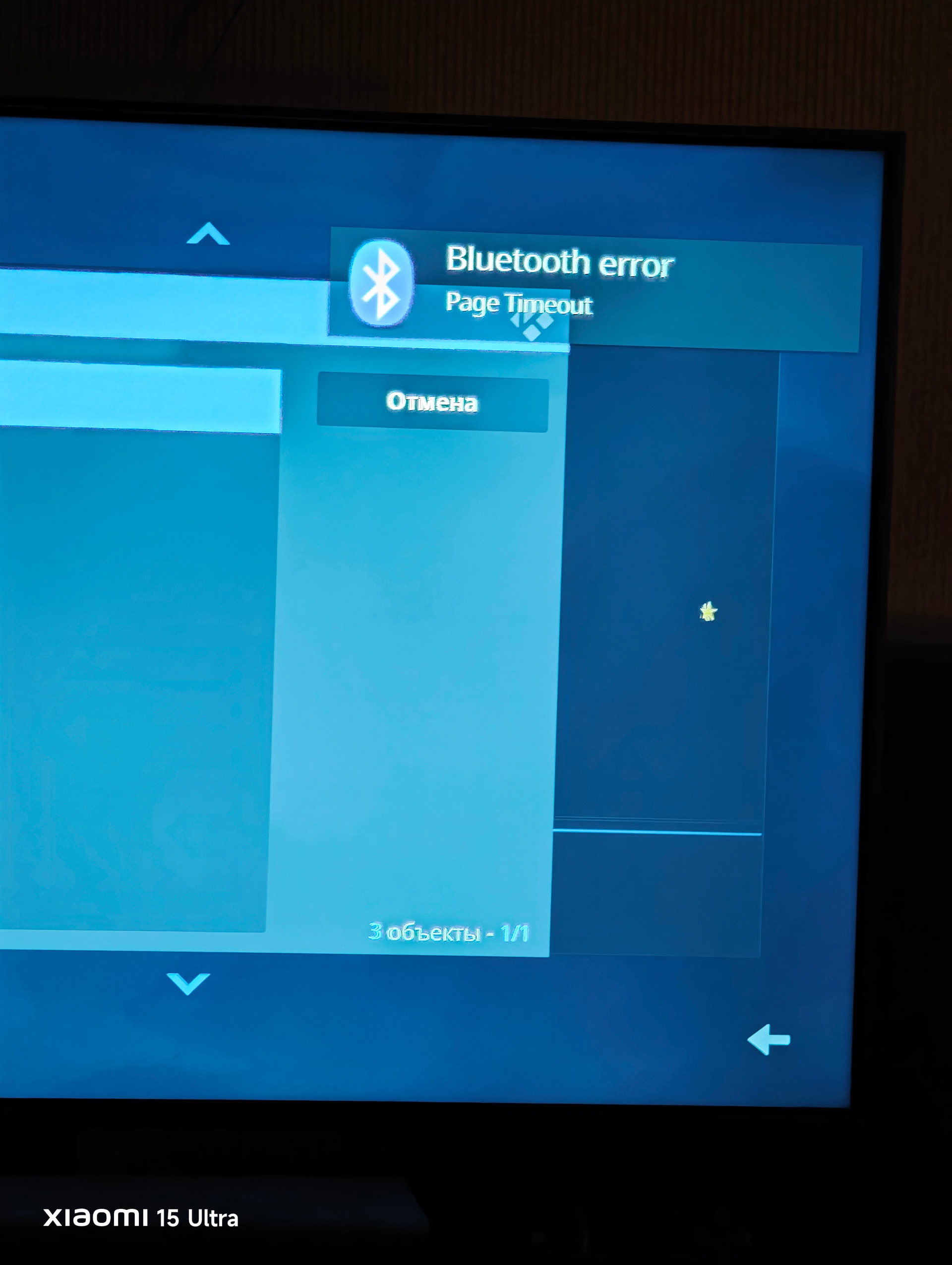

"I’ve updated to the latest build, but Bluetooth is still not working on Ugoos SK1. I’m getting a ā€˜Bluetooth error: Page Timeout’ (see screenshot). Since Bluetooth is unavailable, I have to use the 2.4G USB dongle, which continues to cause hard lockups with the polling Rx Tag fail error in dmesg. It seems both USB-audio and Bluetooth drivers for the Unisoc/S928X SoC are still unstable in this alpha."
