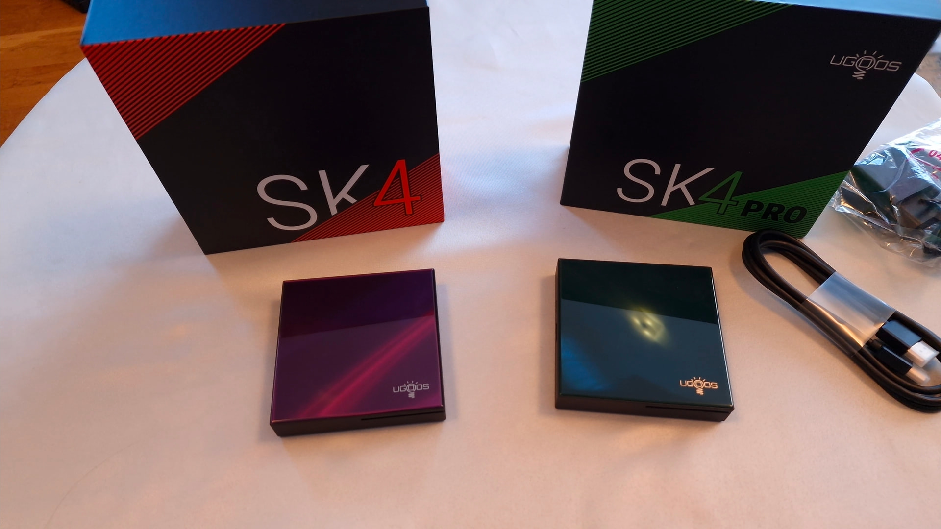

You can see same things we do, boxes are identical.
SK4 Widevine L3, Support Dolby Audio, Dolby Vision.
SK4 Pro Widevine L1, Support Dolby Audio, Dolby Vision, DTS
Pro is green, Non pro purple *I think that’s purple

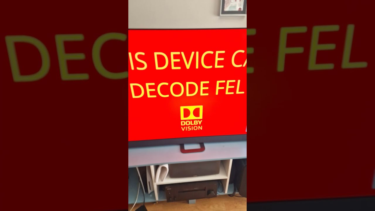

  • DV FEL! Yay :raising_hands:! Thanks to CE devs for this :heart:

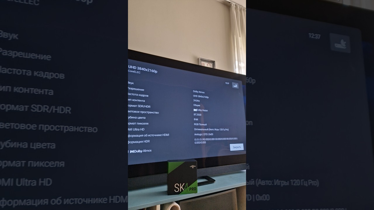

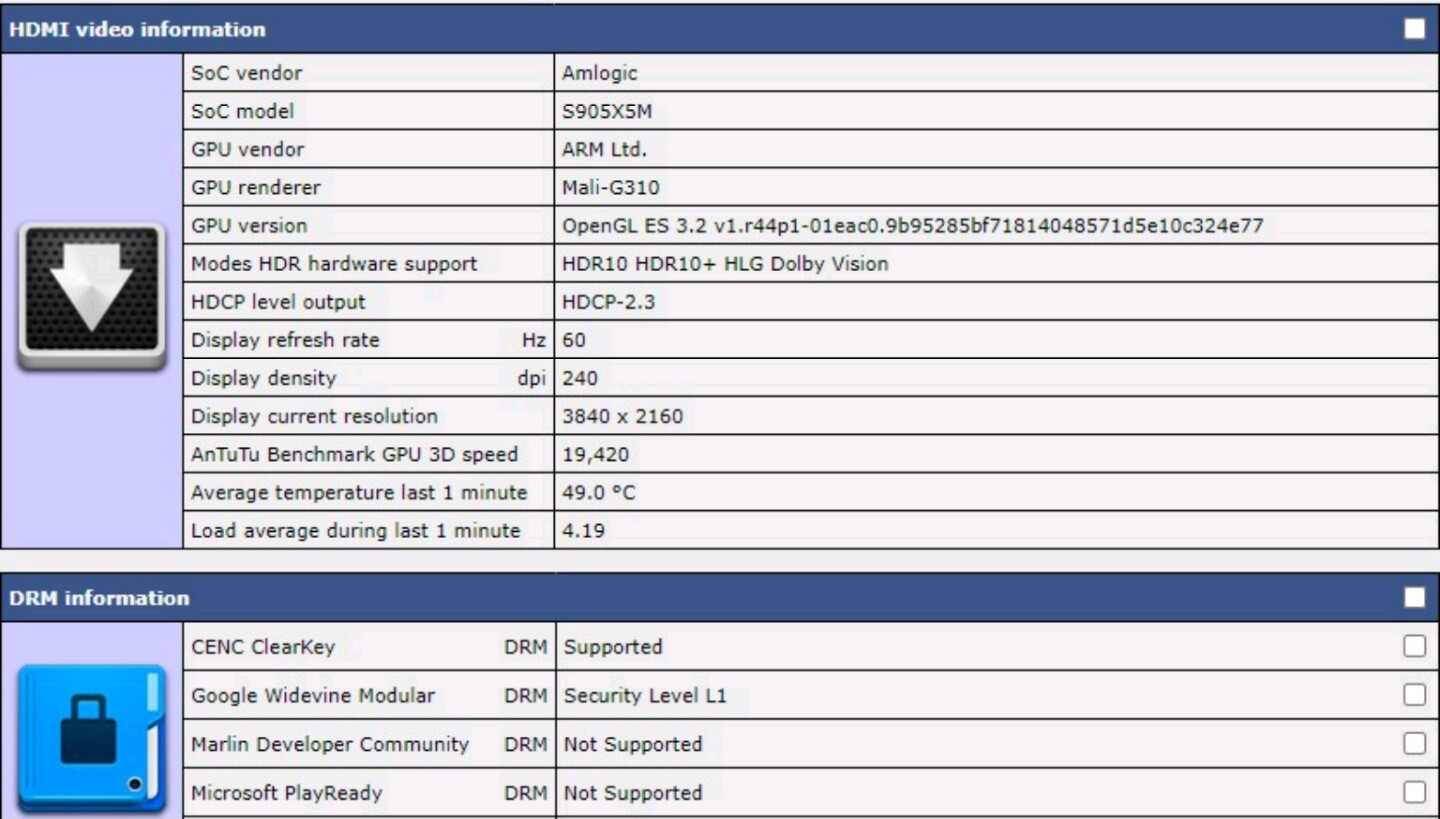

Hello,CE22 works as expected on Ugoos SK4 Pro s905x5m-K,performance is about the same,maybe 1% faster than SK4 s905x5m-J,HDCP 2.3 and Widevine L1 are present,regular SK4 doesn’t have license on board.

The Axagon type c gigabit Ethernet adapter worked fine,I got somewhere around 350/350Mbps,since both USB ports are 2.0. The only issue I got and I am sure it would be fixed in next update,I was unable to play hdr10+ adaptive on my tv,it was output as HDR,so yeah,it would be fixed soon.

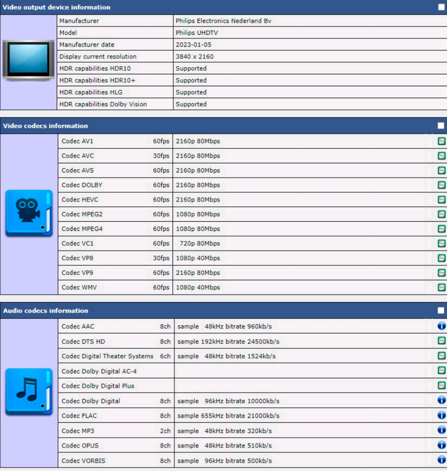

Also here is the list of hardware decoders support by this TV box,green means it’s hardware decoder,blue is software,but any CPU nowadays can handle mp3 with software decoder,so no problems here.
Fel works fine too:
