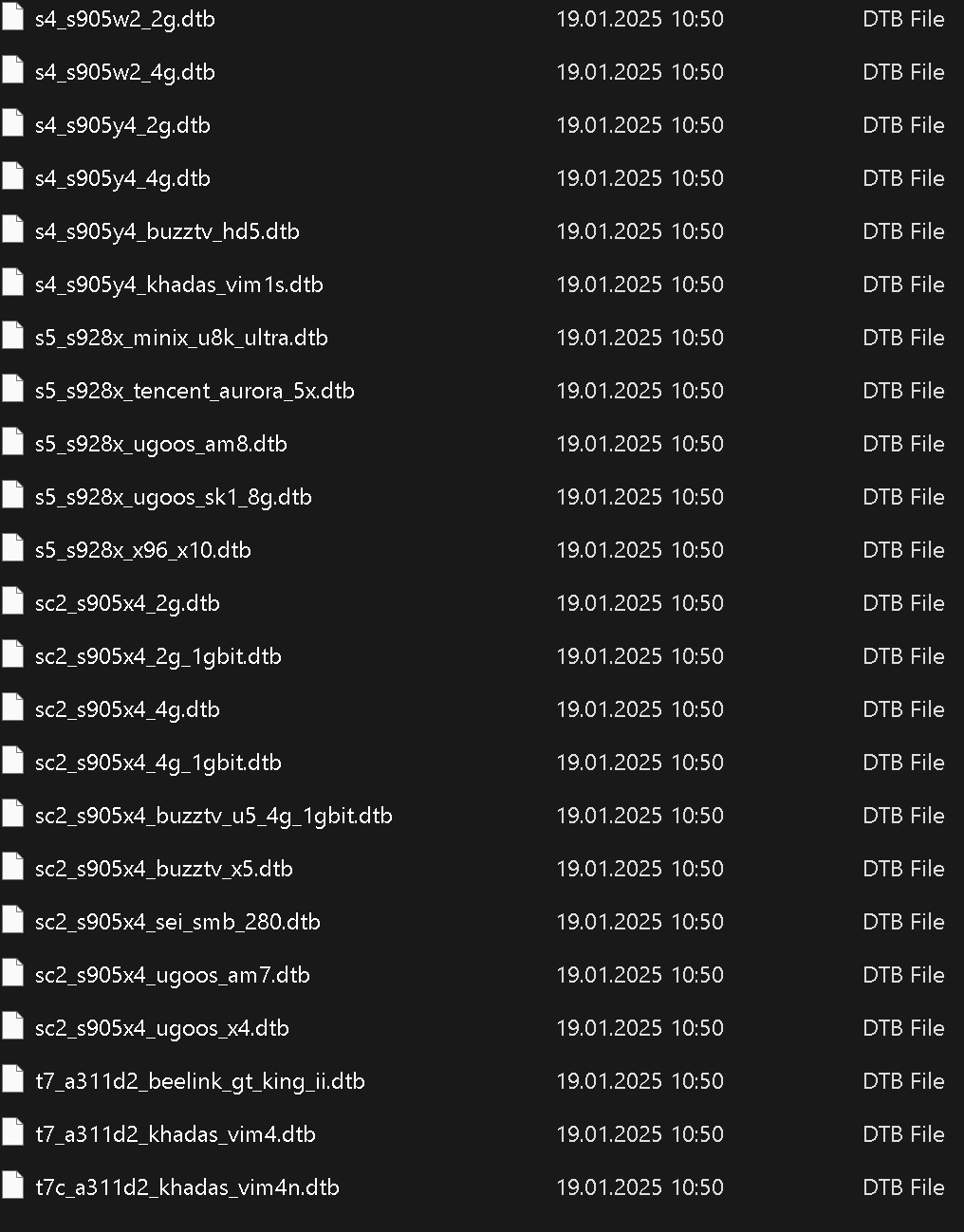

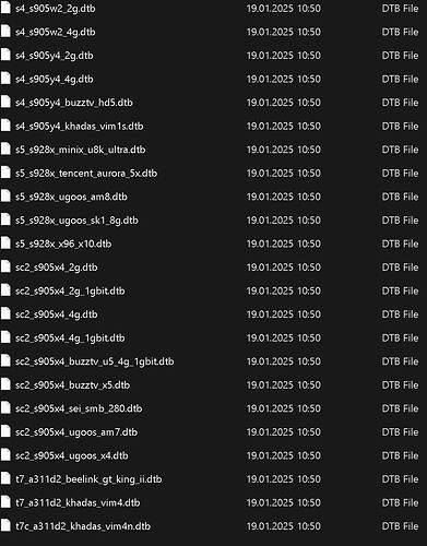

I more and more think this both Ugoos threads should be just locked because they are more and more useless. Are you even familiar with CE images? All the DTB’s supported are available in device_tree folder after USB stick or uSD card is created. If you don’t understand this basic things why are you even trying to boot unsuported device …
There is no s905x5m dtb here
OMG, you have image from 19. january 2025 ???
Do you know when support for this SoC come into CE-22 nightly? Hint: 1 month back!

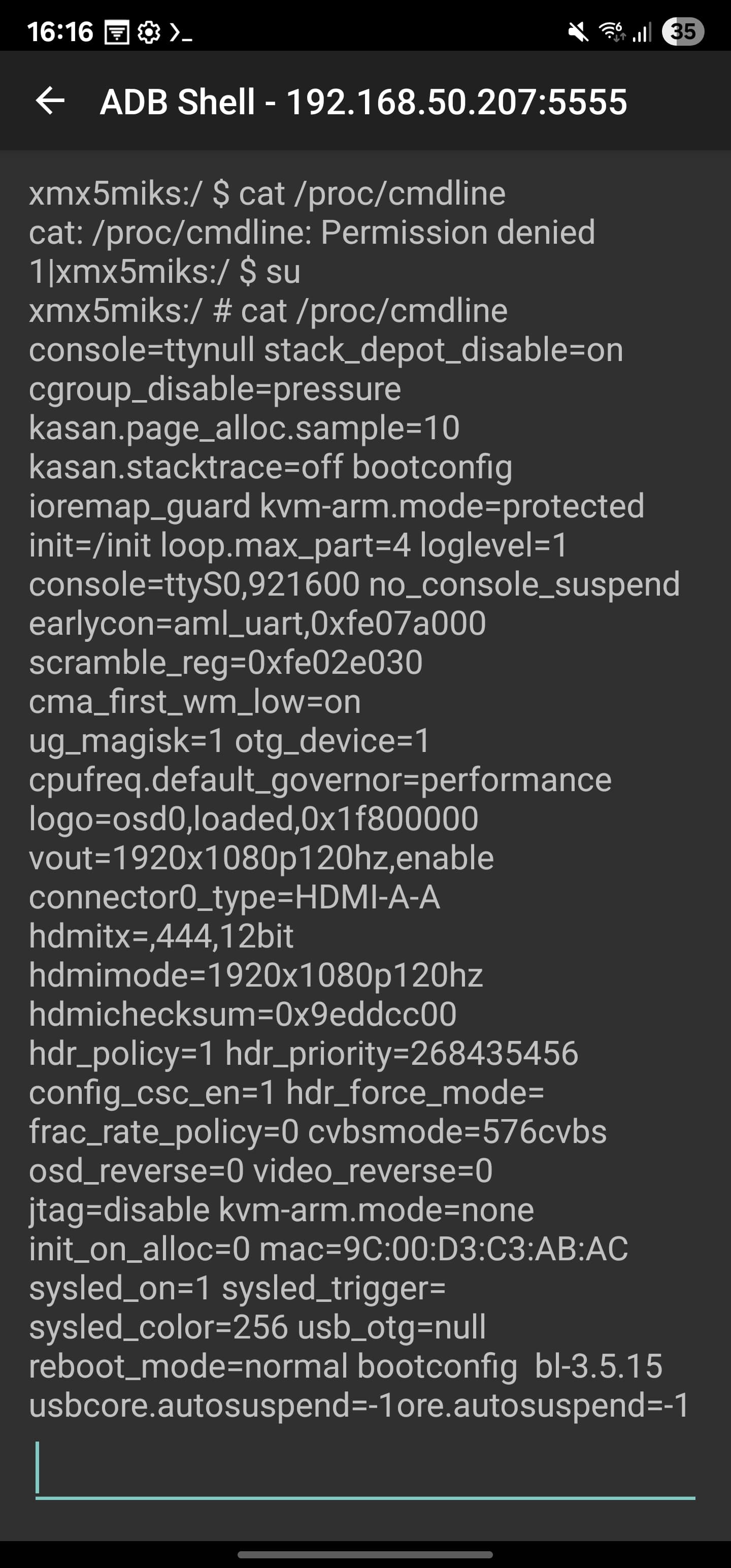

I tried nightly version with s905x5m dtb,still same error,
The log level=1,probably thats why not so much information in console,any clues how to increase log level to 7?
