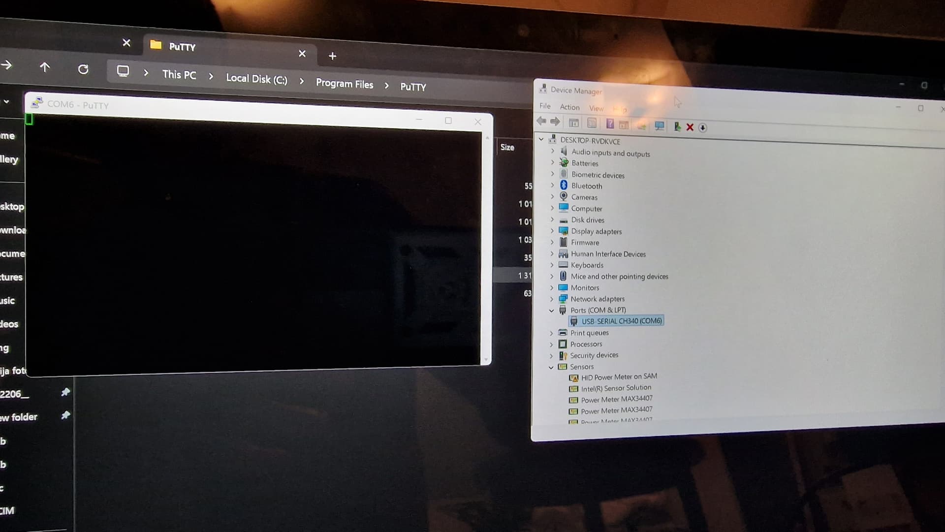

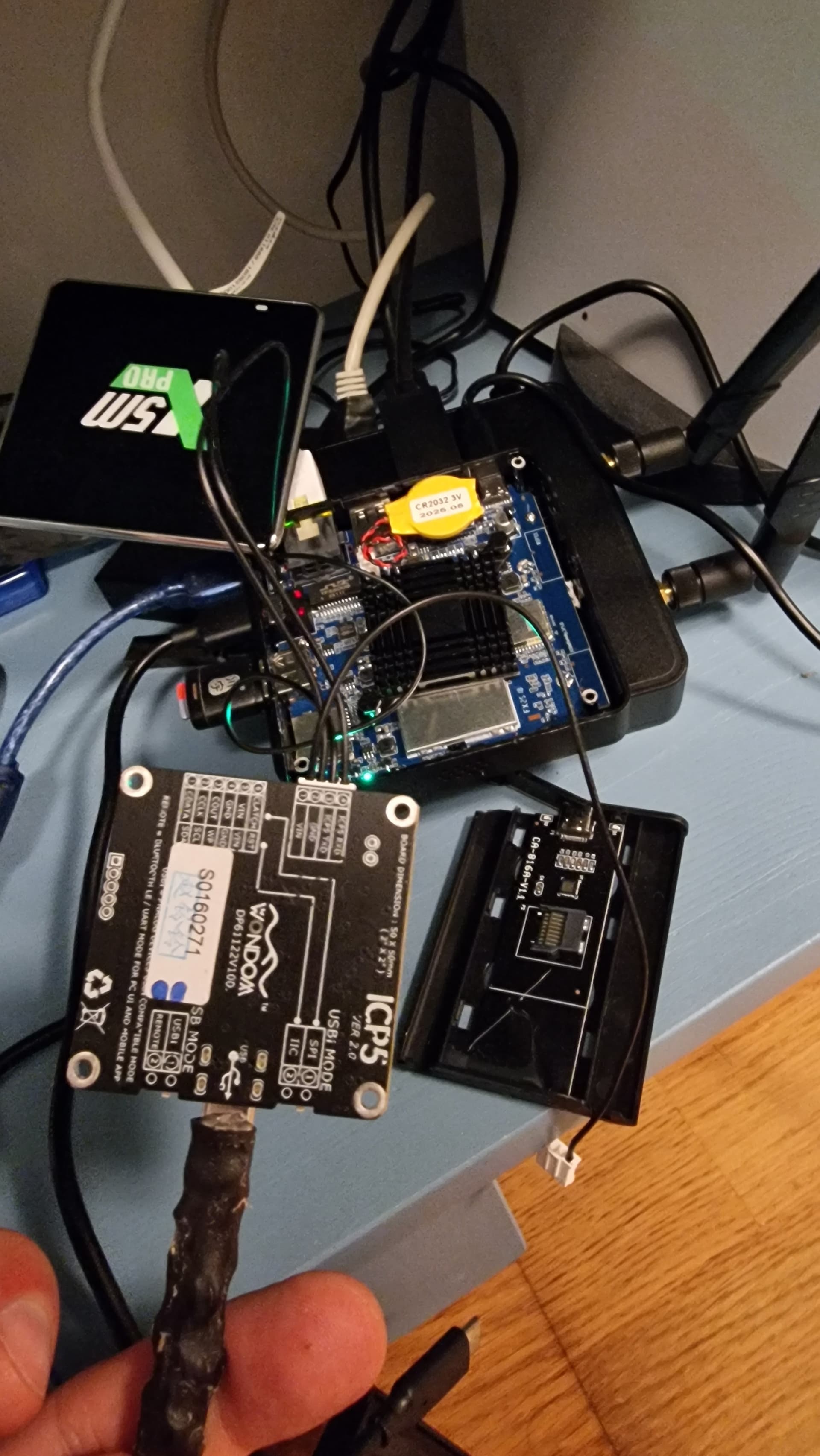

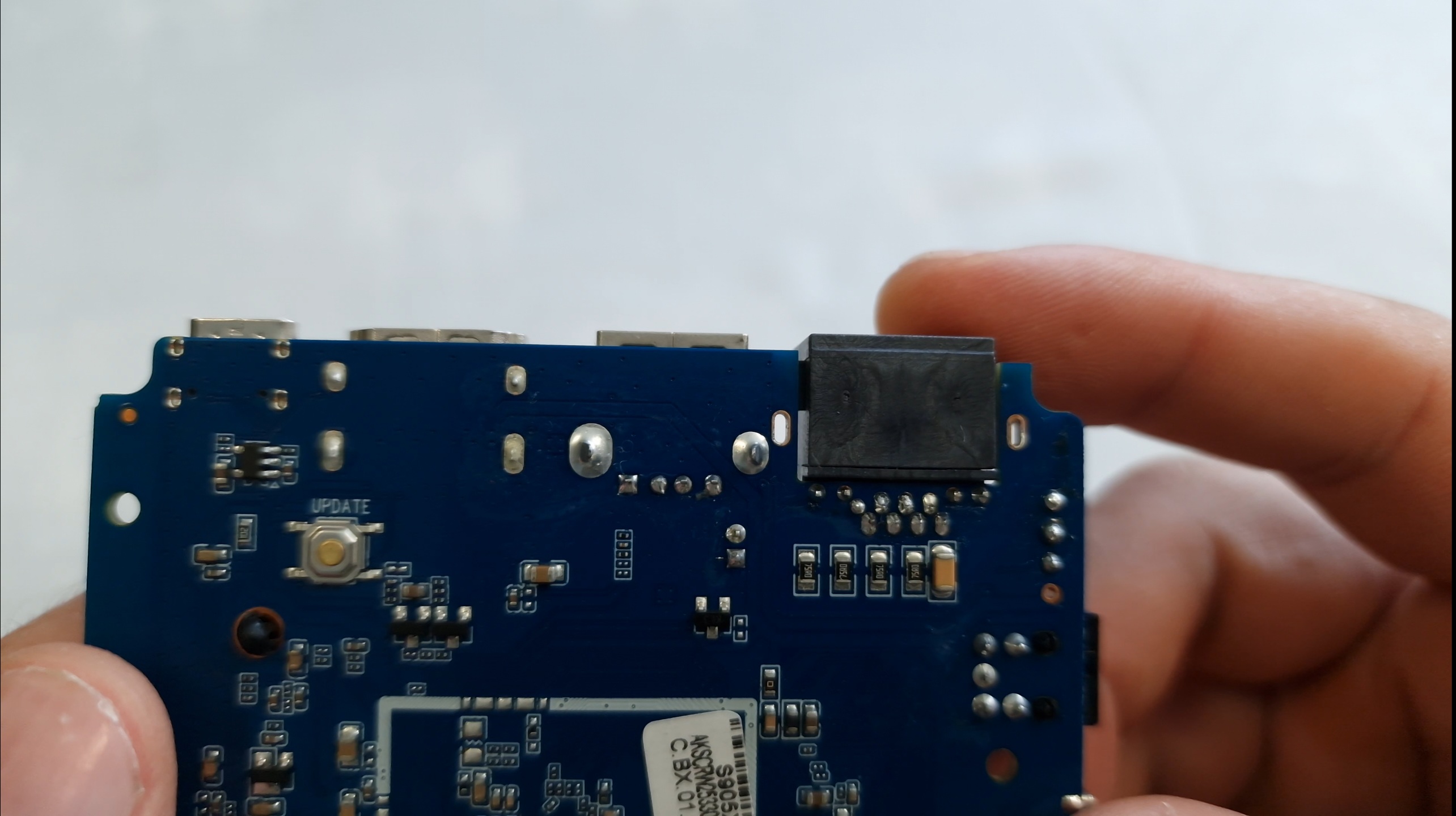

It shows as other devices USBi in windows.

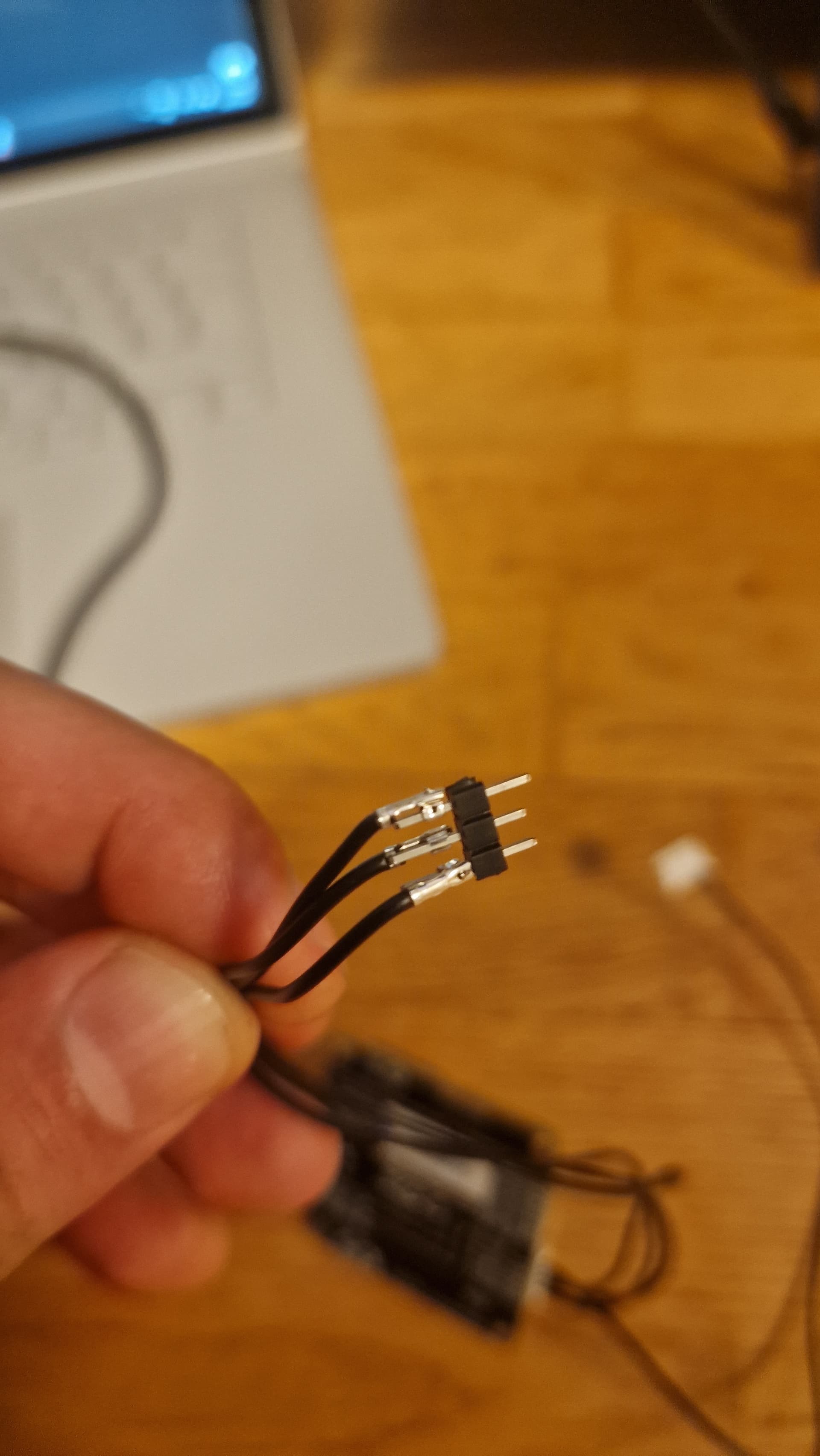

I have it connected but logs dont appear ,tx,rx and ground.
There should be a contact with board,but maybe board is isolated,I am not sure.

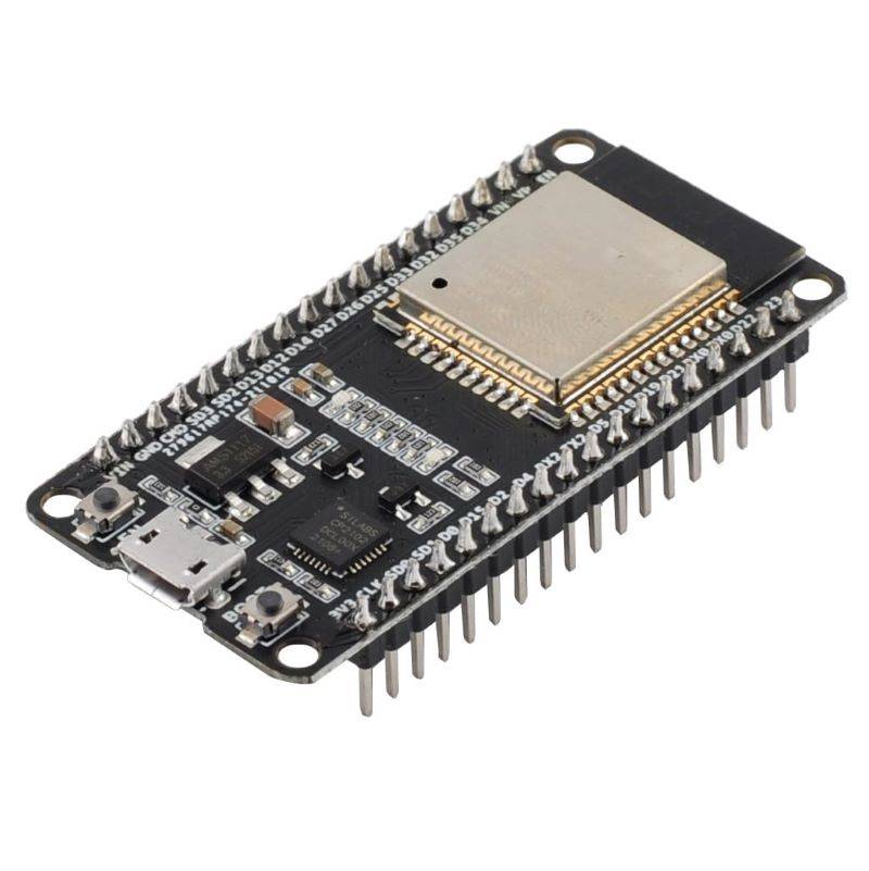

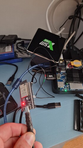

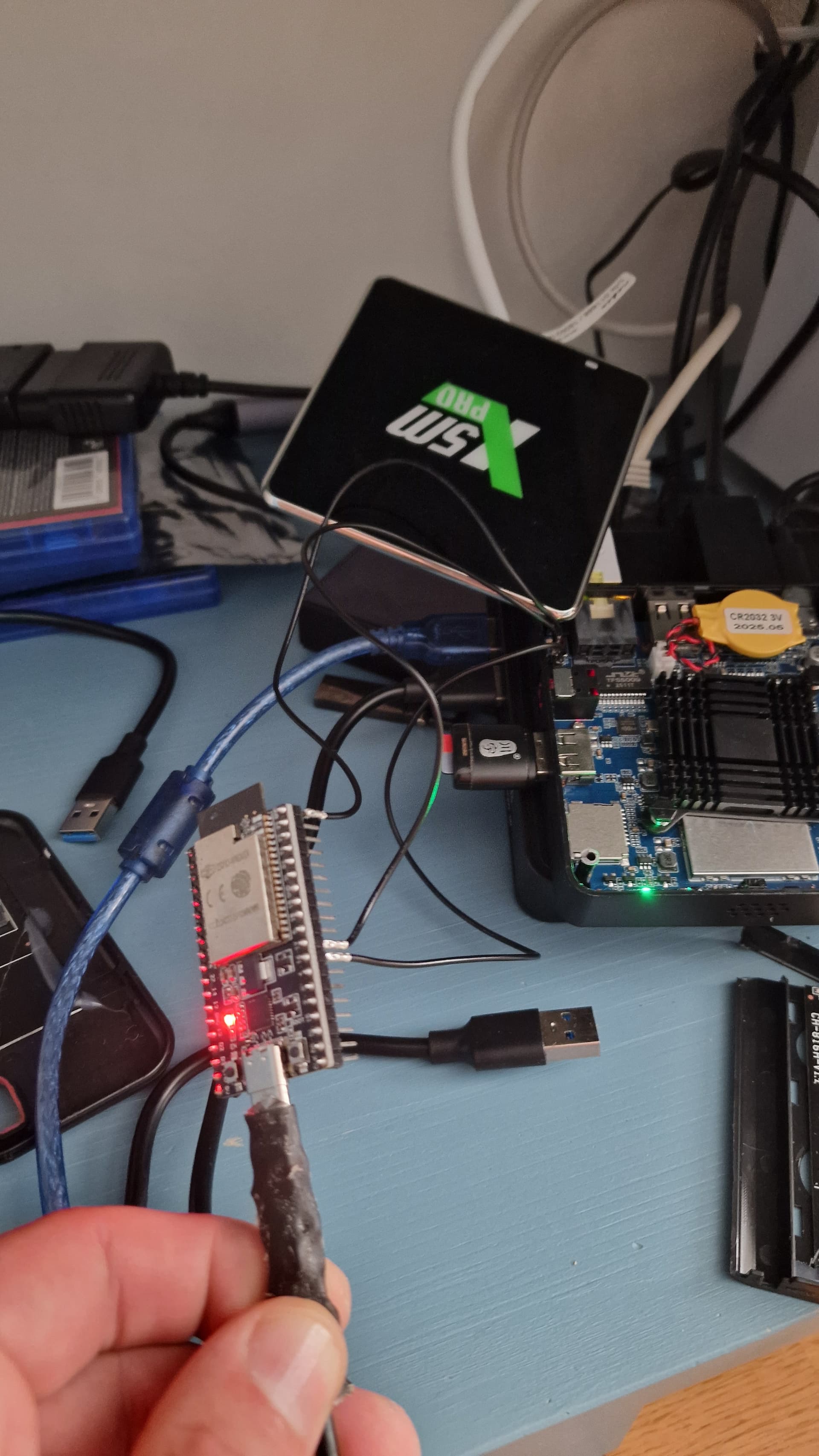

Also I have esp32 wrover module,can i use it as uart adapter ?
I tried flashing this code to esp32
#include <HardwareSerial.h>
HardwareSerial SerialTV(2); // Use UART2 (RX=GPIO16, TX=GPIO17)
void setup() {
Serial.begin(115200); // USB communication (PC ↔ ESP32)
SerialTV.begin(115200); // UART2 to TV Box (adjust baud if needed)
void loop() {
// Relay PC commands → TV Box
if (Serial.available()) {
SerialTV.write(Serial.read());
// Relay TV Box logs → PC
if (SerialTV.available()) {
Serial.write(SerialTV.read());

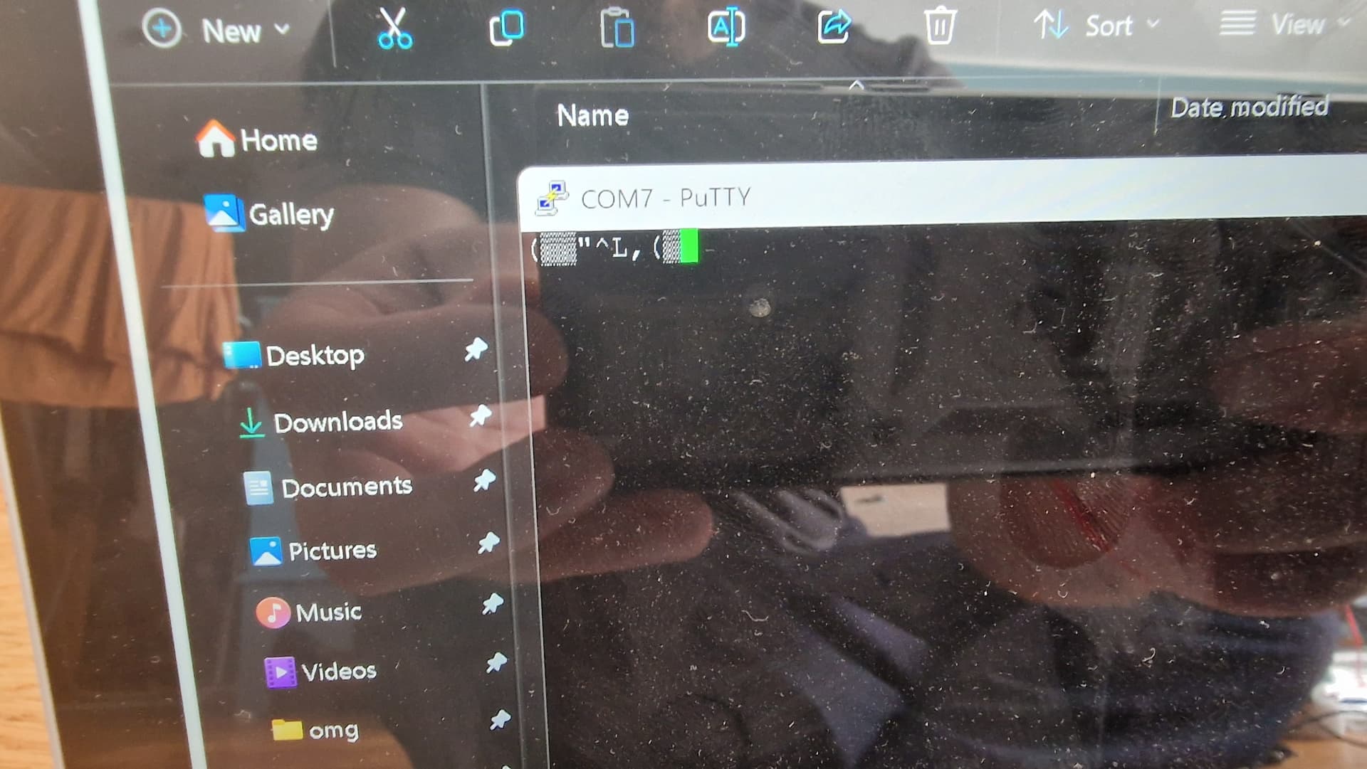

I set baudrate 115200 in putty and no luck,few times some random letters appeared
It is best to remove all external devices connected to PCB
You have every port with something attached, HDMI, Ethernet, all 3 USB Ports looks like etc
Remove all that
All you want is the board with u-art serial adapter soldered to tx,rx,gnd
Connect to Putty
Apply power to Ugoos

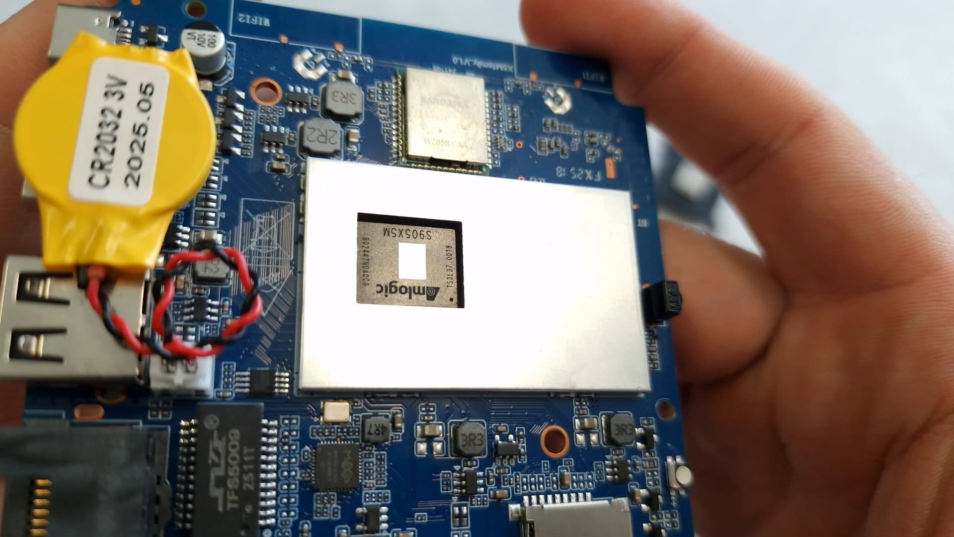

Ugoos X5M pro cpu,for some reason usb host on the unit has only 4 pins[usb 2.0]
And how many pins you need for USB 2.0? More than 4?
It’s just one of usb ports should be 3.0.In my case both 2.0.
Very hard because of
Due to SoC design constraints, there’s no USB 3.0 Super-Speed ​​or PCIe bus built into the chip. As a result, all USB ports on the ODROID-C5 only support up to USB 2.0 High-speed devices.
ODROID-C5 has same SoC.

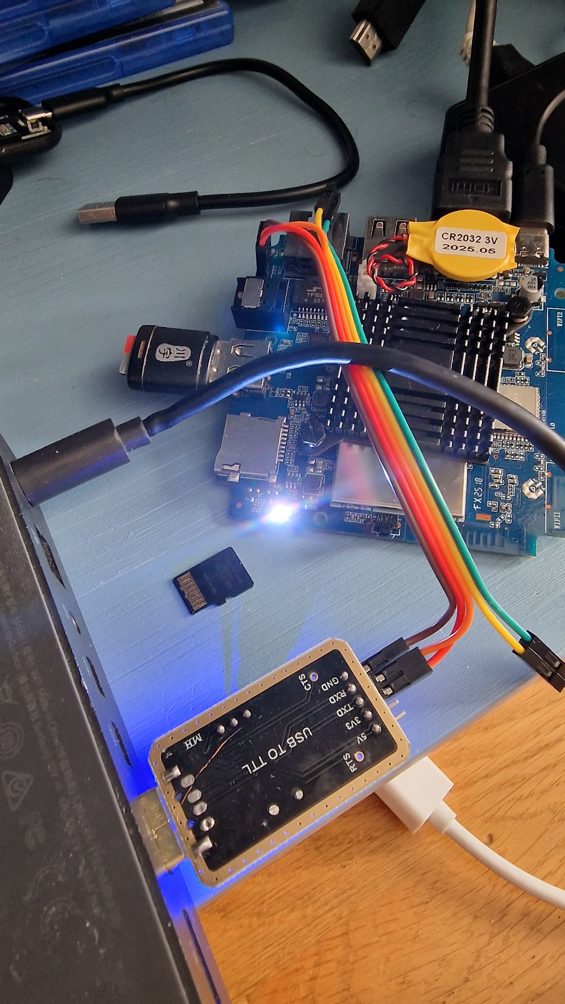

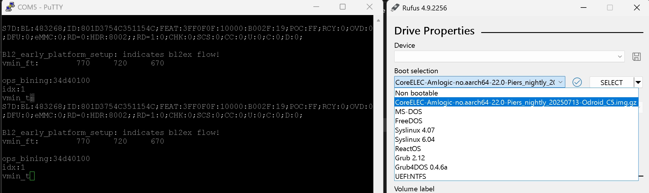

S7D:BL:483268;ID:801D3754C351154C;FEAT:3FF0F0F:10000:B002F:19;POC:FF;RCY:0;OVD:0                                                                                                                        ;DFU:0;eMMC:0;RD-0:HDR:8002;;RD-1:0;CHK:0;SCS:0;CC:0;U:0;C:0;D:0;
Bl2_early_platform_setup: indicates bl2ex flow!
vmin_ft:        770     720     670
ops_bining:34d40100
idx:1
vmin_t▒
ops_bining:34d40100
idx:1
vmin_t
I have this log,they sent me little bit damaged uart adapter,so I am not sure if it works properly,baudrate is set to 921600 rx-tx tx-rx gnd-gnd
I am using this image,flashed it on sd card and tried to run both from usb and micro sd card slot,same result,boots into recovery

and I get this log with this DTB:
S7D:BL:483268;ID:801D3754C351154C;FEAT:3FF0F0F:10000:B002F:19;POC:FF;RCY:0;OVD:0;DFU:0;eMMC:0;RD-0:HDR:8002;;RD-1:0;CHK:0;SCS:0;CC:0;U:0;C:0;D:0;

Are these logs any helpfull? What is the cause of CE boot failure and how to fix it?
The Odroid C5 bootloader isn’t going to boot on the Ugoos x5M, it’s failing immediately because the bootloader signature is wrong/missing.
Flash the generic image, and use the generic s905x5m dtb.

Seems serial console is locked (that’s why it doesn’t show anythig useful?) and maybe also booting from USB is disabled (check if LED on USB stick is on when booting starts). Or try uSD card.
