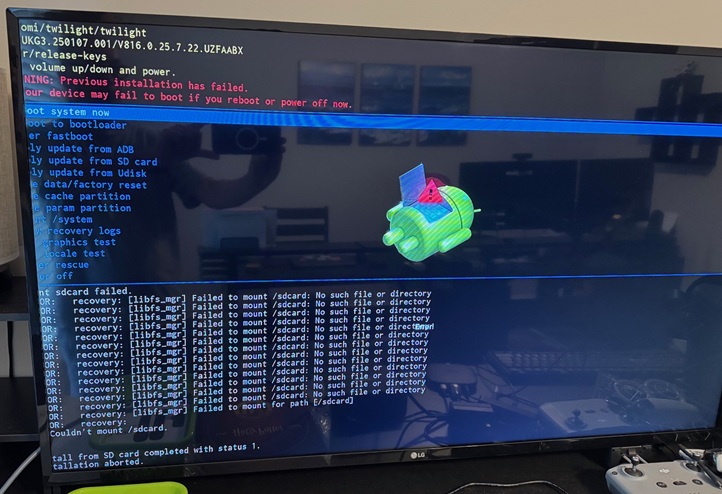

Used this neat tool to reboot into the bootloader. Had CE-NO w/the right DTB on a USB stick, and chose ‘Apply update from SD card’, but got this…
Does this mean CE isn’t installable? Could I try another method? Unlike older Xiaomi boxes, holding down OK + back buttons on remote while powering on doesn’t work, which is why I used the tool linked above.

Just tried and after using the same tool as @1SqueezPlz , I selected the “reboot in bootloader mode”, it reboots but then screen is stuck on the starting screen with the Mi logo.
Gonna try again with some other USB key then will report back here.
You need to try with 20250920 build which has one issue fixed which could prevent booting devices which needs “new” method to change bootloader parameters.
Alright, used latest nighty, still nothing when using “reboot into bootloader” BUT got to the same screen as @1SqueezPlz when using “reboot into recovery” instead.
Now I might sound dumb but it says to use volume up and down keys to select options from menu but my remote doesn’t work (probably because I’m in recovery and system isn’t fully initialized). So I’m stuck on that screen lol… Any idea ? Sorry but as I’ve said before, I’m kind of a newbie when it comes to Coreelec. =/
I got it to work using the adb command '“adb reboot update” instead (still using the program mentioned above). CE installed correctly and I got to the screen when CE asks to perform first setup. But unfortunately my remote doesn’t work anywore on CE and I don’t know what to do, I don’t even have a second USB port on the Xiaomi box to use a controller, keyboard or something and I can’t emulate a remote with the program because the box isn’t connected to the Wifi anymore (makes sense, CE being just installed, it can’t connect itself to the Wifi alone lol).
I’m stuck but at least now we know CE works on the Xiaomi TV Box 3rd gen.
