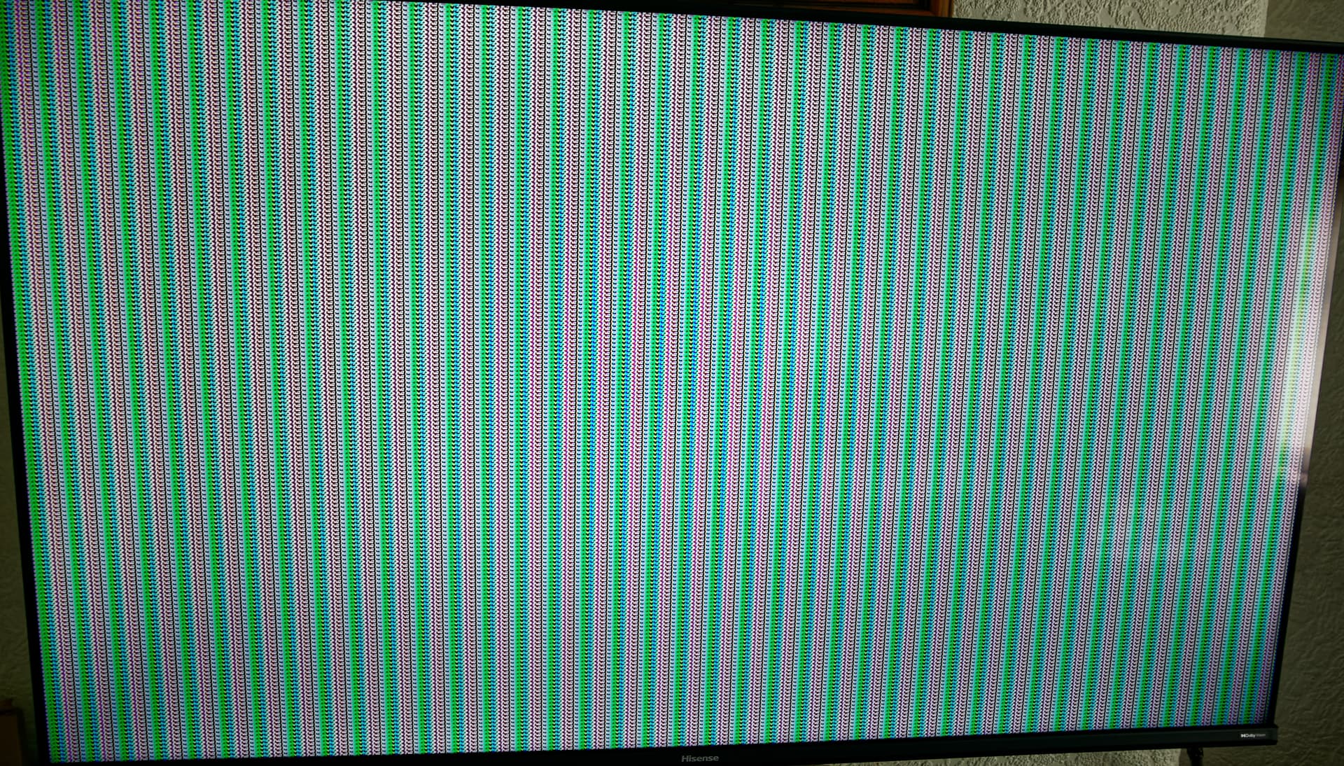

When CE 19.4 is loaded on both boxes, playback is perfect. When trying CE 19.3, playback on one device is perfect (the device where bluetooth does work) and on the other device (bluetooth does not work), playback consists of fixed vertical red, green and blue lines with dots interspersed - audio is present and ok.

Well, there’s good news and bad news I suppose. Good news is that my “bad” box is now running firmware 20190906 (same as good box and apparently the latest firmware), and BT is working under android. So, I have 2 fully functioning android boxes. The bad news is that I get the same playback issues (using CE) on the “bad” box as I had before when using the 20190109 android rom. As @Shoog suggested, this must be some funky kind of hardware issue. The different android roms appear to have no impact on CE playback.
All using hardware decoding - software decoding 100% perfect. Using same TV and HDMI cable. (Tried different HDMI cable - same results).
  1. CE 9.2.5 playback perfect on both boxes for HEVC (8 and 10-bit) and H264.
  2. CE 9.2.6, 9.2.7 and 9.2.8 playback perfect on “good” box. Only H264 plays back on “bad” box. (see HEVC image below)
  3. CE 19.4 playback perfect on both boxes for HEVC (8 and 10-bit) and H264.
  4. CE 19.3 playback perfect on “good” box. Only H264 plays back on “bad” box. (see HEVC image below)
I’ve never experienced a case where playback depends on the version of CE with apparently the same boxes.
So, H264 is always good, but HEVC playback is dependent on the version of CE on the “bad” box.
Under android all H264 and HEVC files playback perfectly.
Attached is image shown on the “bad” box with CE 9.2.6, 9.2.7, 9.2.8 or CE 19.3
So, thanks very much for your help and I guess we’ll put this down to a substandard manufacture or a bad clone?? I can’t find any logic as such, but at least quite a few versions of CE do work 100%.

Had my 19.4 and 19.3 the wrong way round. Perfect playback on CE 19.4 both boxes, but on CE 19.3, playback issue on “bad” box (i.e. HEVC - no, H264 - ok). So it would appear that since CE 19.4 we are back on track.
