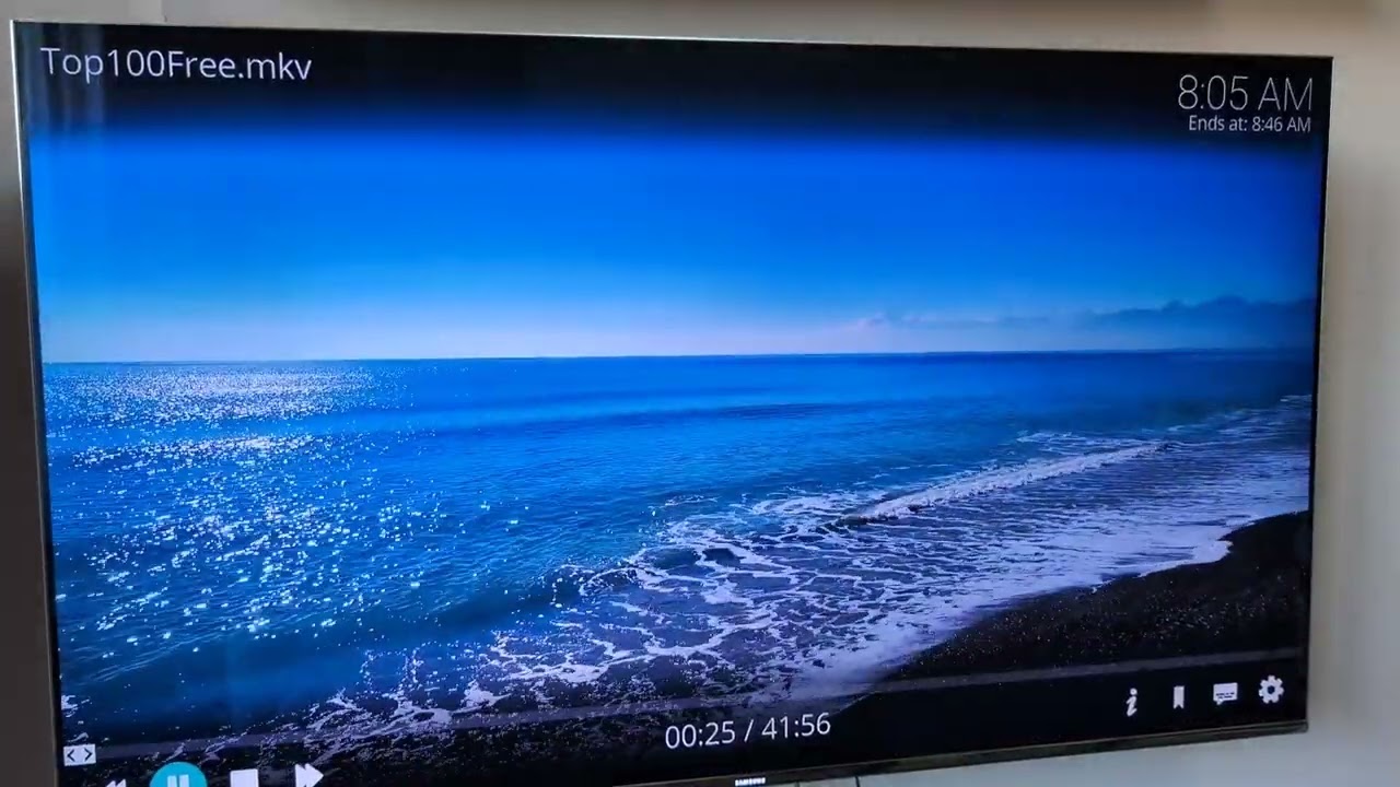

I have problems playing VP9 content with CoreELEC 21.1.1 on Khadas VIM1S – the picture gets distorted on some specific parts of the video and also when using the Kodi interface while the video is being played. I have recorded a short video while reproducing the issue:
Distortions appear at 0:11 and then on each key press while using the Kodi interface.
The file I am playing is available here. This is the ffprobe info:

This is a clean install of CoreELEC 21.1.1 on VIM1S. The debug log is available here: https://paste.coreelec.org/GraniteBarbaric
If you need any other information, I’d be happy to provide it. Thanks in advance!
