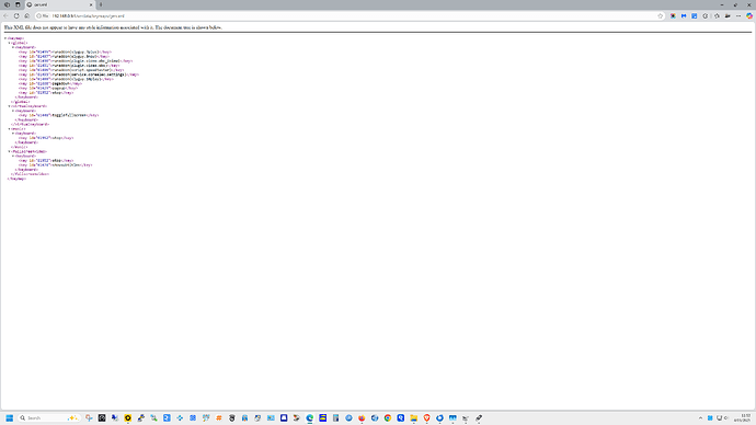

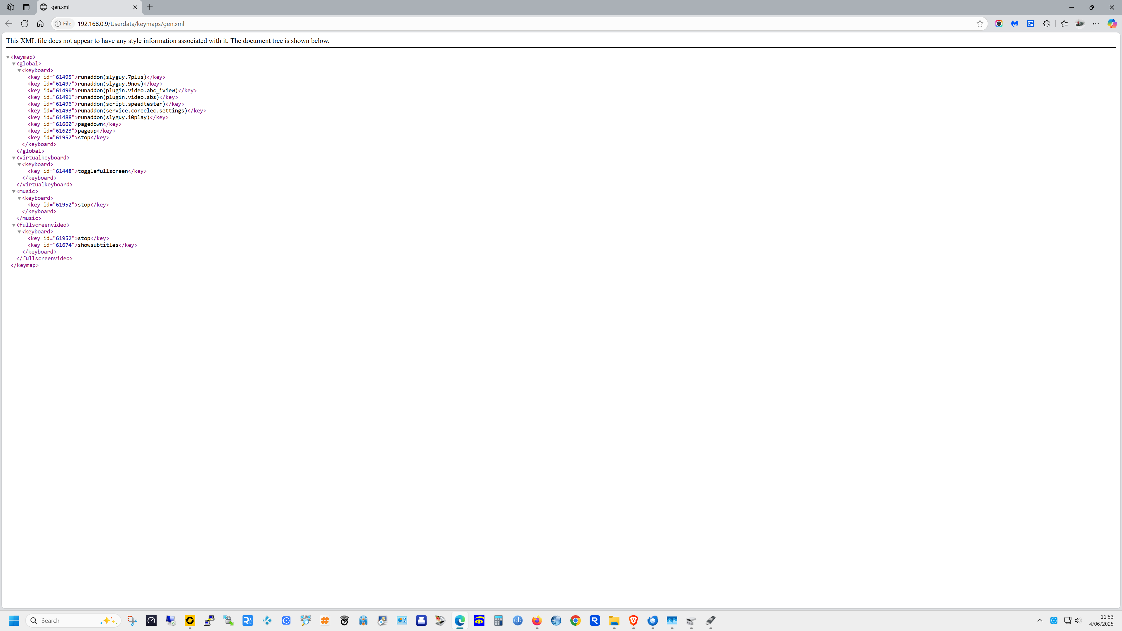

That is what is my pic above but you need to open it to see :slight_smile:
Using the Keymap Editor, I assigned the key on the IR-Remote to the virtual keyboard, opened the file gen.xml and I made sure that there was an entry similar to the one in your picture. But when you press the key, nothing happens anyway.
