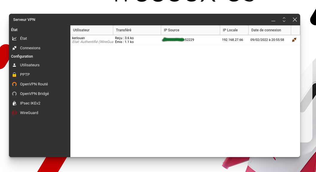

Here is the established connections page on my home internet box (WG server):
I hid the holiday home external IP.
The holiday home CoreELEC can ping all clients on its LAN and the “local IP” address (192.168.27.66), it can’t ping any other machine at the end of the tunnel (home). There is obviously a routing problem but I can’t solve it without the input of someone more savvy than me in these matters.
