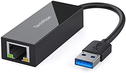

I took a punt on this USB gigabit NIC, plugged it in and it worked straight out the box. Played a 100mbit 4K test file and my server reported over 300mbps traffic during the initial playback, then dropped down to 100mbps, no stuttering.
From dmesg output, can you find out what USB3/NET chipset device uses?
It’s a realtek 8153
