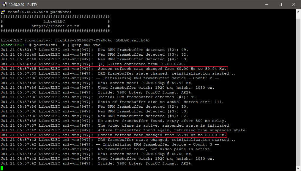

I would like to know if there has been any progress in investigating the bug reported in the aml-vnc topic?
Since the bug affects the CoreELEC DRM stack and not the VNC server, any feedback from the developers would be appreciated. Thanks in advance.

I see the same issue with the youtube plugin, about 5s in the video changes framerate and (for me) a grayish image is seen and audio keeps playing but as soon as press pause on my remote the normal image is seen again. This may happen multiple times during playback.
I think the bug is in the FRAC_RATE_POLICY handling, and I suspect there is a point where Kodi is not notified of an actual frequency change. I handle this case separately in AML-VNC (this is also visible in my vnc server log), but it is possible that at some point Kodi is not notified of this change, because there is actually a case here when it changes from integer to fractional, or vice versa, during video playback. In the case of CE, only the FRAC_RATE_POLICY property value changes, while the frequency value remains unchanged.
However, since the bug was attributed to the addon, no one is actually investigating it at the moment.
Edit: Unfortunately, moving this bugreport to the other topic proves that no one wants to deal with this bug. The bug is in the DRM implementation, not in the addon. This bug does not occur under LE13 when using the AMLGX image. However, there is no FRAC_RATE_POLICY under the mainline kernel. So now, what should be the next step?

This is unfortunately a false statement, and I can confirm this with the frequency calculation in AML-VNC. LE13 provides correct values ​​via DRM, and there is no FRAC_RATE_POLICY property there, like in the Amlogic BSP kernel.
The formula for calculating the frequency is just this:
refreshRate = (double)(crtc->mode.clock * 1000 * scanFactor) / (crtc->mode.htotal * crtc->mode.vtotal * drm_getFracRate());
The value of scanFactor is 2 for interlaced scan, and 1 for progressive scan. drm_getFracRate() is interpreted for CE, which returns 1.001 if FRAC_RATE_POLICY is true, otherwise 1. (It returns 1 even if the property is missing, e.g. in the case of LE.)
In the case of LE13, this always returns the correct frequency value even without the FRAC_RATE_POLICY property, and after the second (fractional) change there is no bug, and the video is displayed immediately without any issue.
Therefore, the basis of the problem is that FRAC_RATE_POLICY is not a basic DRM property, so its handling is added to Kodi by CE afterwards. Thus, if this is not included in the frequency calculation at a critical point, it actually returns a false frequency. For example, according to DRM, the frequency change from 60 Hz → 59.94 Hz remains 60 Hz throughout, only the value of FRAC_RATE_POLICY changes. So, if a trigger monitors the actual frequency change, it will not indicate it here, and that is quite a problem.
Of course, I still don’t mean to say that you absolutely have to solve this, I just wanted to point out that if the bug is in the addon, why don’t I experience this error on other platforms at all? So your previous theory unfortunately seems incorrect.
