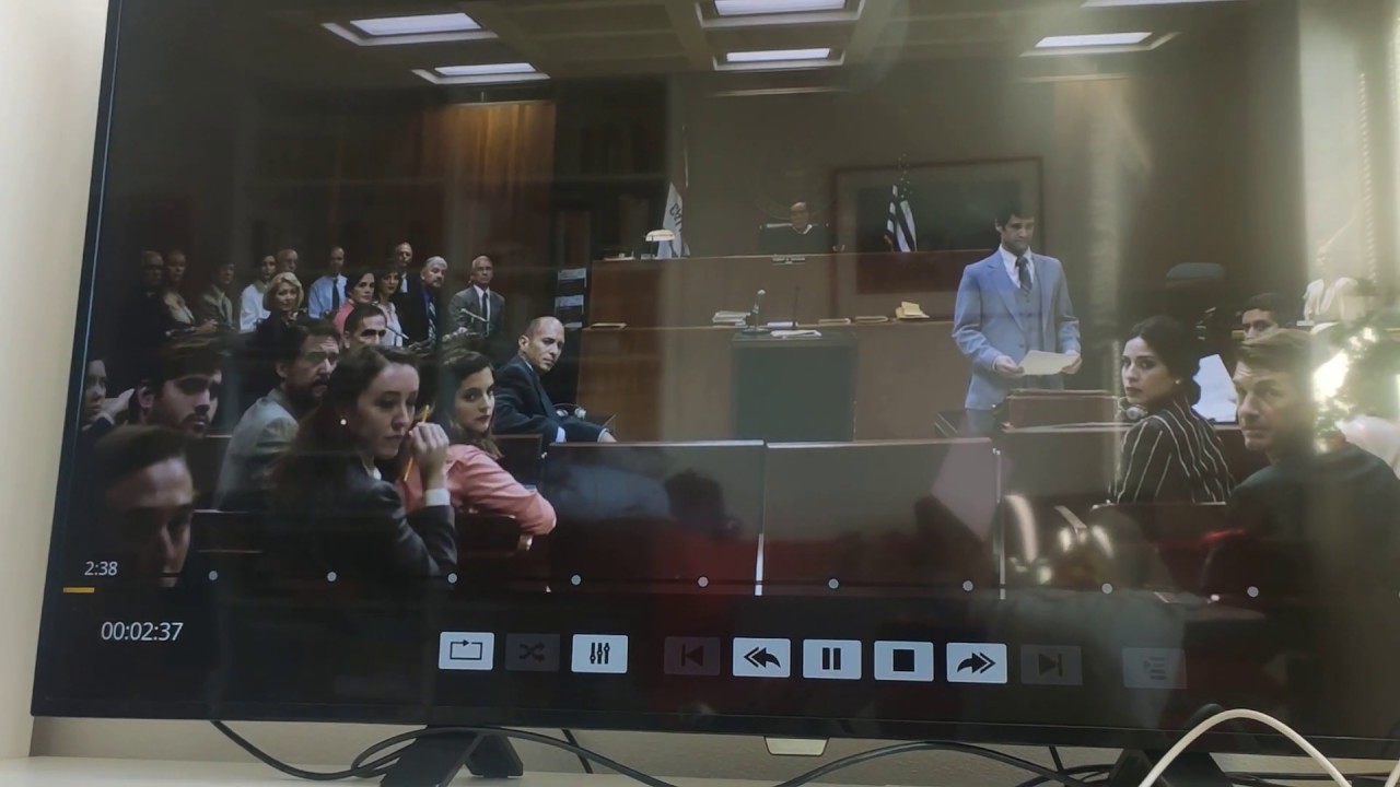

At the end of the video you can see another issue i’m having.
Audio delay on seeking is both with passtrough enabled and disabled.
Tried this on multiple TVs - both hiend and the low end one in video that is basically monitor.
That audio delay i’ve seen using my Vims and hasn’t really bothered me.
The crap at the end of video is something i don’t recall ever seeing on this forum.
