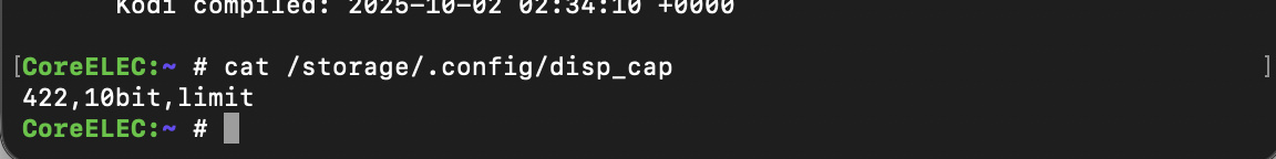

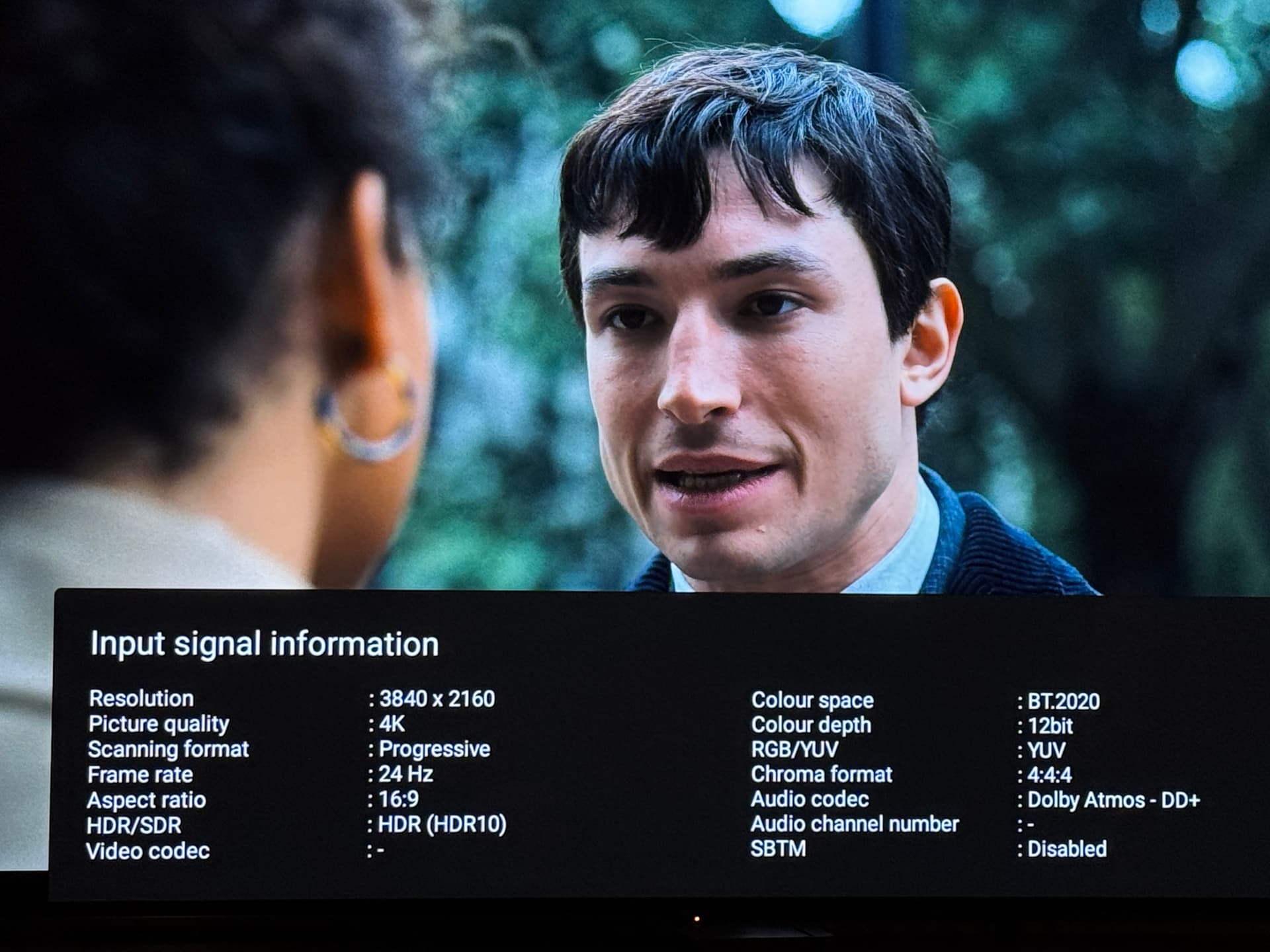

The HDR setting on my TV is set to Auto. On my Android Ugoos device, it’s set to Dolby Vision LED TV. After doing some research, I found that Sony Bravia TVs have a handshake issue when the device is set to 4:4:4 or 12-bit. As I mentioned earlier, the best setting for Sony Bravia OLED seems to be 4:2:2 10-bit.
However, setting it through the GUI (Force Display and Force Colour Sampling) isn’t enough; it also needs to be applied using SSH commands.
If the display shows anything other than that, it doesn’t work properly. To fix this, I created an autostart file with a full HDMI restart. For now, everything works fine. Let’s see how long it lasts, but the picture quality in both HDR and Dolby Vision looks natural and very good.
Interestingly, in the HDR settings it still shows 4:4:4 12-bit (as well as in the CoreELEC player display), but when checking through SSH, it shows 4:2:2 10-bit. So I believe this is the correct color format for the TV.
To apply the correct setting, use the following command:
echo “422,10bit,limit” > /storage/.config/disp_cap
Then confirm it with:
cat /storage/.config/disp_cap

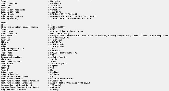

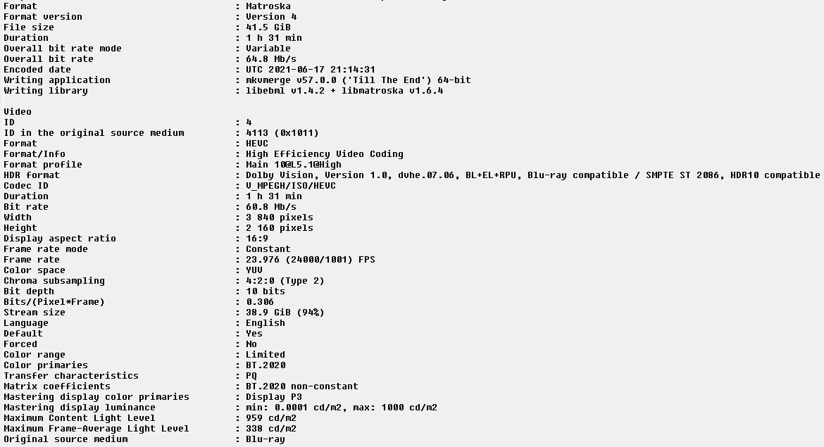

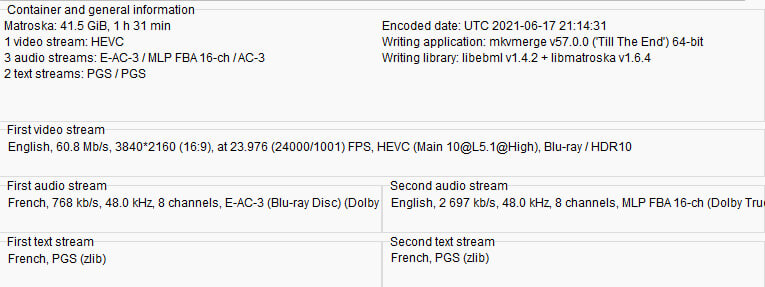

I have obtained some sample from somewhere, some test files.
The other try I can make, but not now because past all day and this is not stable at all :
1- Is to remove Vertex2, but I will be able to get LLDV, but I will be able to test the samples.
2- Test Kodi Nightly on Ugoos OS Android 9 and look also if bitstream is working.
Sample :
4K60p.mov randomly make balck screen, need to turn off the device.
First_8K_Video_from_Space_-_Ultra_HD_VP9.webm not working but I have the GUI to select another sample.
HDR10+_Sample_Video.webm working badly
Sample Captain America- Brave New World (2025).mkv → Ok
SM Eagle beak P8 DV LLDV Chroma Weight TEST (REAL SCENE 3422nits) positive value.mp4 → Ok but depend DV settings
strobe_scientist.mkv → failed
cut.1080p.x265.mp4 choppy and cut3.1080p.x265.mp4
”Nobody” movie crash/failed when using DV :
