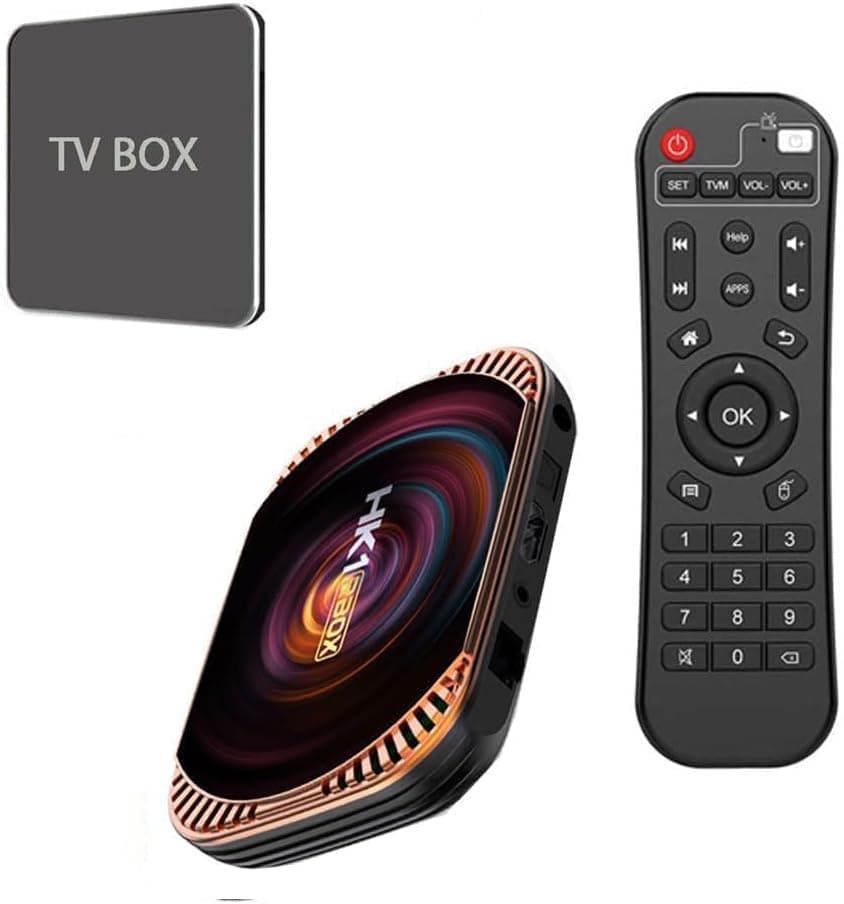

Concurrently testing NG and NE releases. The NG and NE work but they are sluggess on 4K movies from the NAS.
On Amazon special Amlogic S905X4 Android 11.0 TV Box - 4GB RAM, 64GB ROM, Dual-WiFi 2.4GHz/5GHz, BT, Quad Core 64 Bits, 3D/8K, 1000M Smart Box purchased February 16, 2023.
With DTB sc2_s905x4_4g_1gbit.
Wireless, Ethernet Port and Bluetooth all working fine.
Initially restored my old add ons, NFS mapping and remote.
Decided to test simple and noticed this nightly keeps rebooting once it is running for a few seconds or so.
Can I pull the SD card and use the logs present there?

Team CE have indicated that they will only support S905X4 boxes running Android 13 or later for CE22 due to Amlogic enforcing newer ucode requirement on the Amlogic 5.15 kernel
CE22 will run on boxes with older Android but will not decode AV1 and VC1
CE21-NE runs on fine with AV1 and VC1 hardware acceleration on these boxes and Team CE have indicated that there wont be a CE22-NE release. The last CE22-NE nightly they worked on was from Dec24 which now seem to have been removed from archive.coreelec.org.
So your best bet for the Android 11 TV Box is to stick to CE21-NE or if you want CE22 get a S905X4 device running Android 13 or above
