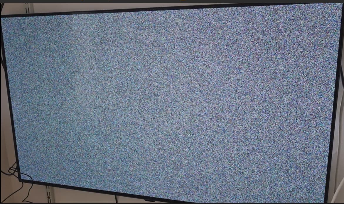

My Minix Neo U22-XJ boots into a white noise screen (static) with CoreELEC-Amlogic-no.aarch64-22.0-Piers_nightly_20250526-Generic.img.gz and using g12b_s922x_minix_u22xj.dtb.
I’ve tried two sd-cards. Any ideas how to diagnose?

Try older version from archive 2024, question is if your hardware works with older kernel . Less issues was in this older time.
https://archive.coreelec.org/Amlogic-no/CE-22/20241220/
Helped it ?
Maybe you need to use rev_a DTB.
On Minix there is no multidtb possible to use.
There are more than 30 u22j (max) online.

I couldn’t see a flashable image there so I just copied g12b_s922x_minix_u22xj.dtb from CoreELEC-Amlogic-no.aarch64-22.0-Piers_nightly_20241220\3rdparty\bootloader\device_trees into root of the original CoreELEC-Amlogic-no.aarch64-22.0-Piers_nightly_20250526-Generic.img.gz image sd-card - and it booted!
In detail, the Minix splash screen showed, then the familiar white noise screen briefly, then the Corelec ‘New Order’ logo with the partition resizing progress txt, then it rebooted again, and the setup process started.
I’ve no idea if what I’ve done is correct however but at least it boots. Happy to obtain logs etc. if that helps to fix the newer builds.
I have also briefly white-green artefacts (screen noise but in green white and black color ) in boot time at ugoos am6plus with cpu s922xj. You must be now happy due to success booting. Nobody know a reason for this artefats at builts of CE22NO with newer kernel.
yes try put here all logs. Your bootloader is not encrypted than on my device from ugoos. Maybe is same reason which would be better identified through your device.
I checked coreelec:debuglogs [CoreELEC Wiki] but all the methods seem to need CE/Kodi to have booted, and of course it sticks at the static screen before reaching CE. How do I obtain any debug info?
Mine looks like this:
my booting of ce22NO looks like this:
The only ‘rev_a’ I could see in devicetree of CoreELEC-Amlogic-no.aarch64-22.0-Piers_nightly_20250526-Generic.img was g12b_s922x_minix_u22xj_max_rev_a.dtb and mine is not the Max model.
