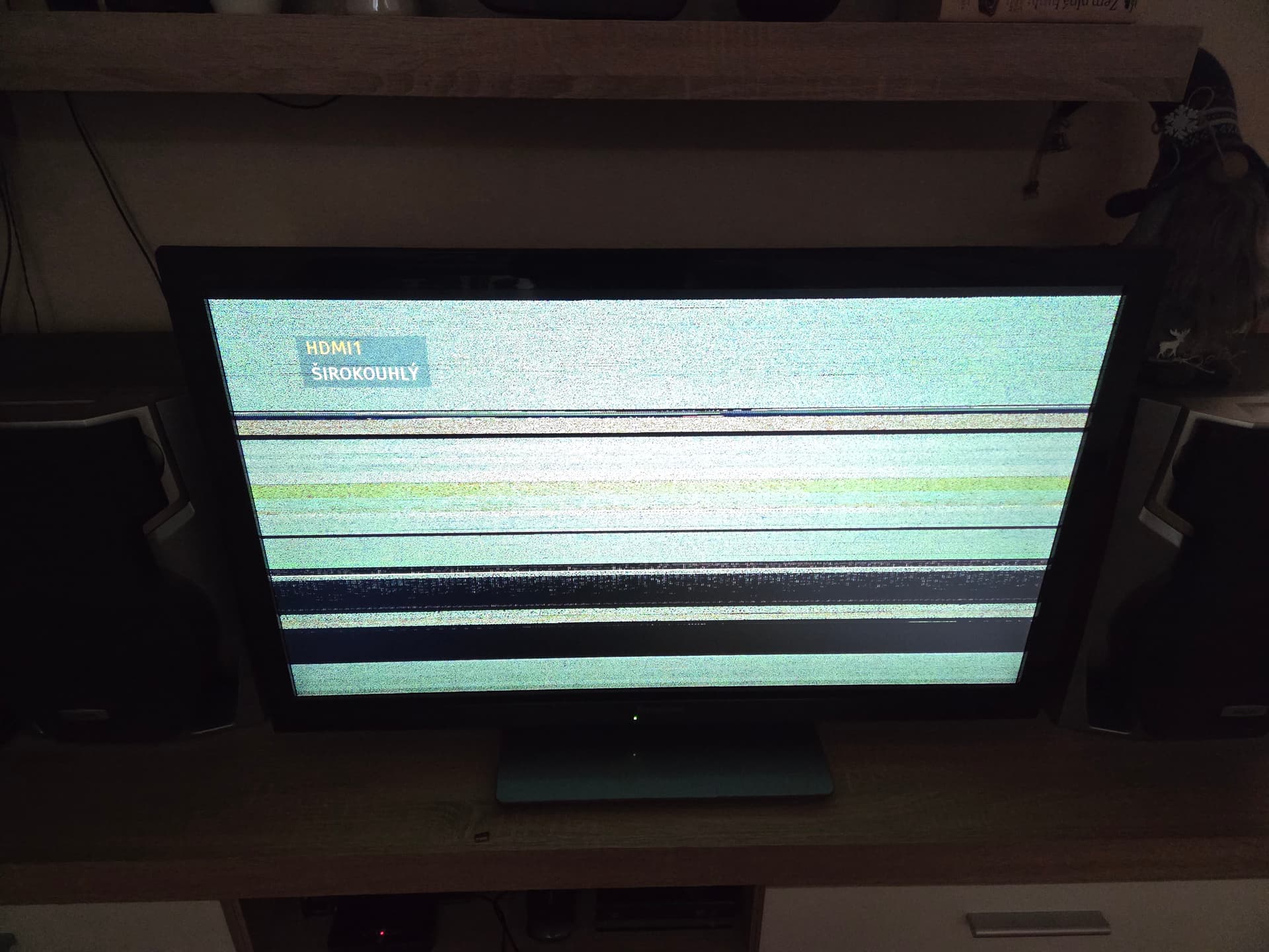

Thanks, I tried the CE 22 NO Build on a USB3 Stick. I got same Picture as Croco and I did the second dovi.ko in the root of my stick. So now I got no error message about not compatible DV kernel module. But is it right, that CE 22 NO do no Dolby Vision Playback on my Ugoos AM6B Plus?
I was thinking, I only lost the DV FEL but so I lost all DV.

Wireless does not work on software dated 05-08-2025. Recognises wireless networks but no connection
