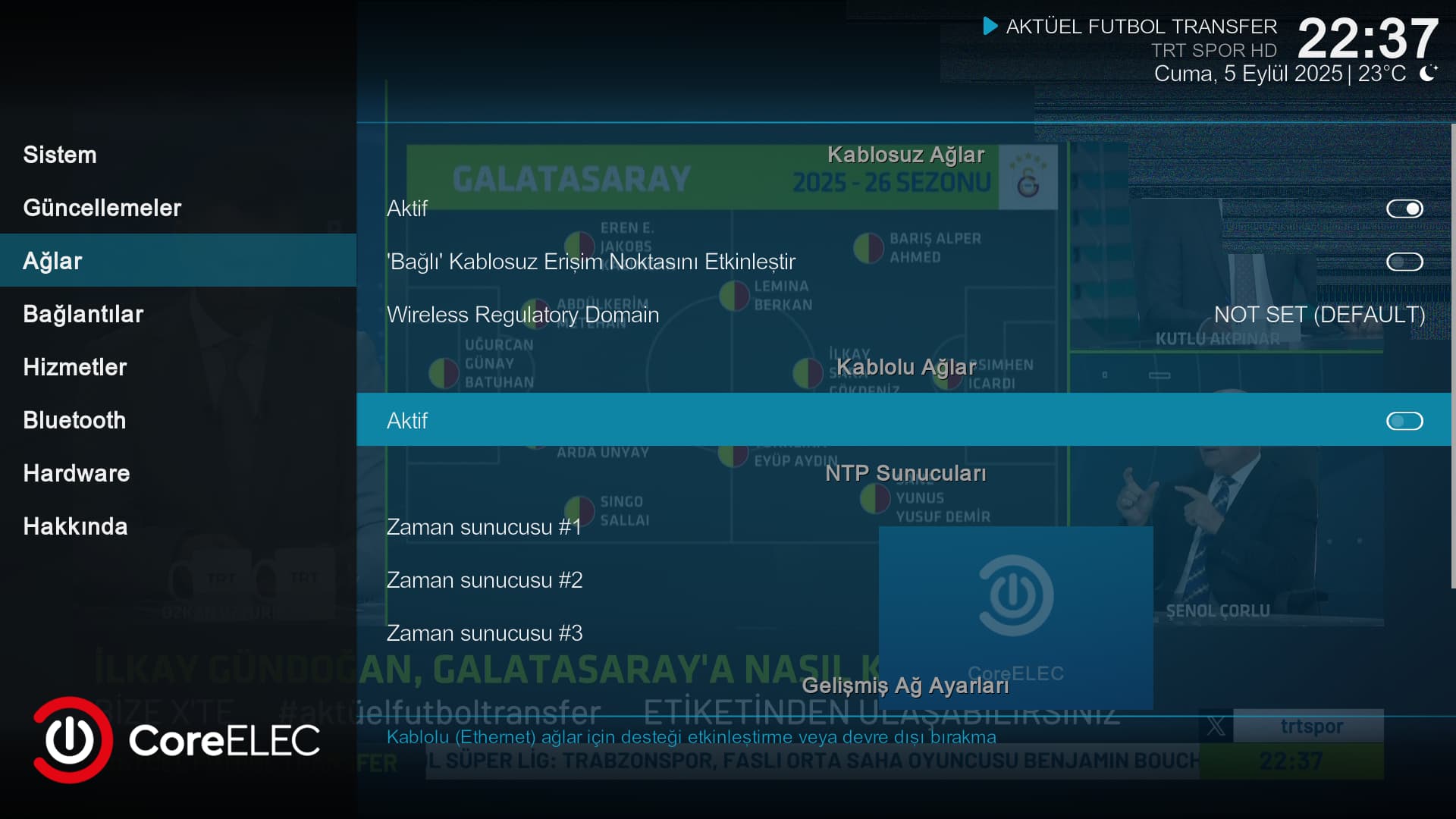

X95 M200 ethernet with the latest CE NO is not working.
dmesg
https://paste.coreelec.org/CharadePearls
Wired networks menu not activated.
@crazyturk please try with this test image:
This one works for NO
doesn’t work
dmesg
https://paste.coreelec.org/WithinCowards
@crazyturk
Try this image.
Thanks @smp, wired network worked
Does it work also now with newest nightly?
dmesg please
I did a clean install but again it does not work with the latest night.
2025-09-06 dmesg
https://paste.coreelec.org/UnlockDisgusts
@smp is working with the devel version he gave.
dmesg
https://paste.coreelec.org/QuincyCells
Ok, found the reason. It should work with tomorrow nightly again normal.
