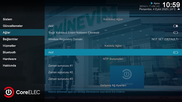

On the Linux 5.15.170 build dated 04-09-2025, the wired network is not working on the X96 M200 device.

And log is where? Ethernet works fine on X96 M300.
You can try this dtb?
s7d_s905x5m_4g_1gbit.dtb (76.4 KB)
If not, connect by WiFi and put the device online with tmate please.

Aarrh, sorry I normally always add the device, apologies . Tox3 s905x4.
Gone back to prev build all ok now. (eth/wifi)
Looks like crazyturk has the same No ethernet issues.
Edit: just saw your reply to him, thx.

“s7d_s905x5m_4g_1gbit.dtb” has been tested and the wired network is not working.
Please make a dmesg | paste also from last working NO nightly, I think 20250903.
I’m sorry, I will send it again
I changed the link I sent in the previous message.
