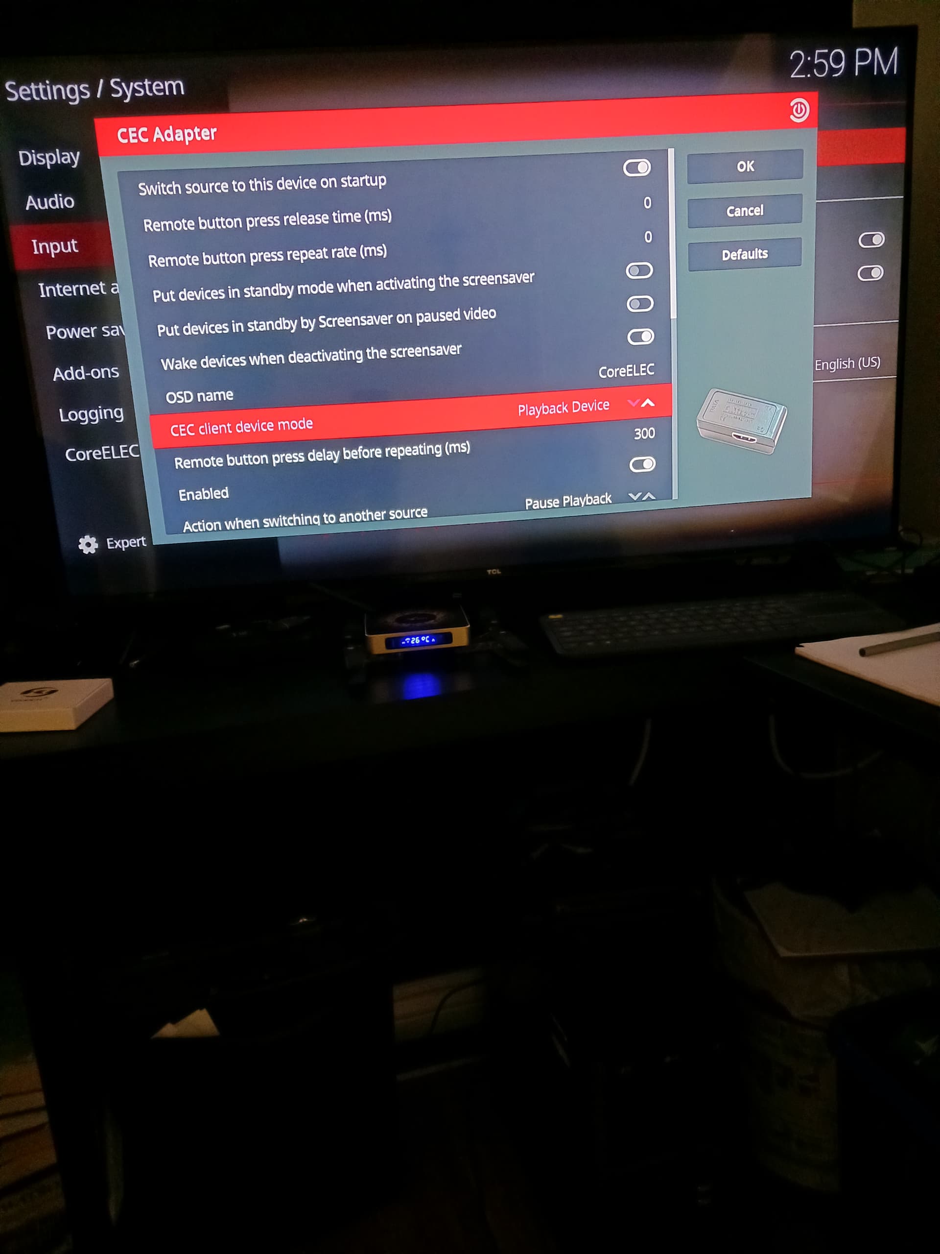

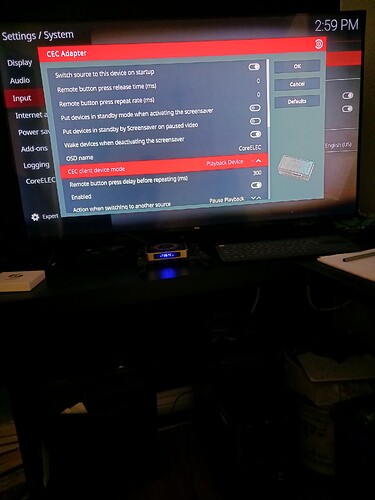

I have small trouble only at CE22NO (at CE21NG is ok with setting) with CEC remote from TV Panasonic. If i change input from CE to TV and back (only if i was set of recording device in CEC setting - compare to CE21NG where is succes set as recording device as playback device) so CEC remote is ok. But if i change back input from tv to CE after 20 minutes - device is in small dimmed mode, after then CEC remote is not going compare to CE21NG and it need pusching button from original ugoos remote and only after then is going CEC remote. I thing thaht is something to setting of “dimming mode” - it need add remote cec to always active. And also is question that why CE22NO need CEC remote in “recording device” if is going also as playback device in CE21NG. Maybe it help also to solution.
For the screen to dim ,is common with CeC,same in my setup, You can change CeC client device mode in settings ,Playback, Recording, or Tuner,
And yes ,you have to hit a button on TV remote/Box remote to wake from dim screen, My TCL TV goes completely black screen, change input or hit any key and wakes up/undims/blackscreen disappear

It is not matter, if is select playback or records. In firsts releases of CE2NO was selecting records as only think solution. Now i was succes also with payback, but issue is dimming mode which need wakeup remote with original remote in CE22NO. In CE21ng is ok. In case that solution is not in hand of coreeelec team, after then maybe help turn off of saving mode of viera link of panasonic for playback/recording device.

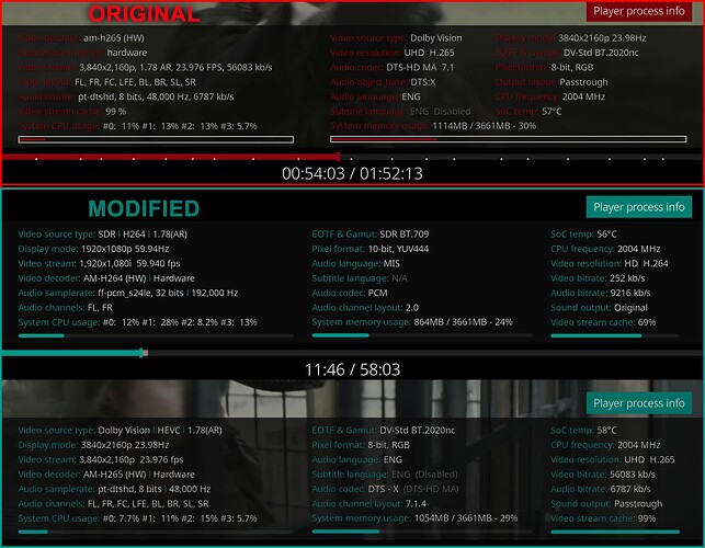

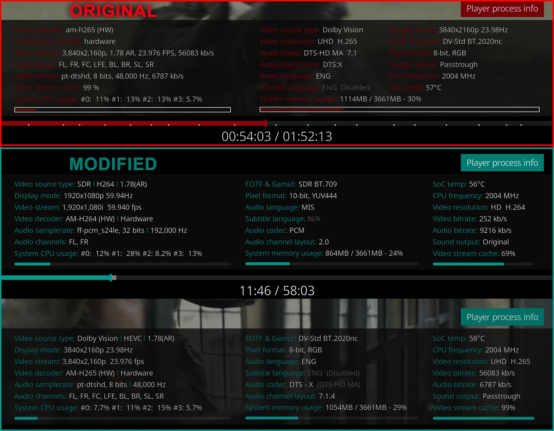

For testers, who testing the CE-NO alpha, here is my modified estuary .
Just the playerprocessinfo changed, in my own taste. Install from zip, choose estuary.CE skin.
download

The problem: it was always “default” Input is left, output is right side.
With this version it’s all mixed together.

I just made a little change for the font to make it clearer and more readable.
